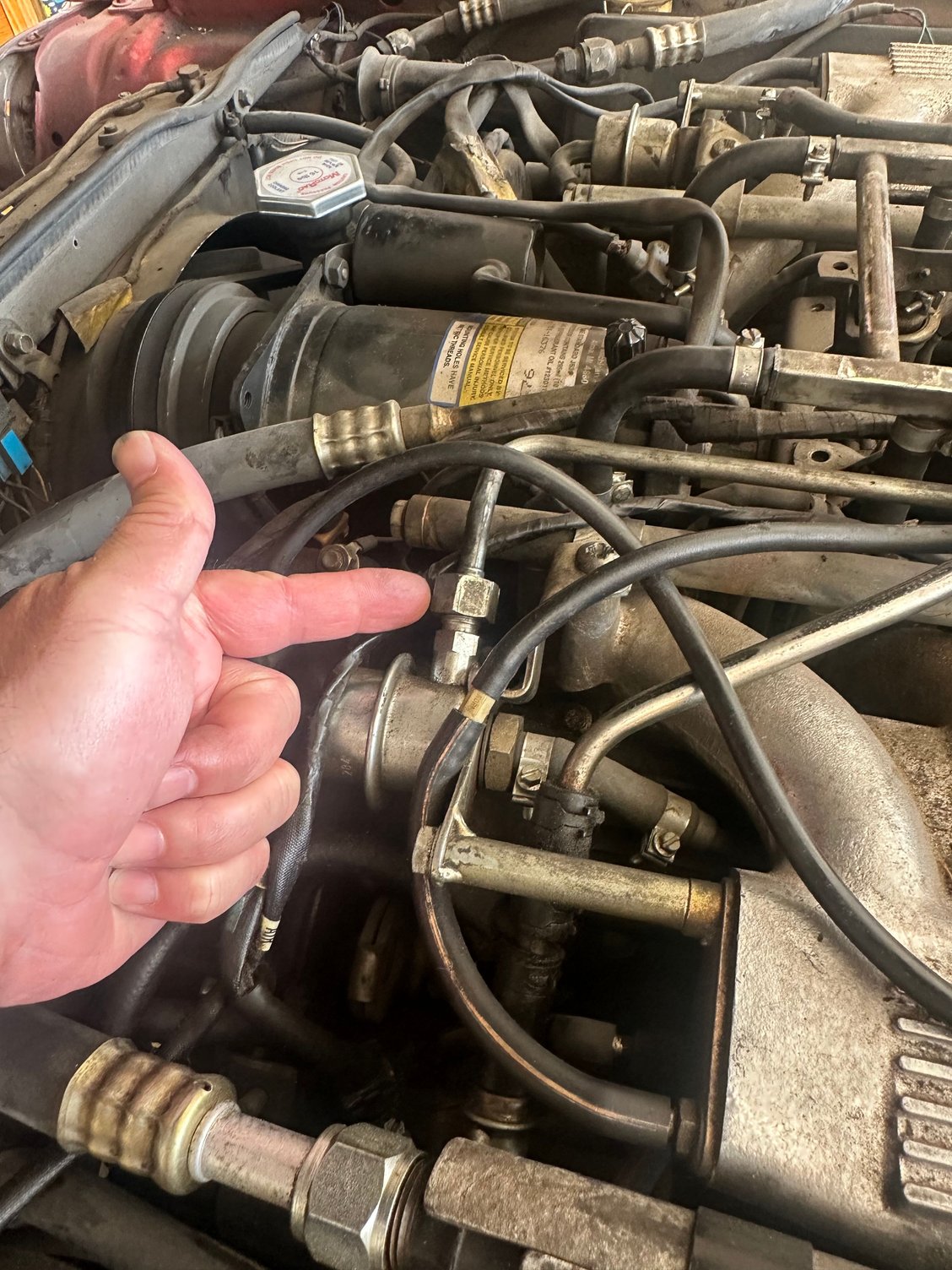

Not gunna lie this thing is intimidating at first meet! What’s the deal with the vacuum tech?

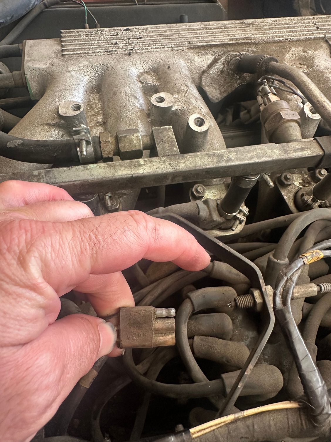

This clip was sitting on lock not sure what for and the broken electrical wires on u bracket to right ?
This is where I had gas pumping out rapidly when I took steel line off and let fuel drain to glass jar.

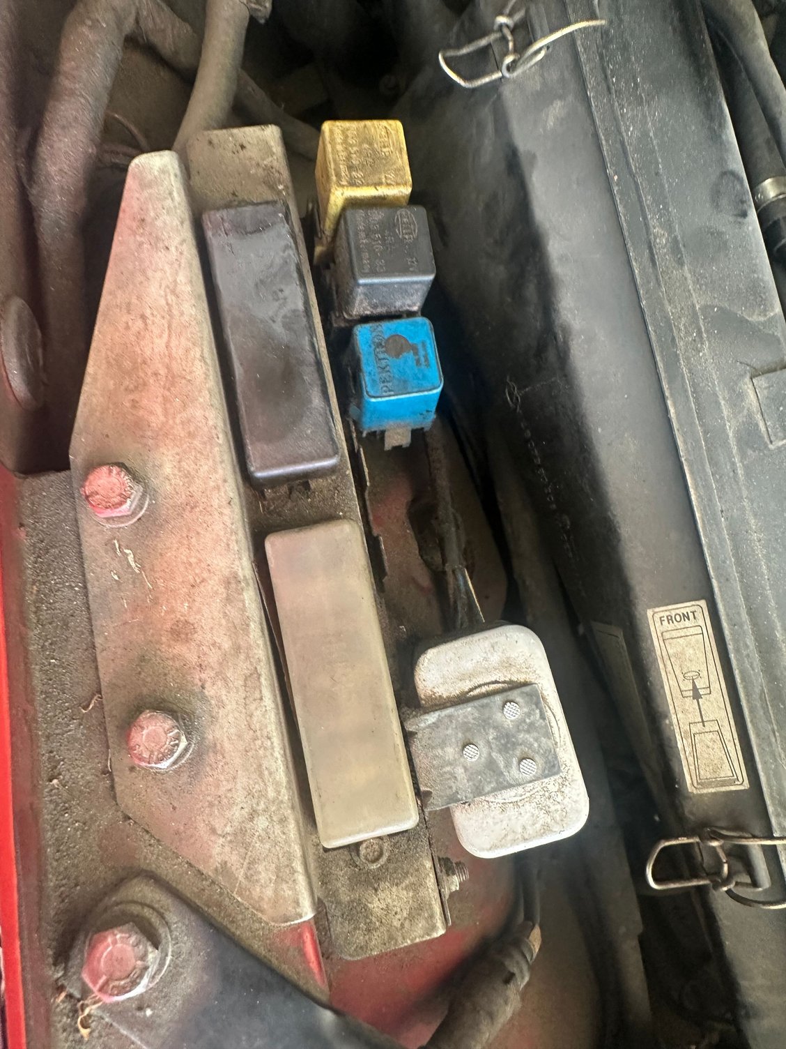

Not sure what these relays are for? I looked in books shared but can’t figure this yet…?

Gauges not working, could be anything, but NOT relays that I know of, BUT, your market has some seriously weird stuff compared to our "simple" cars.
