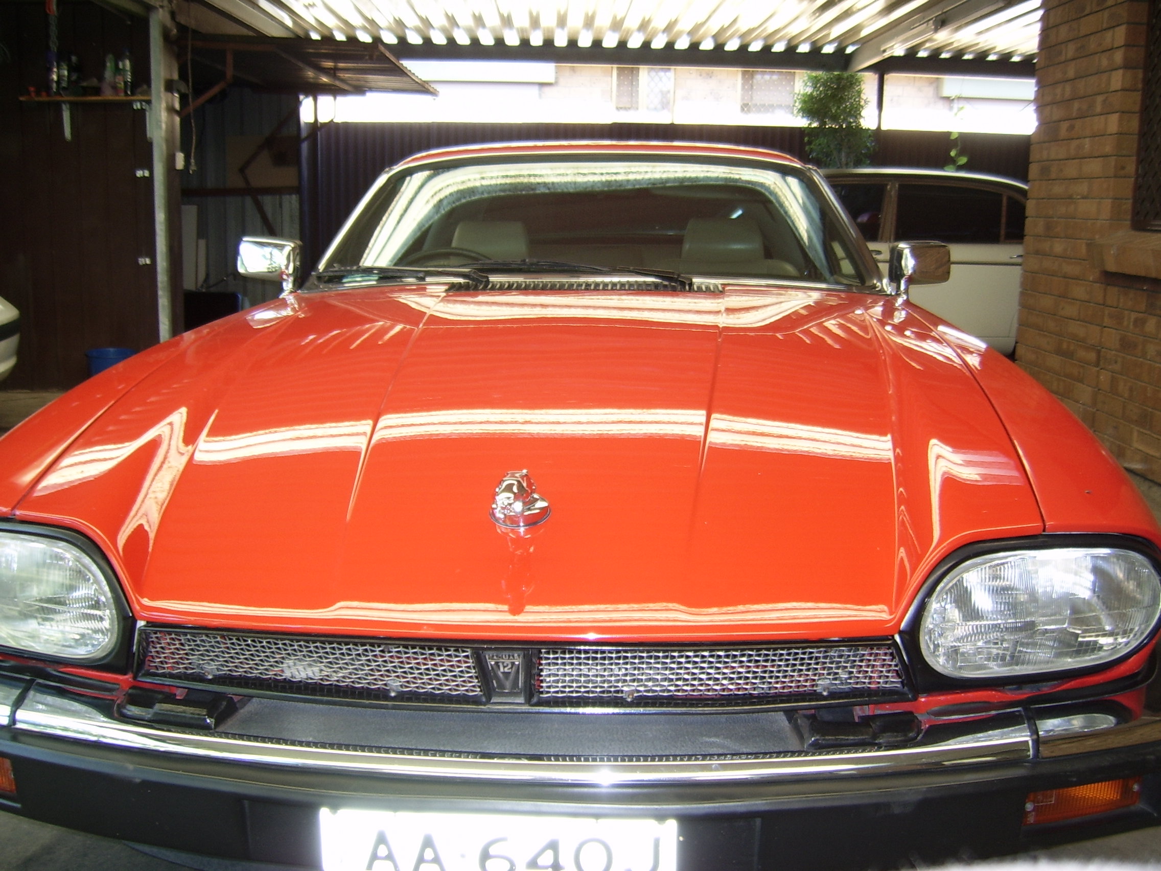

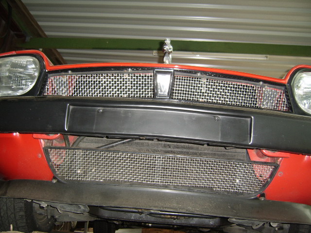

You want me to remember 1995, that will be interesting.
From that same memory.
I went to the hardware store, and found some small 90deg brackets with a hole in each face, and they were stainless. Shower cubicle area I think??, so I grabbed a dozen.
Then kept wandering and found some suitable sized "Socket Cap" setscrews, and nyloc nuts, again stainless.
I ended up by cutting the mesh to what I wanted, and that was JUST smaller than the opening, and then used the said brackets and capscrews and secured the brackets to the plastic outer surround, from the backside, and then attached the mesh to the other "face" of the brackets. This was the HUGE time consuming bit, as I first tried rolling the outer edge of a larger cut mesh so it sort of "clipped over" the backside of the surround, NBG. The mesh I got was too heavy a gauge for that.
There was no plan as such, the grille was a mess as I stated, and I had TIME on my side, so just did it on the fly mostly. Some of the early cuts were just plain weird, and then I sort of fell over the final theme.
The lower was just cut and screwed to the vertical braces of the old dumb excuse for a grille. It has a few gaps if you ever get that close, but the Beast will bite ya, trust me, and the angle of that grille makes the small flaws undetectable.
If something more returns from the "fuzz", I will update this post.
Cheers Grant

Red XJS with mesh grille = Grant! Thanks for all the info, Sir. Forcedair1, I agree on closer inspection that the aftermarket grille doesn't look as good as the ones you guys made. Sounds like they would sell if made into a kit!

The mesh material for my XJS grille actually came from Mina, as in the Mina Gallery. I visited them in the San Fernando Valley (CA) and a visual inspection of the one they advertise for the XJS looked a bit like a piece that you snap on/snap off and did not convince me, but most of all because, by then, I was already more sold on the heavier mesh material that Jaguar was beginning to use on their supercharged cars and which Mina was using for aftermarket Range Rover grilles; that was exactly what I wanted, so they cut me a piece enough to cover both, upper and lower grilles. I would imagine that they still work with that kind of mesh material.

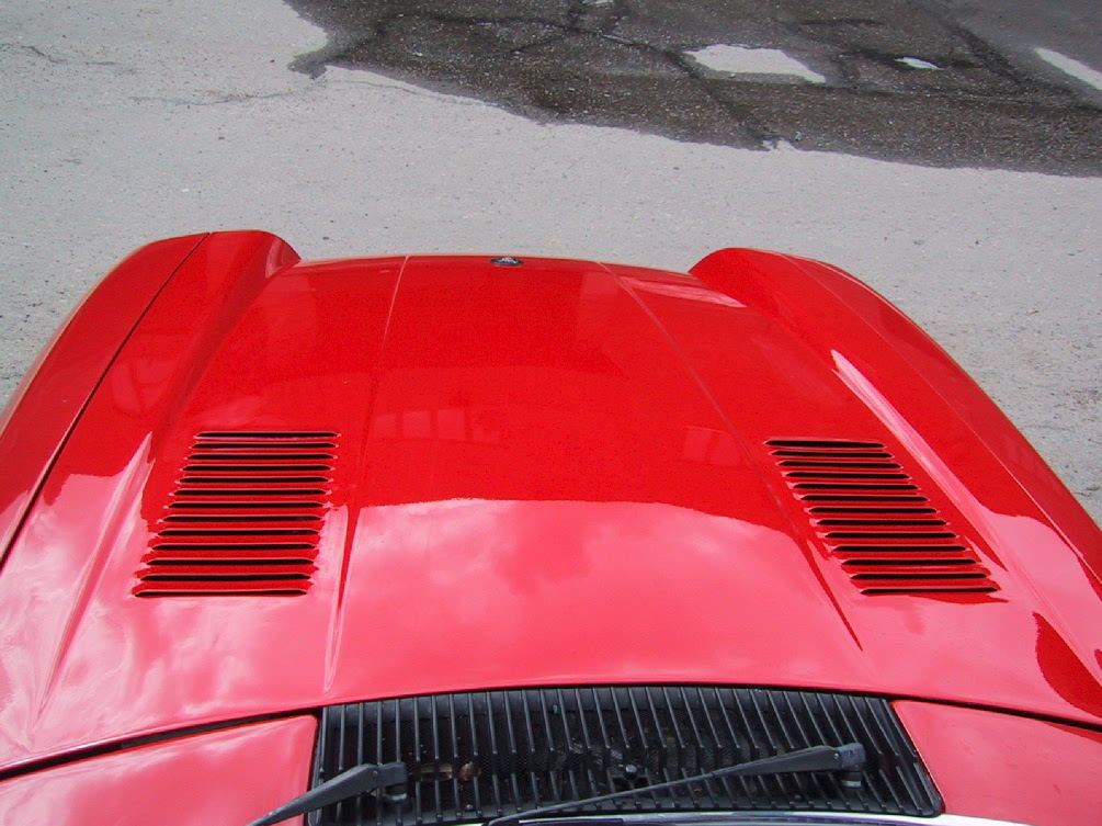

getting the air out something like these!! pix,
done around 10yrs ago!
SWEET.
Finding someone to that these days is getting hard. Like an honest used car salseman.
