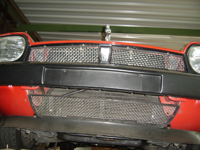

Made my own, $ tight **** that I am, plus, I simply did not like the look of what I found way back then.
Retro fitting a mesh grill/upgrading your OEM grille-xjs-mesh-grille-2.jpg
Only problem is you MUST have the BIG leaper to make it a REAL Jag. No leaper, no mesh, simple.
Found a mob here that sold "Woven wire" by the metre, and had Stainless to boot, so i got 1.5 metres. Did the XJ-S, daughters XJ40, and my X300 (which was behind the "standard" grille) to stop teh bug invasion of the radiator.
Time is needed, and Bandaids by the box, and an imagination, plus the obvious Necta.
XJ-S took about 2 hours, as it is a mongrel "double curve" grille, and plastic which needs care.

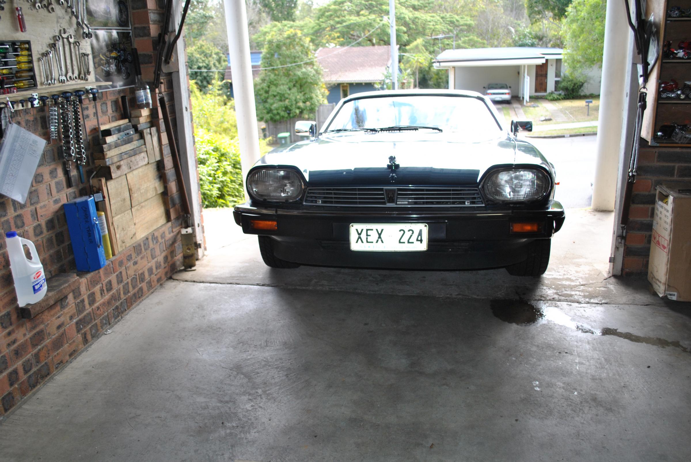

Can't remember but I didn't think mine had the grill underneath the bumper. Grant did you have to cut the bumper to do this or was there already a grille? (Was the bottom bumper grill standard on all earlier XJS?)
Have a close look at this pic Paul, you have the lower grill.
And the Leaper
Retro fitting a mesh grill/upgrading your OEM grille-dsc_0203.jpg

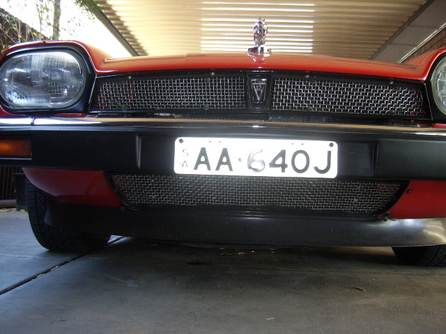

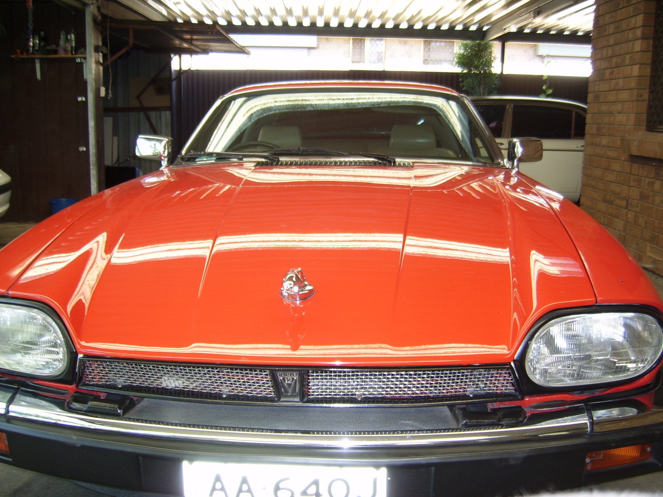

Airflow, no idea, never ever gave it any thought. The XJ-S has plenty of air IN, its the exit air that causes the biggest issues.
There is a lower grille af sorts, as Clarke said, and I removed the horizontal bars, and maintained the outer rim, and the vertical stays, and simply screwed the mesh into place.
NO cutting of anything in regard to the bumper bar.
The only thing missing is the centre plastic section of the flimsy rubbish that covers the bonnet hinges. Mine was all buckled and cracked in the middle, and the $ Jaguar wanted for one was stupid, so I cut it out, and maintained the end bits to cover the hinge pins.
The snap shows what words cannot, and that panel is simple aluminium sheet from the hardware store, and I painted it Black after that snap was taken. It slides in under the rubber facing, and a dob of RTV on the underside holds it in place.
Retro fitting a mesh grill/upgrading your OEM grille-xjs-leaper.jpg
Retro fitting a mesh grill/upgrading your OEM grille-grilles-pc.jpg
This 2nd snap is what a pedestrian sees just before the smack on the head.
