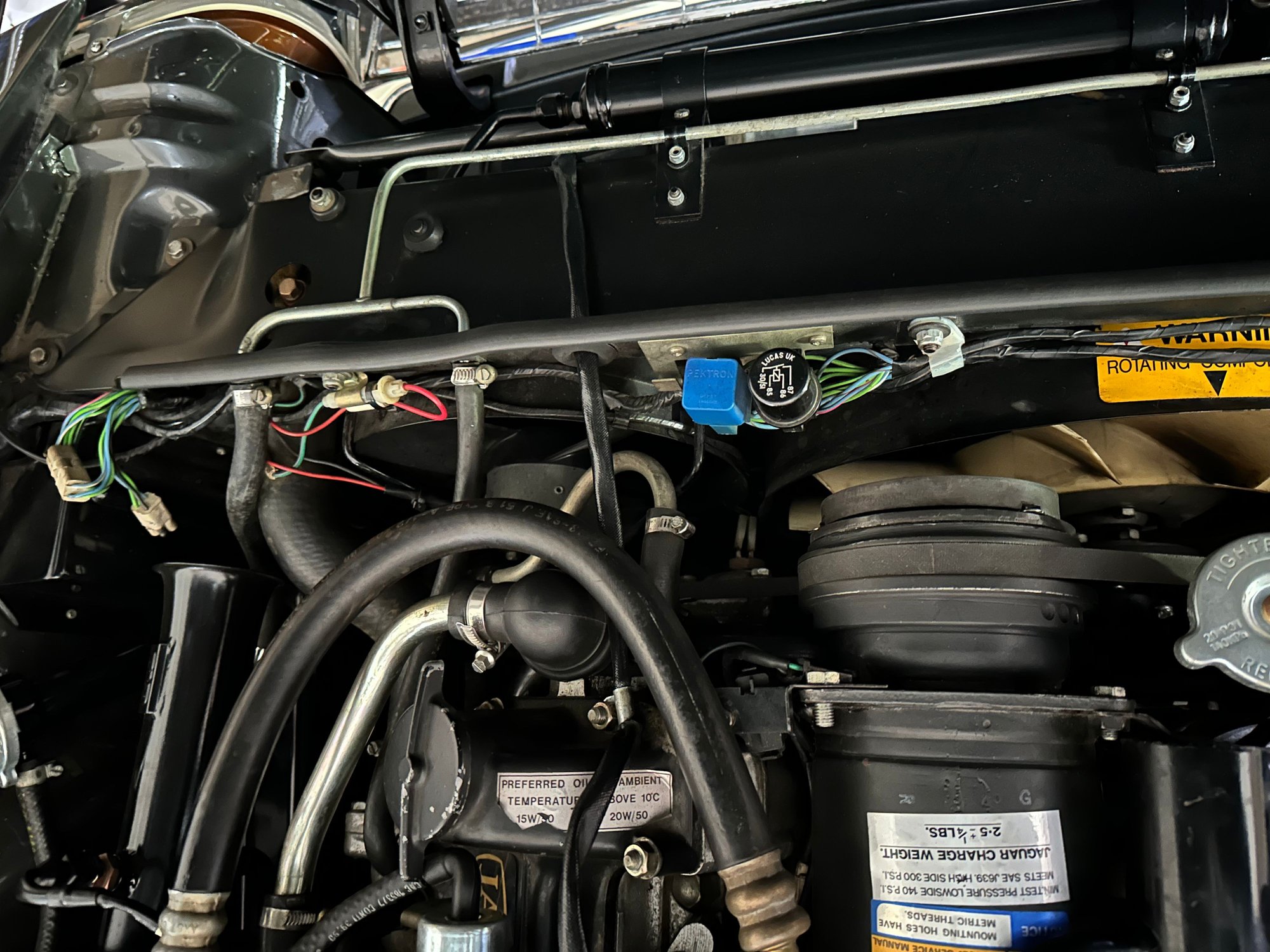

If some could take a picture of factory heated sensor wiring, Id appreciate it.
i assume they are powered by one of the relays on the rad support.
my rad support.
