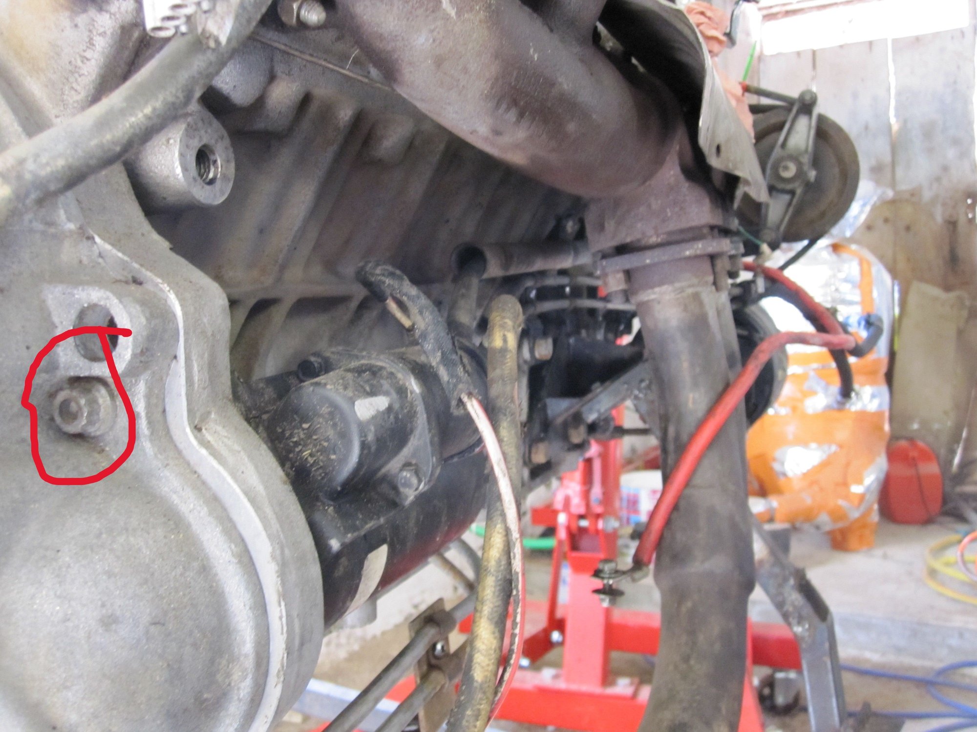

Do you have to drop the rack in order to withdraw the starter motor from the flywheel, because otherwise it is blocked in longways?
Second, RJ, remember that the top securing bolt of the starter motor needs an 12 point 7/16ths socket or you willl ruin the fixing AND your week!
See attached photo:

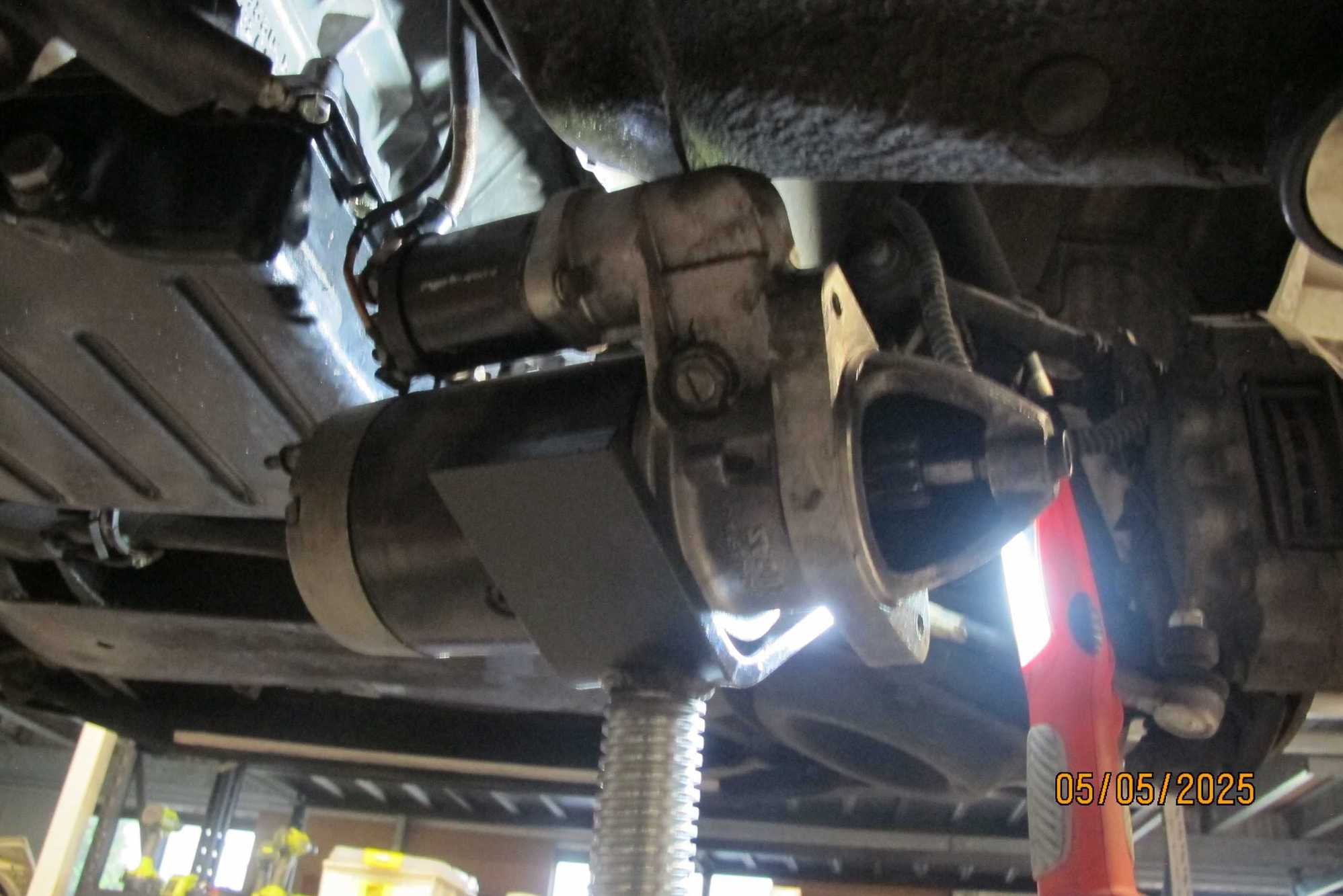

I got the starter motor out.
I found the nut on the battery cable to the solenoid was not very tight and that could cause the symptoms of poor cranking power and running on after the start relay turned off.
So I suspect the starter motor and solenoid are probably O.K. I did overhaul them thoroughly about 30 odd years ago and the car is usually driven no more than 12 times a year.
Of course it is impossible to get at that nut unless you go to a lot of trouble removing all the things you usually need to for a complete removal.

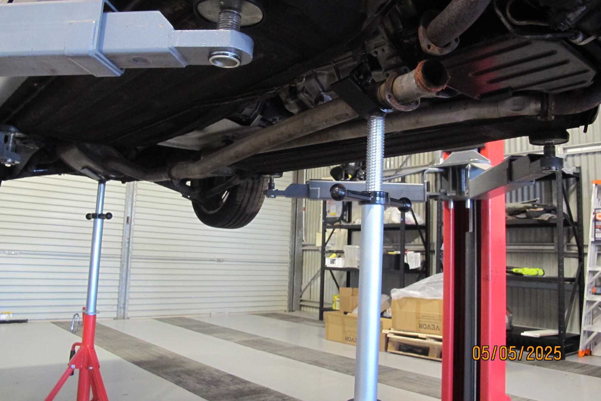

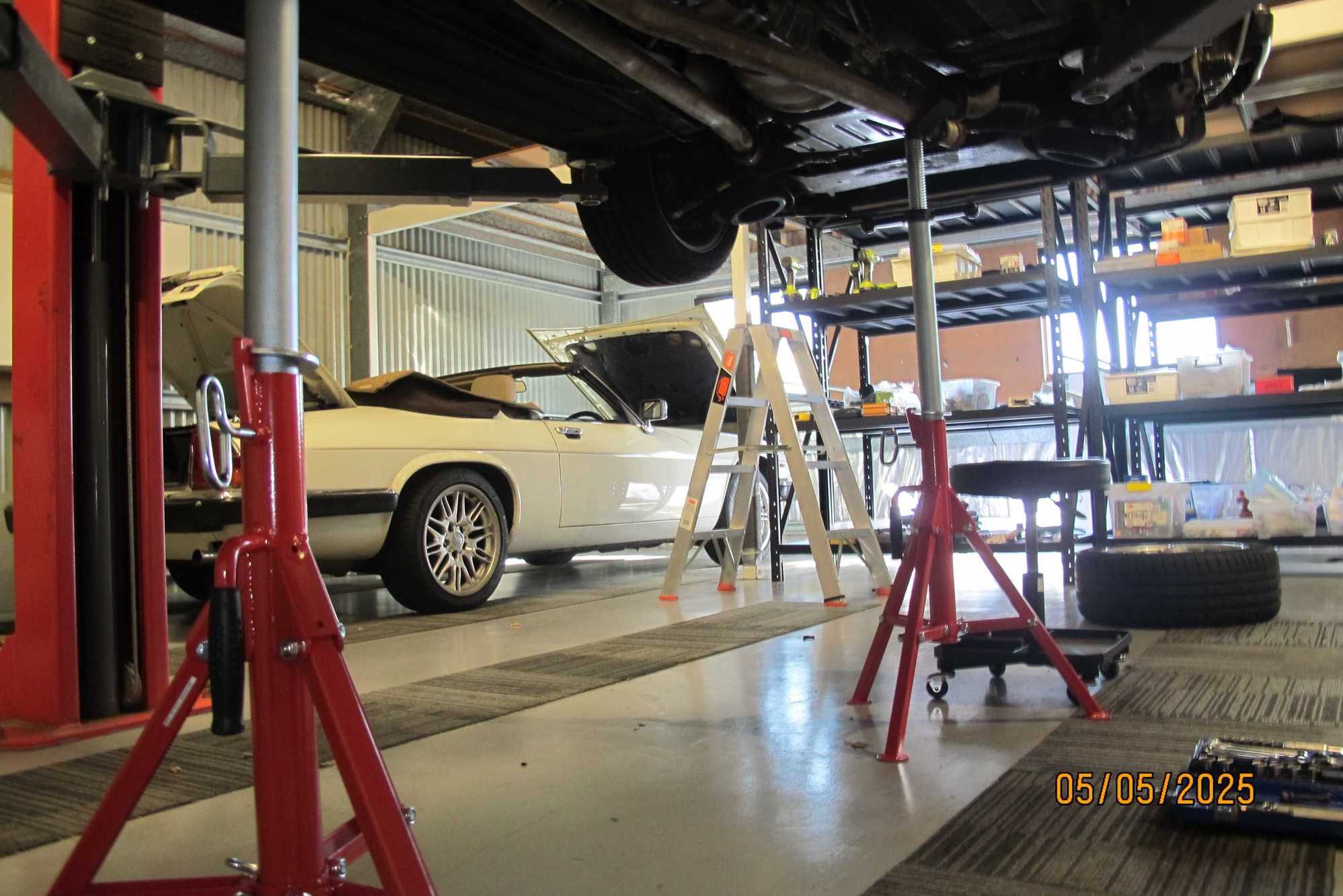

To make life easy I bought a couple of adjustable stands to handle the heavy exhaust system, the rack and the starter motor itself.
Took a while to find them but eventually turned up these at US$160 the pair including freight. Well worth it if you have a hoist.
I have a set of new bushes for the convertible and the stands will make rack removal and replacement easier.

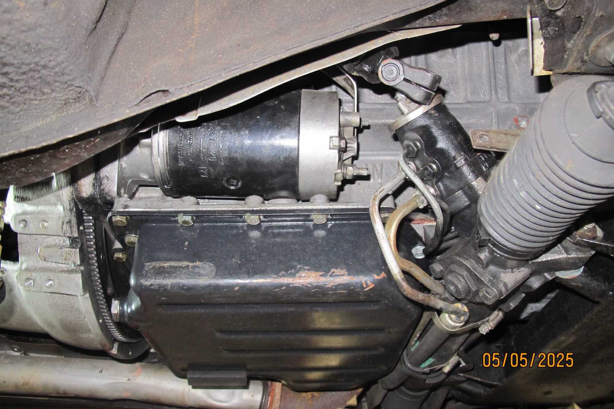

I did not need to drop the rack to get the starter motor out. See the photos.
The bell housing is for manual box. It does not need the special 12 point bolt, just a standard hex head bolt.
I had to release the rack U/V joint and remove the starter heatshield plus the little bracket heatshield to solenoid.
Then I could just manage to cajole the starter motor out onto the stand. There was enough slack in the battery cable to do this.
Then I noticed the nut holding that cable to the solenoid was not real tight.

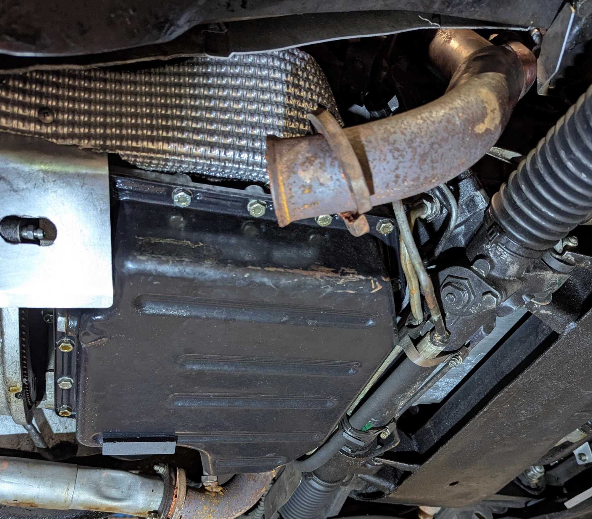

I bought a Titan brand geared starter, which is basically a Chinese product.
The company selling it is in Brisbane and they cast and machine the nose themselves to fit the bell housing of a variety of classic cars, including the 5.3L V12.
Fits perfectly into the Dellows bell housing for a manual box.
I bought a sheet of aluminium heatshield material which is stamped/formed in such a way you can bend it into virtually any shape.
Heatshield around new geared starter

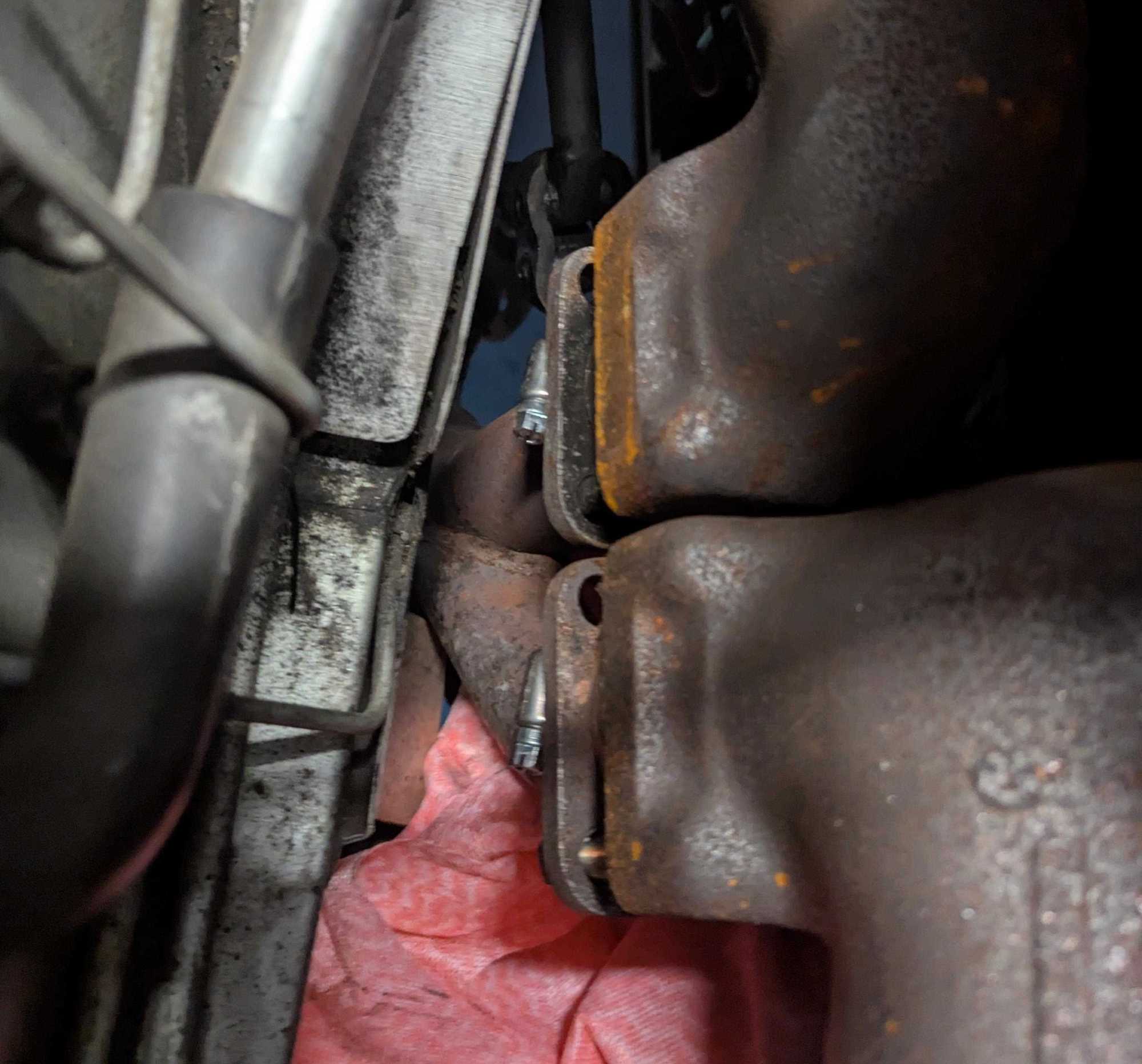

Not sure if this idea popped up before. I have owned this 79 coupe since 1984, 41 years of ownership.
I know I had to refit the downpipes at least twice before and it is always awkward to get the flanges up the pipe and on to the studs.
This time I used a couple of 2" hose clamps mounted just under the flanges to keep them in place while I wrestled with getting everything lined up.
Made things much easier, just make sure the screw head of the hose clamp is not near where you need put a spanner on the stud nuts.
Hose clamps holding the flanges in place.
