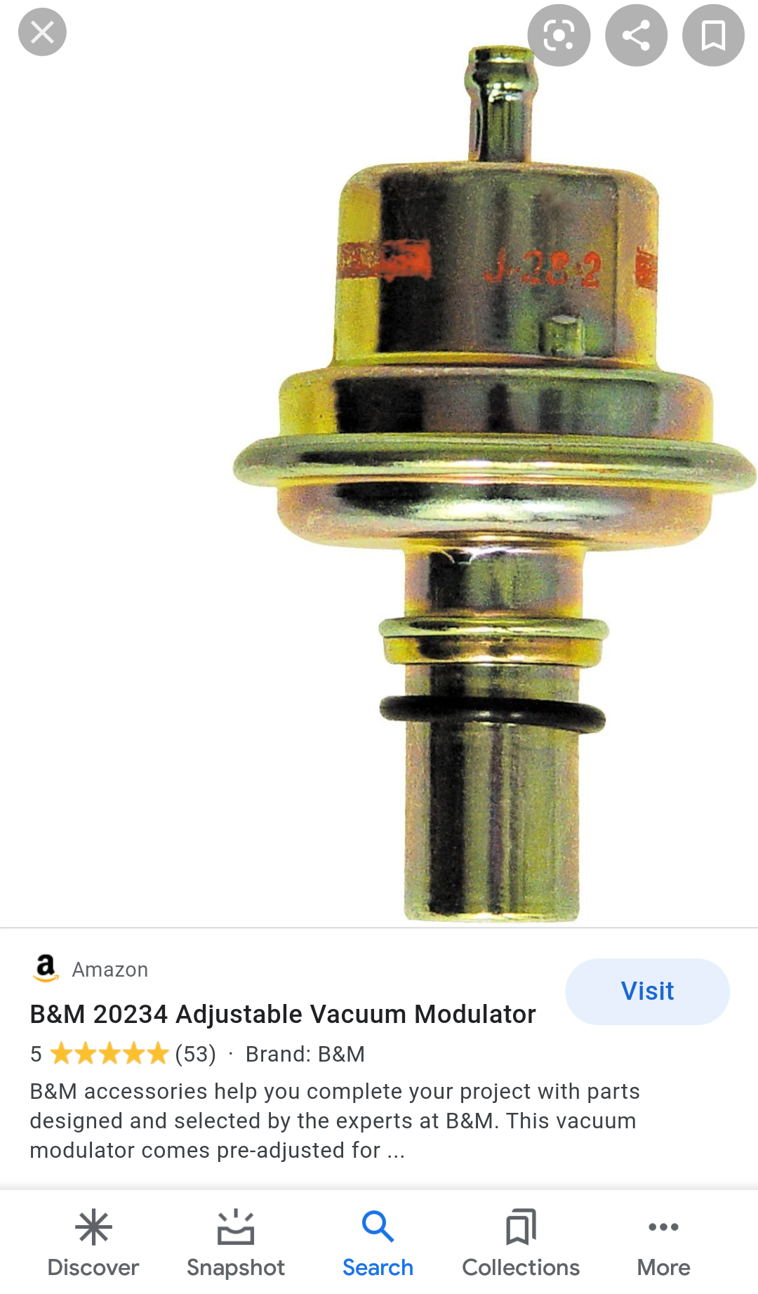

I definitely plan a filter and fluid change just for maintenance sake. I have come upon some new information that may well explain my issue and potentially some other issues as well. There is a four prong vacuum port on the back of the right side intake manifold. Two of those ports were just empty. The little sticker tells me one should be capped so I capped one, and the other should go straight back to the transmission - that line is completely missing. The other two ports go to solenoids or to the inside, probably for the ac control. The vacuum system on this side is a mess, there are 3 solenoids over there that i will probably have to make a separate post about that either have all their lines missing or some of them missing. Anywho - would that transmission vacuum line being missing cause a loss of reverse?

Nope it wouldn't - reverse is done entirely using oil pressure via the third gear drum, it is either the reverse band itself or the servo that supplies it - do you have 3rd gear ?
I am very interested to hear what others have to say but I would think sadly not. Not for reverse... That missing vacuum line goes to a ----- oh shoot I am for getting the name (had to Google it) a vacuum modulator/actuator of sorts that controls shifting in forward gears... Going from 2 to third gear,,, holding second for longer or shorter duration depending on the amount of vac in the intake...and such.
Mine was shot. Worse, for the PO, the line flopping around down there caught fire and the fire climbed the hose and ended up doing damage in that entire corner of the engine bay.
