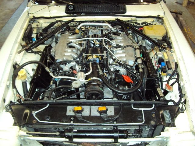

Cleaned out the Vee (what an oily mess it was), New plugs (old ones were correct NGK and looked pretty good actually, but were gapped at .040 versus .025), HT leads (old ones had some cracked boots), did Palmer's dizzy shaft nub and silicone squirt.; new cap and rotor of course. Replaced cam cover seals (it already had the Gortex type, which I thought came about later from Ford (mine's a 90), so maybe they were replaced yet the Vee wasn't cleaned? Eliminated the Smog pump and pipes. Bought a 140amp CS130 alternator and moved it up to the smog pump location. Removed the radiator to have it rodded, but was delighted to discover its been replaced or re-cored; had shop add a drain **** though. Made some simple water filters/screens out of SS kitchen strainer mesh, and formed them into the upper inlets (temporary). Expansion tank appears to be newer also (in very nice condition). New hoses, including heater valve outlet feed hose (what a pain). Installed a custom made dual electric fan set up. (Removed from a 92 coupe I just bought...more on this new car later). Fixed some broken electrical connectors, installed newer injector harness that came on the parts car (yeah), and cleaned up and re-wrapped a bunch of wiring. Haven't driven her yet...but already I can tell she runs sooo smooth now. No more shaking at idle...I think I'll try the "Nickel Test".
All pretty now

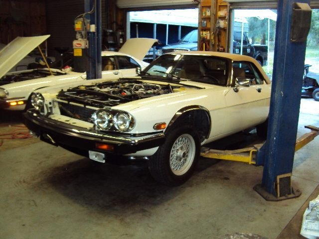

Wouldn't work on hobby cars without a lift (Sharp eyes will see the latest acquisition a Facelift V12 Coupe. It's too nice to be a parts car but I did take the custom dual electric fan unit off it. BTW they only made 1199 Facelift 5.3L cars...wow; more on it later)
Lifting front end allows for easily bleeding coolant air bubbles.
Sacrificial parts car (good engine), rusty body, only 2 months older than Convert so same componentry. Got this for the rear hubs (hubs on Covert cracked...very wierd) but it has yielded many good parts. Was only $700 USD worth every penny.
