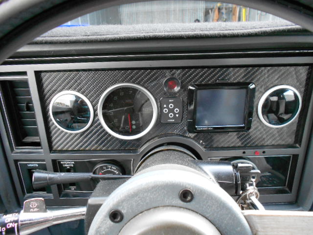

my Buick GN, with LS2 conversion, uses a standalone GPS speedo,works great very accurate, has auto speed zone notification, and red light note!
plus other electronic gauges, RPM is digital(might not be everyones likes).
but all work fine, and automatic notes can be turned off when needed!
course this is 10yrs ago, and all these new electronic dash clusters have advanced!

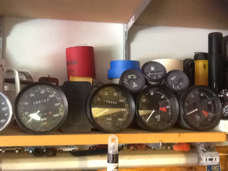

Been eyeballing this thread, there was a company back some 20 or so years ago that used to make a dash conversion for the XJS. Slips my mind right now who it was ( saw pics on jag-lovers many moons ago) I do have these sitting on my shelf if anyone (stateside) is interested, just pay for shipping and you can experiment away.
