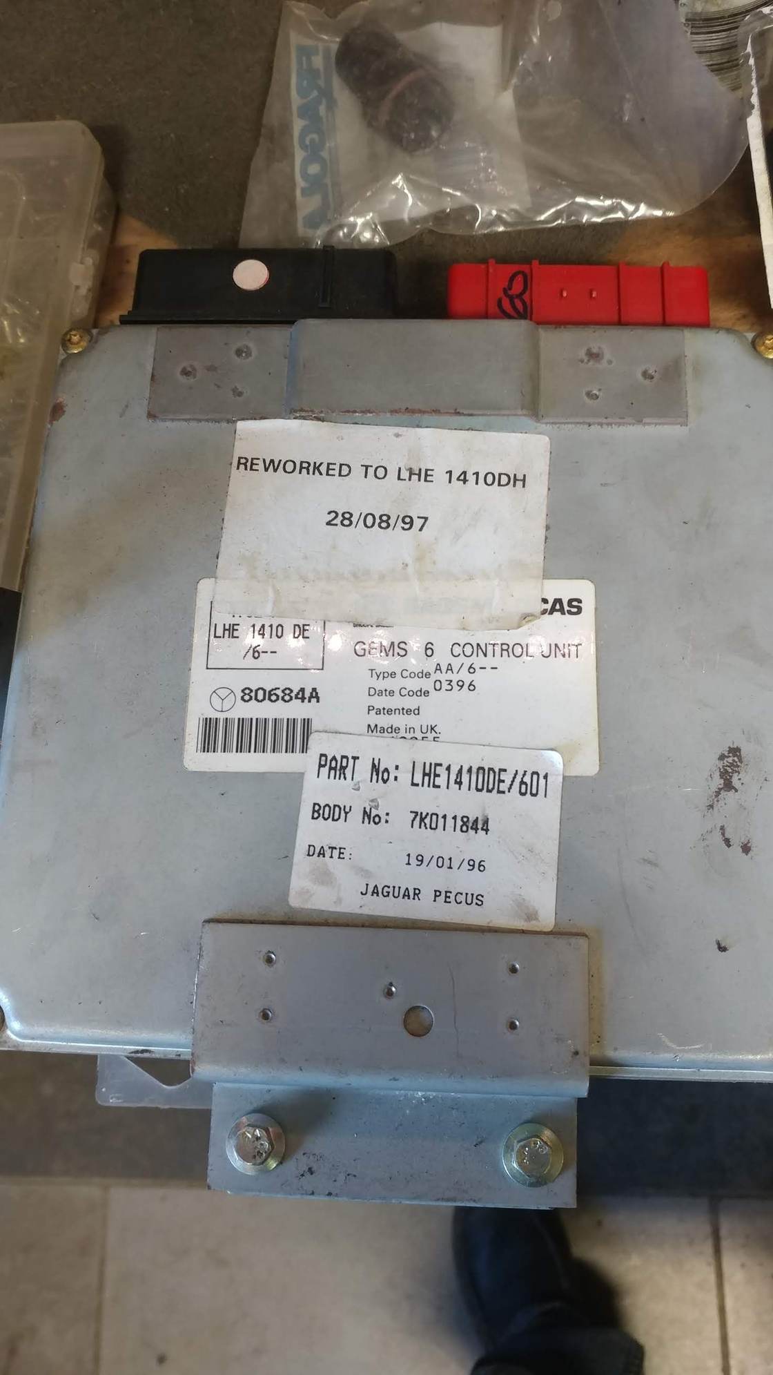

Old Dec 5, 2019 | 02:10 PM
icsamerica's Avatar
Posts: 2,291
Likes: 1,466
From: New York City
Originally Posted by DOUGGY
Hi icsamerica,
Can you send me a picture of the ECU with the order numbers on it ?
My WhatsApp is 0034 644 76 19 24
Thanks
I dont use whattsapp but here is a pcture of the ECU.
Old Dec 6, 2019 | 07:30 AM
Vee's Avatar
Vee
Posts: 5,355
Likes: 1,753
From: Arlington, VA
Not trying to dissuade you from purchasing this ECU, however, if you purchase this ECU, you will still have to reset the TPS using Jag specific software. Make sure your mechanic can perform this service, or you will not be able to resolve your issue.
