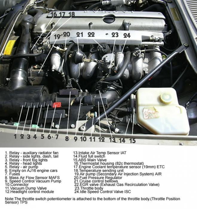

This may help you understand what you're looking at.
I really believe it's most likely a TPS, but here's a picture of your throttle body. If it looks as clean as this one, then you can probably cross it off the list. (Make sure you open the butterfly to make sure its clean inside too!
The TPS is the sensor with the three prongs on the bottom. That sensor figures out what position the butterfly is in. If it is failing, or out of adjustment, the engine will rev high, like yours. You should be able to loosen the two screws holding it in place, allowing you to adjust it. This only works if you can adjust it in place, not removed from the car, with the engine running. You might be able to adjust it yourself! Loosen those two screws just enough to allow you to force the sensor to move. It shouldn't be easy, but it shouldn't be hard either. If you are successful, you'll then tighten the screws, locking it in place. Again, this must be done with everything on the car, with the car running. You cannot do this with the throttle body out of the car.
These are the two screws I'm talking about. Loosen them just enough for you to move the TPS sensor, but not loose enough that the sensor can move around on it's own.

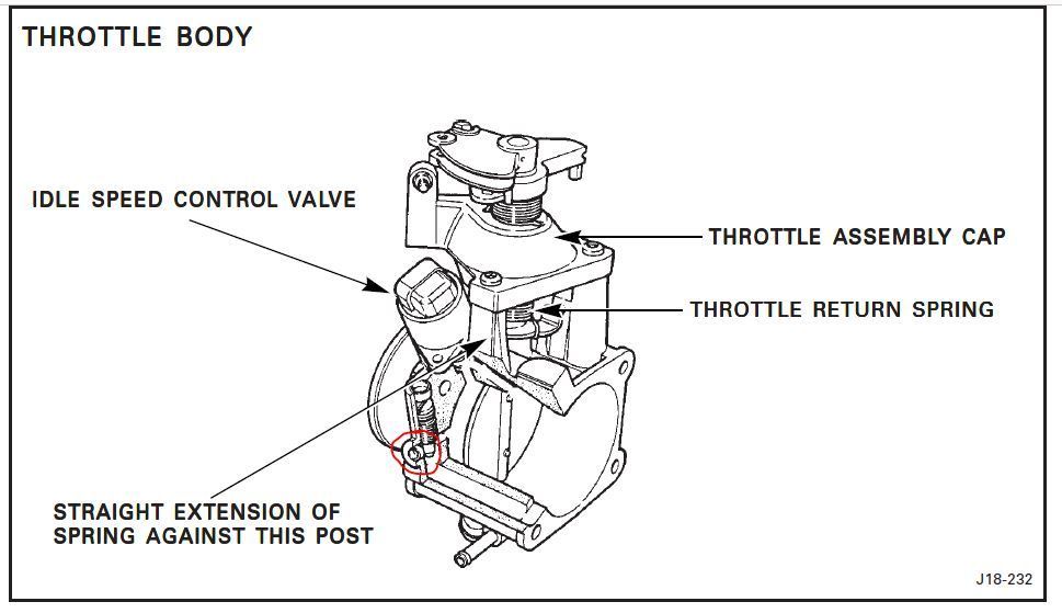

A couple of things came to mind; there is supposed to be a little fine adjust screw on the housing, on the left of the butterfly(throttle plate). It is supposed to have a seal of potting compound but sometimes you will find it missing and possibly may have been adjusted before or has loosened up and backed out by vibration causing a very low idle and or the throttle plate can stick in the idle/closed position causing a sticky transition to open throttle. I found mine backed out, that's how I know. The other thing that came to mind is the EGR. If the EGR valve poppet does not close fully in the idle position, and stays open or had crud on the seat and never fully closes, you will get an artificer idle, sometime even stalling as there should not be recirculated gas (EGR) at low idle. See attached TSB that talks about it and shows the operation. 1. It should not be commanded open at idle. 2. The commands by the ECU may be correct but if the poppet is held open by a dirty seat, it won't close and seal properly at idle.
Just some things to check
