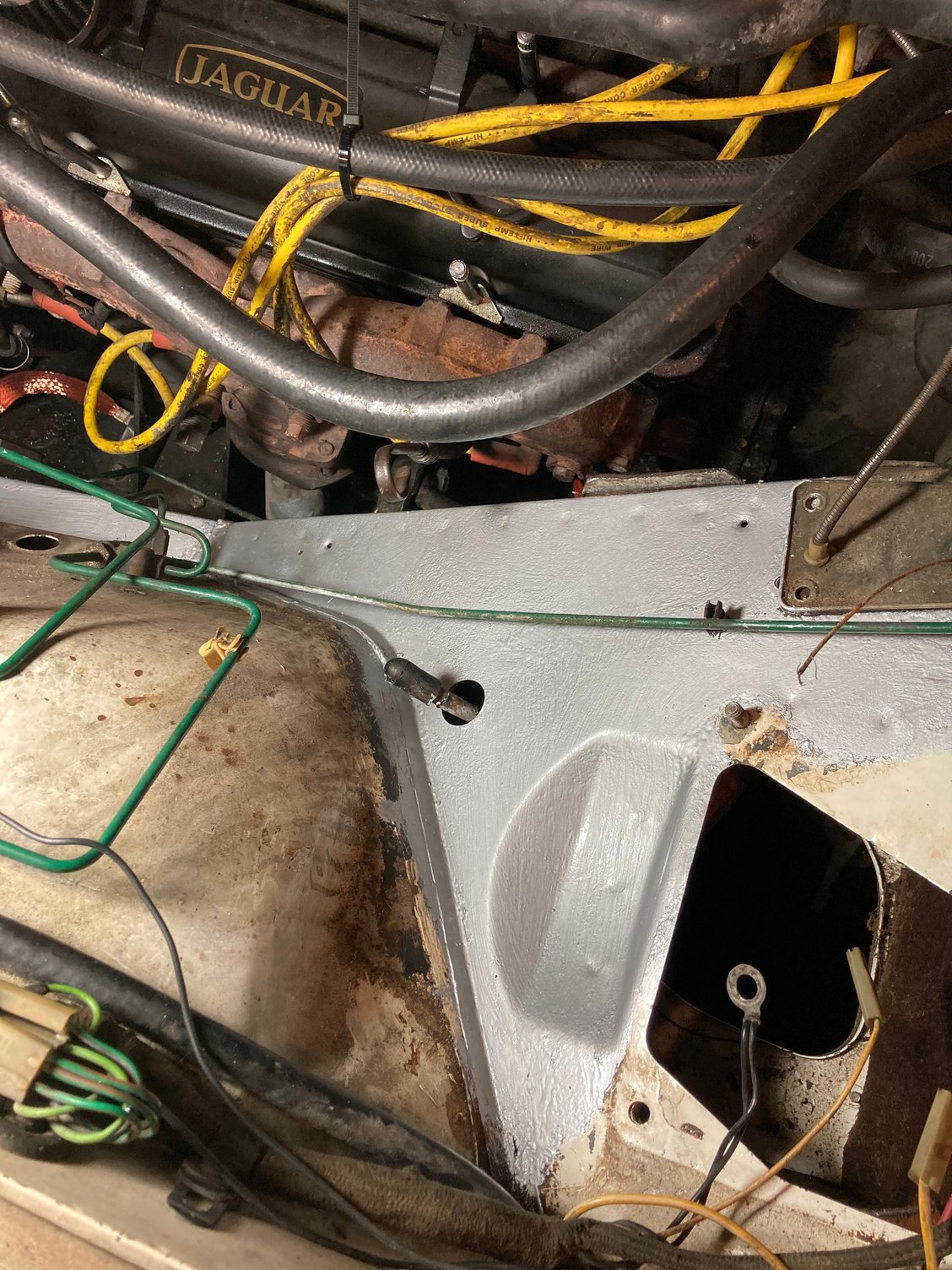

Week 5 of XJS ownership has been dedicated to clearing out the rust from the panel underneath the brake booster (and down the side of the driver’s side engine bay “wall”).
Here are the pictures.

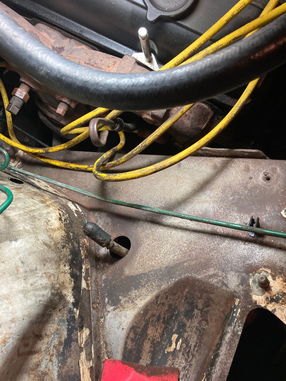

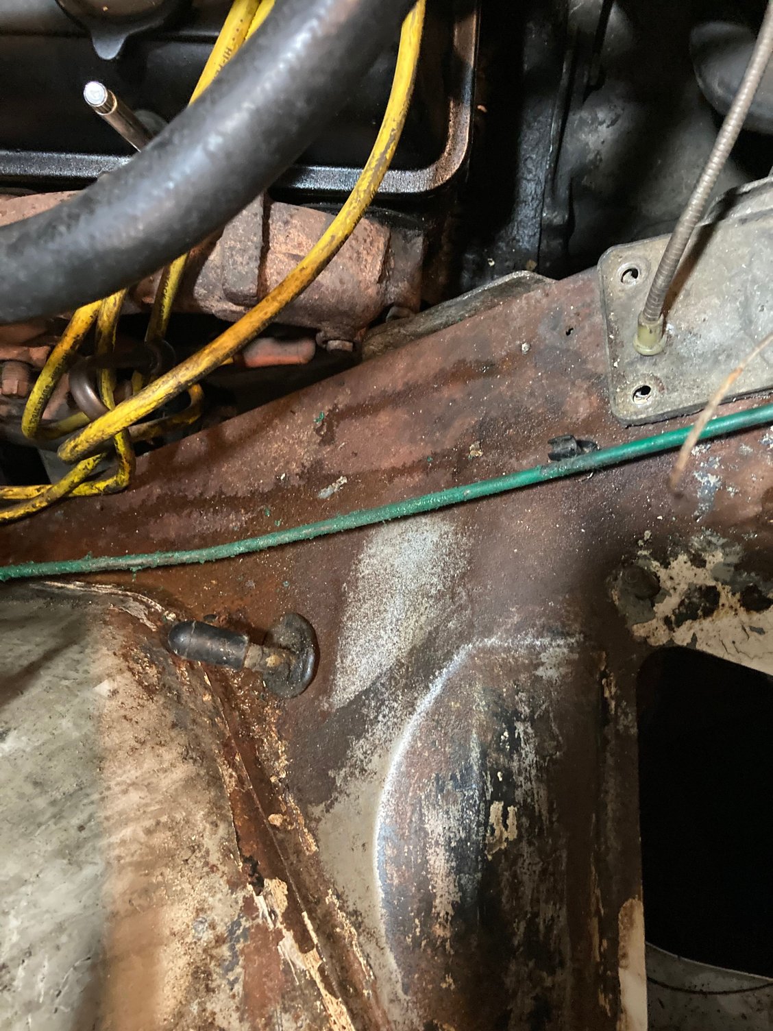

After removing the master cylinder and booster, this is what I was greeted with:

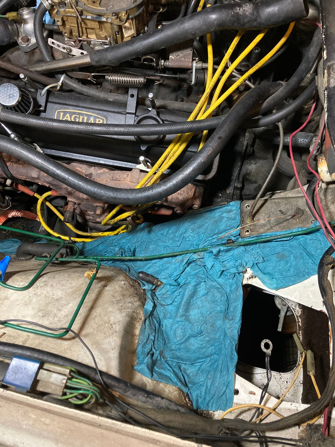

Soaked some shop towels with evaporust and let sit overnight:

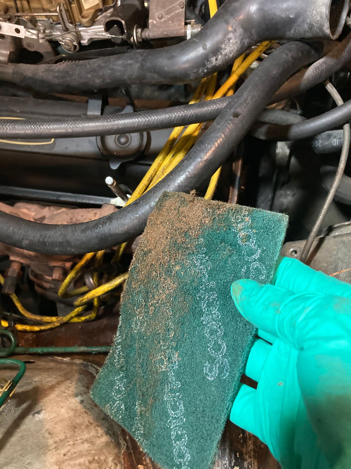

You can see how the scotchbrite worked the next day (which I first got wet with evaporust before each pass):

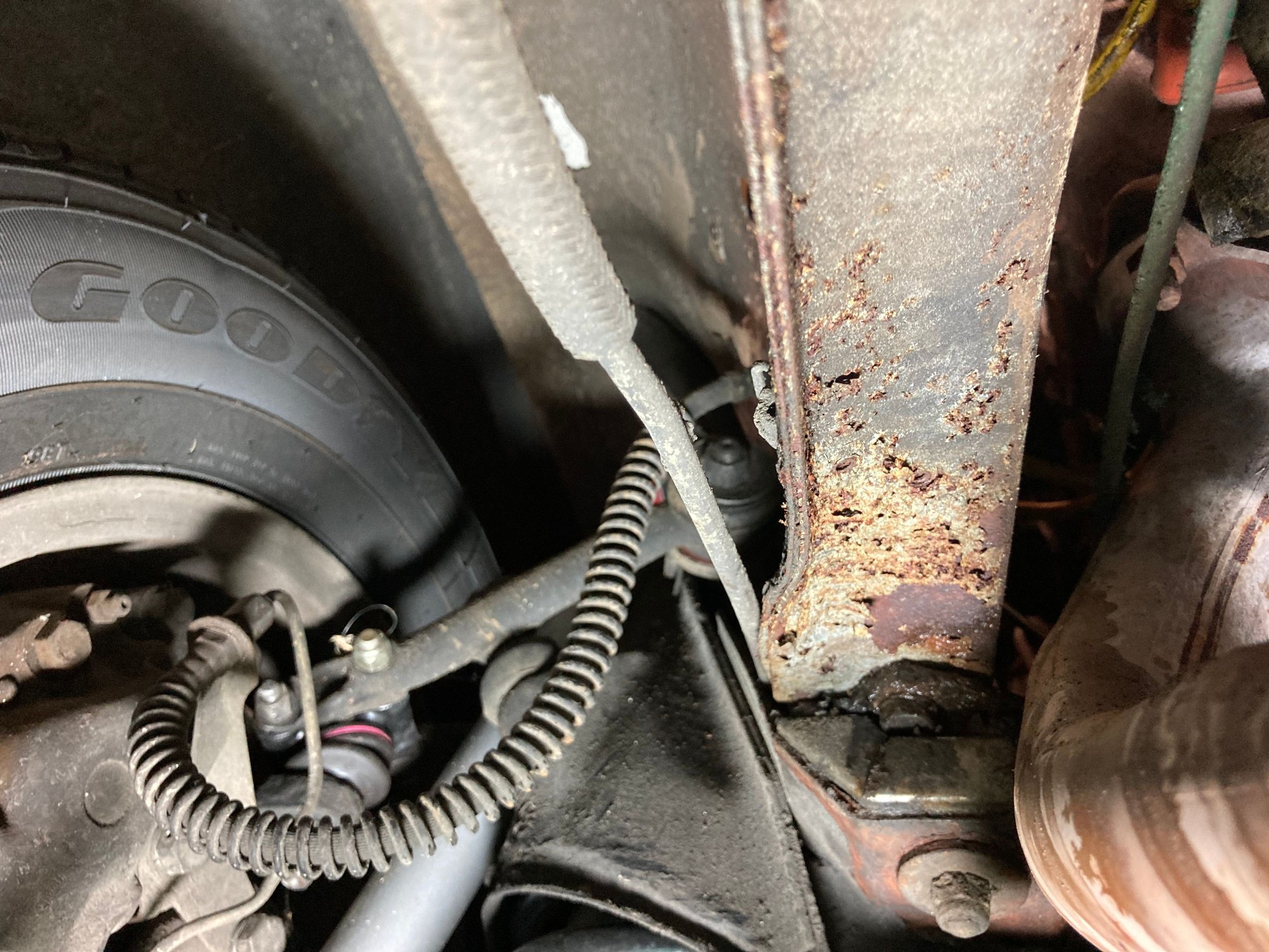

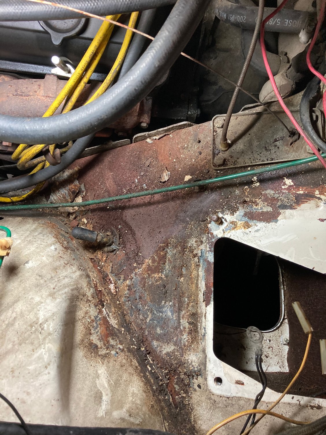

Some more corrosion underneath the engine bay wall:
After cleaning with the scotchbrite; not perfect but much better:
After cleaning with scotchbrite (note what may look like rust here was smooth to the touch; I suspect a mix of old primer and petina):

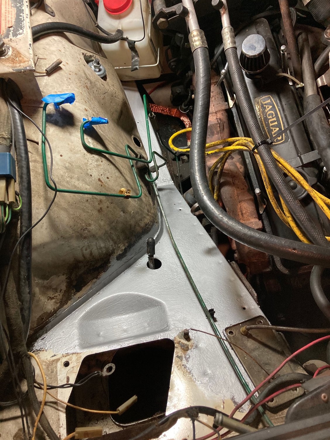

Your reward:
Wait no, this is your reward:
I used Rust Bullet Automotive paint, supposed to the best there is for rust prevention (
Rust Bullet - Amazon Rust Bullet - Amazon
I just used a paint brush and will be applying 3 coats in total.

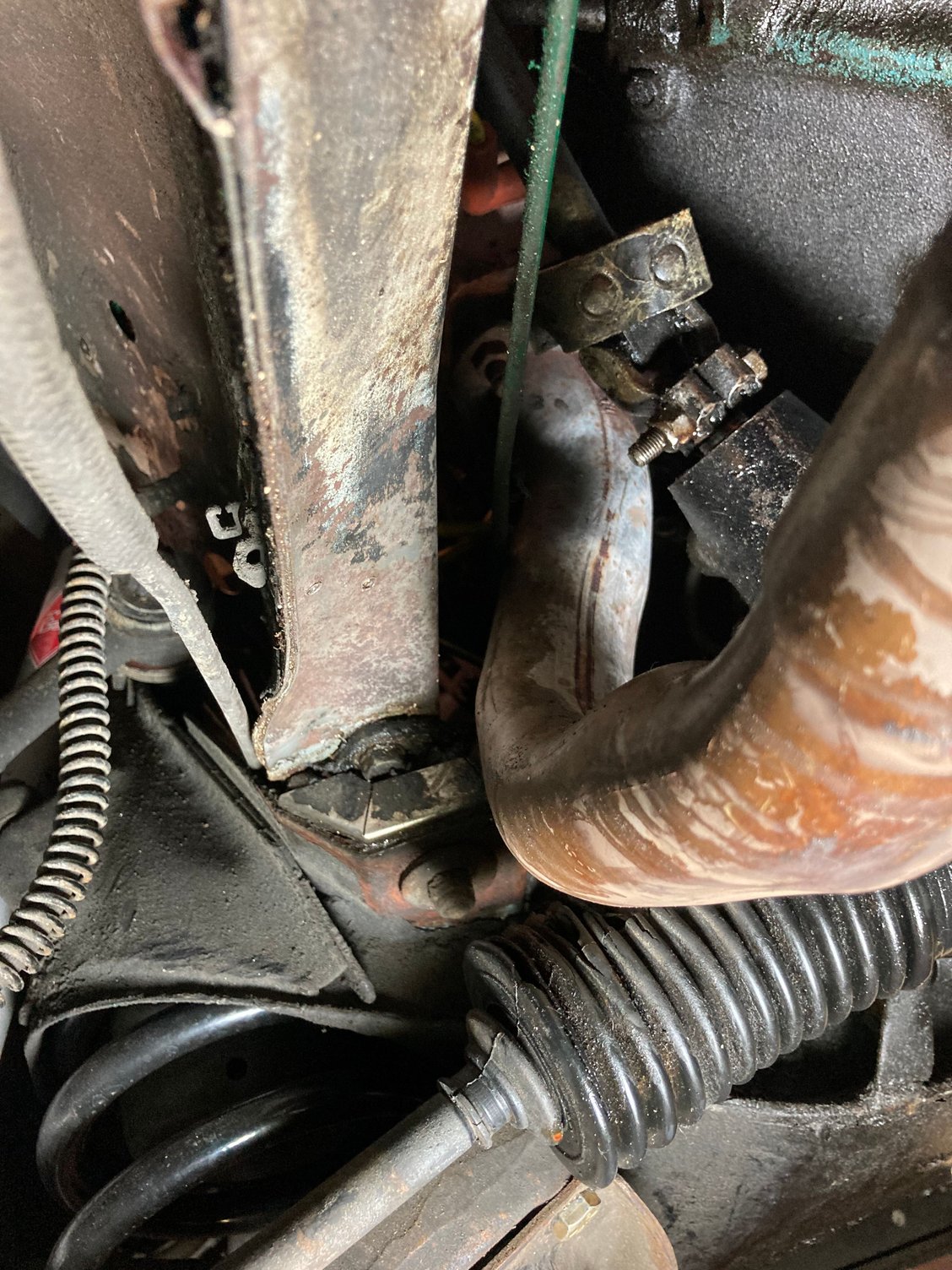

PS I know it might not be your priority right now, but you absolutely must change that torn steering rack gaiter!

is that a carburettor on top of the engine? And in spite of the decals, is it a non-Jaguar V8?
Oh I know and that is coming soon, but the car is getting a different set of front springs that will lower the front - at which point the driver's side exhaust downpipe will literally be running into the inner tie rod - so when I have my mechanic do the springs, I'm going to have him re-route that downpipe to give more clearance. Then I'll go in later and take care of that boot.
Hi Greg, yes - it's a John's Car conversion done way back in 1997 (assuming the install was done the same year that the order sheet was filled out in the back of the conversion booklet I found in the trunk).
It's a pretty anemic Chevy 350 (1980 wasn't a good year for power). The plan right now is to get everything in good order, do some paint work, and then debate between doing a T56 transmission swap or throwing a new 350 crate engine (or 383) in there. The nice thing about this setup is that a new 350 or 383 engine would install exactly the same way as the one in there now.

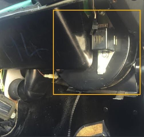

Thanks. Greg, an off-topic question for you that I don't think warrants a thread of its own. I tried searching for this but I'm not even sure what it's called so I didn't find my answer.
What is the black round metal thing behind the fuses? There's one behind the driver's side fuses and the passenger side fuses:
Both of mine have a little corrosion around the base, just wondering what this thing is so I can determine course of action.
Thanks Greg
Old Nov 24, 2021 | 10:26 AM
Greg in France's Avatar
Posts: 14,617
Likes: 10,820
From: France
One is the timer for the start up ignition advance vacum system. It does somethong or other nto the V12's systems system of vac valves.
It is called a Pektron unit. Can you post a photo of the other one please? If the V12 is no mponger there you can ignore it.
