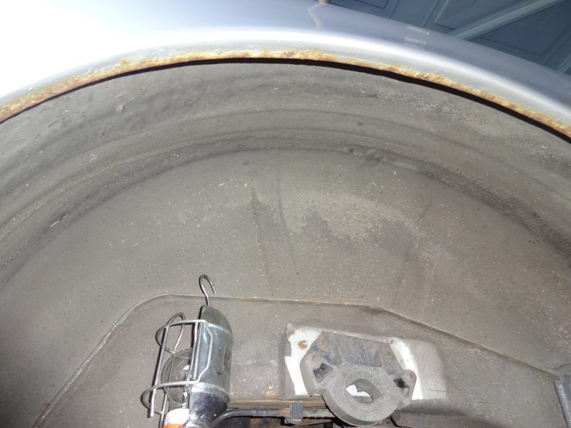

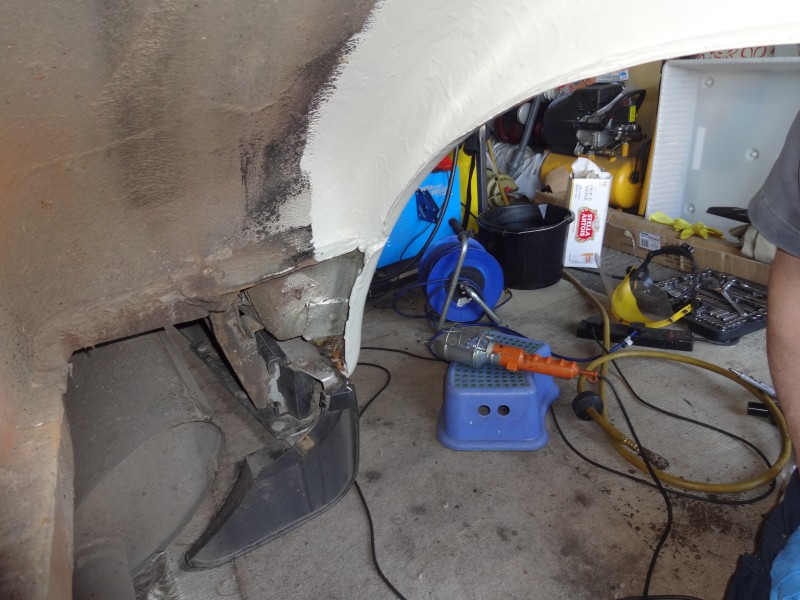

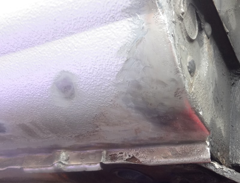

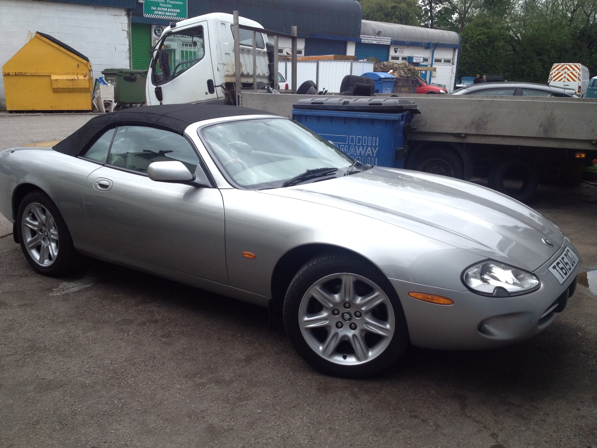

Kim's car is rusting along the sills, round the rear wheel arches and the bottom of the rear wings on both sides.
What a pain in the...

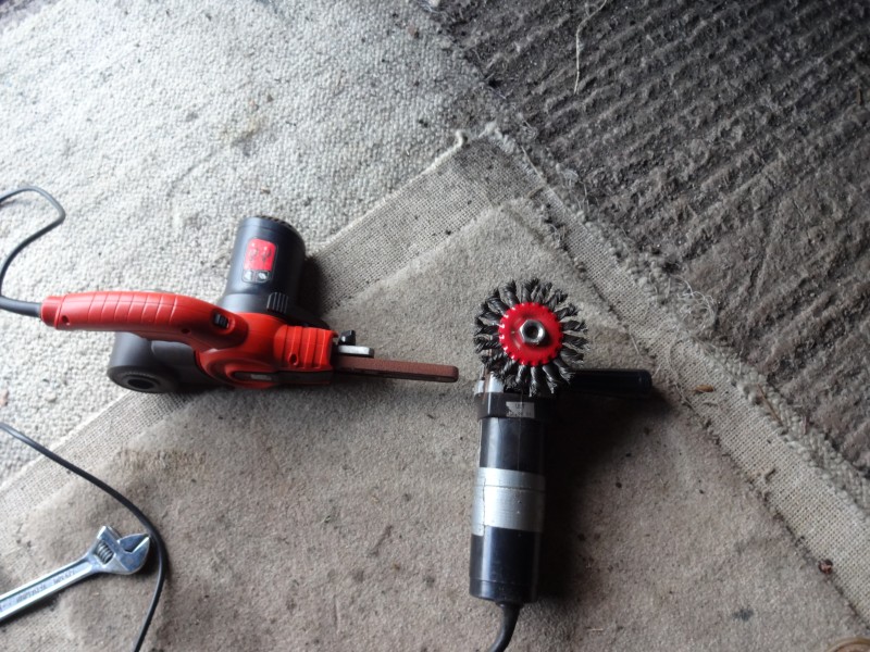

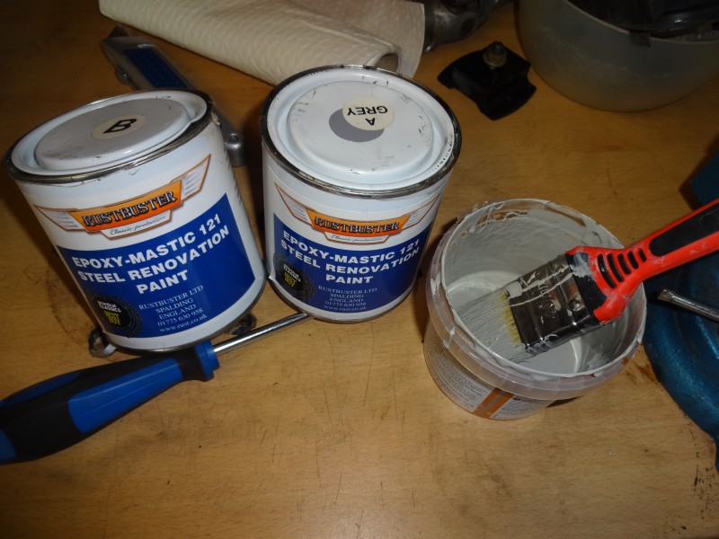

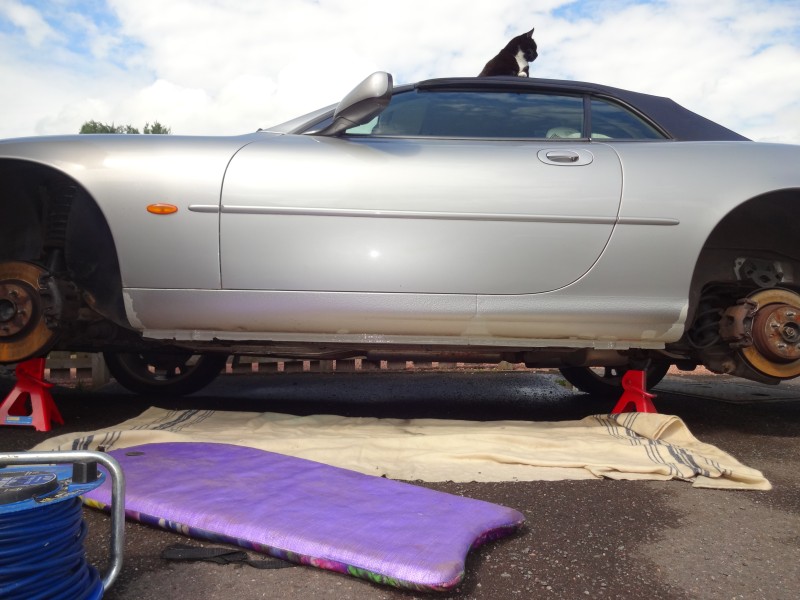

Weapons of choice.

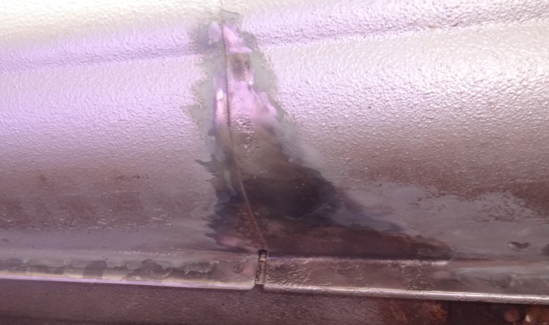

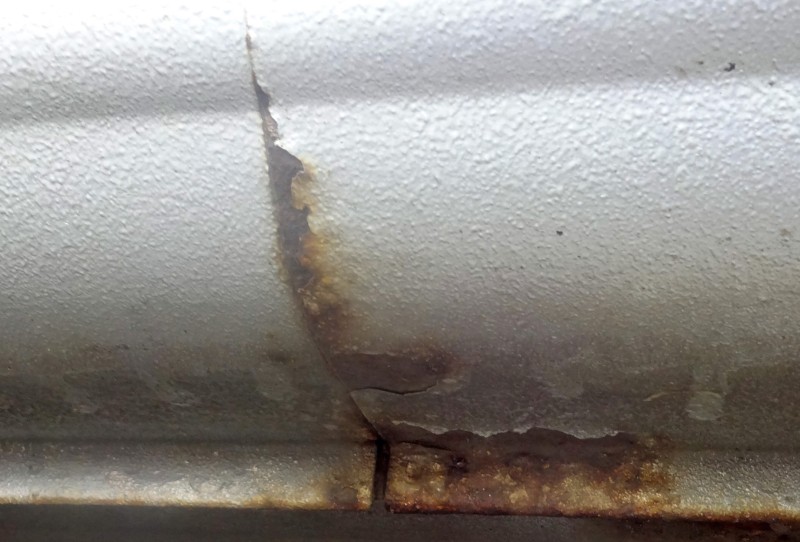

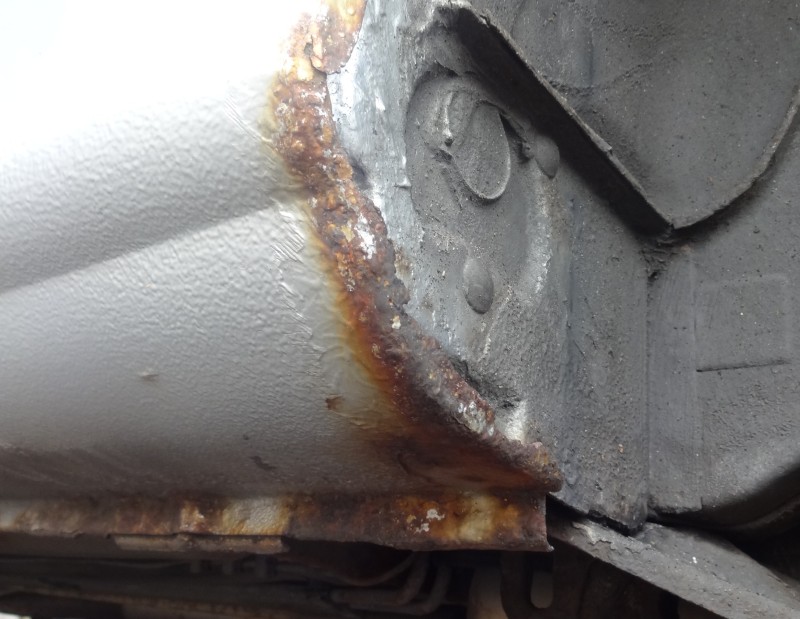

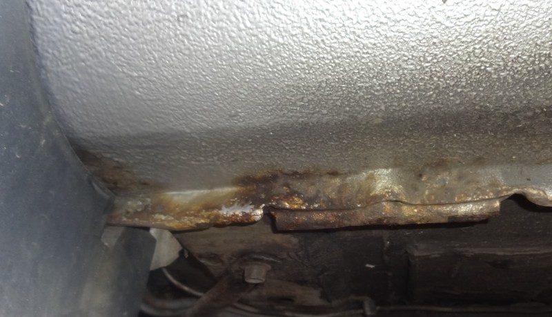

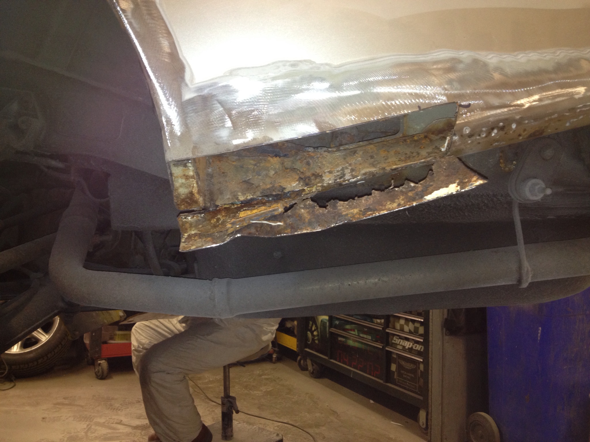

The problem sills.

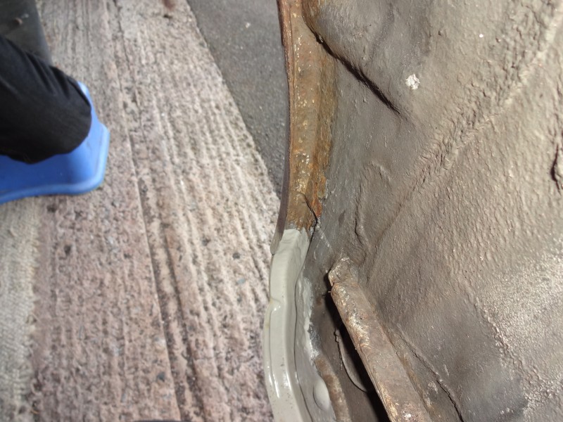

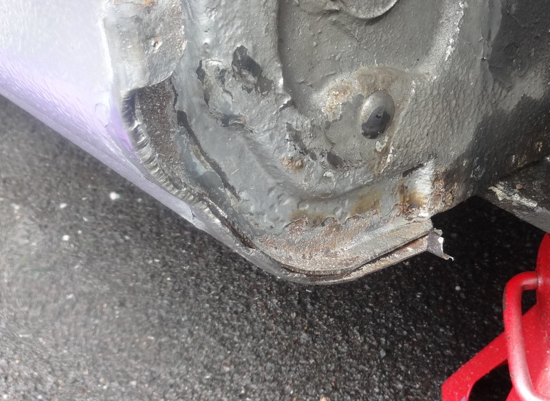

I had a go at them a couple of years ago but need to do the job more thoroughly.
After a bit of wire brushing with the angle grinder I has this.
I then coated with rust eater, then cleaned and dried with a heat gun ready for the epoxy primer.

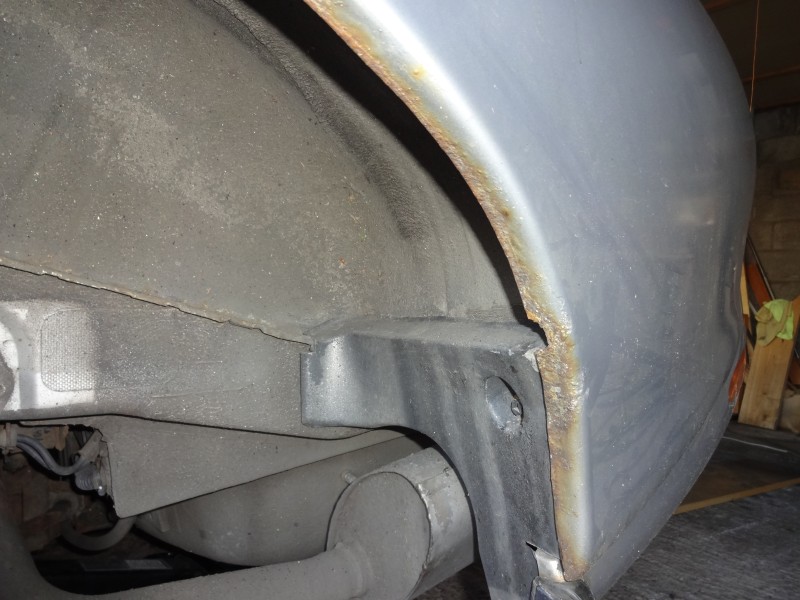

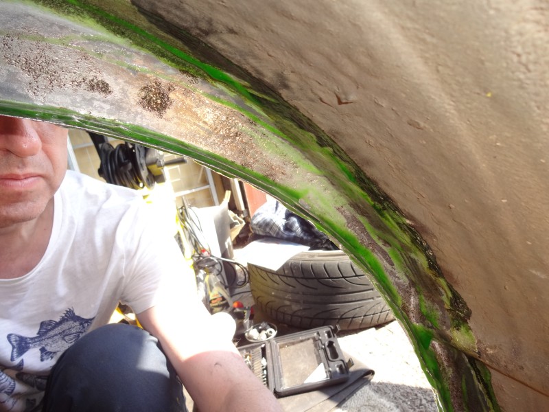

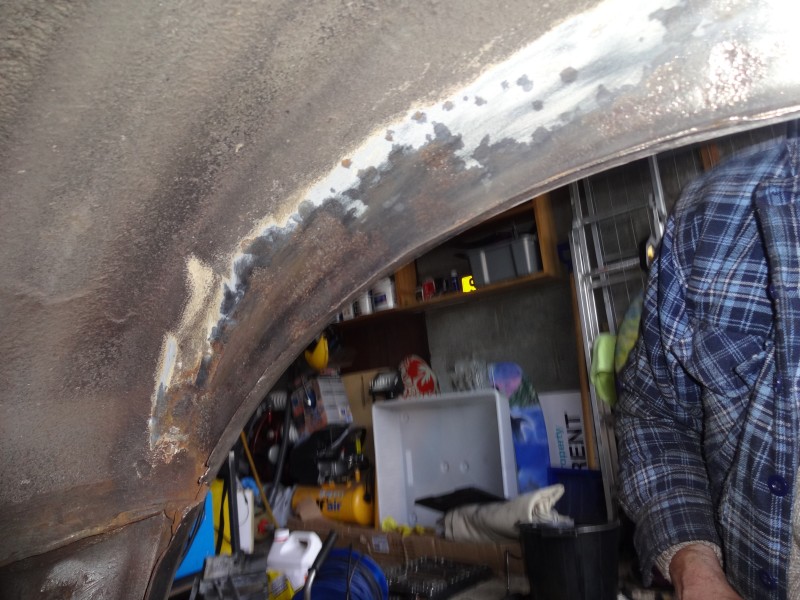

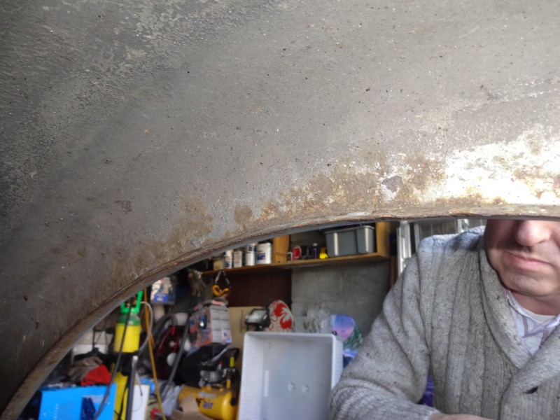

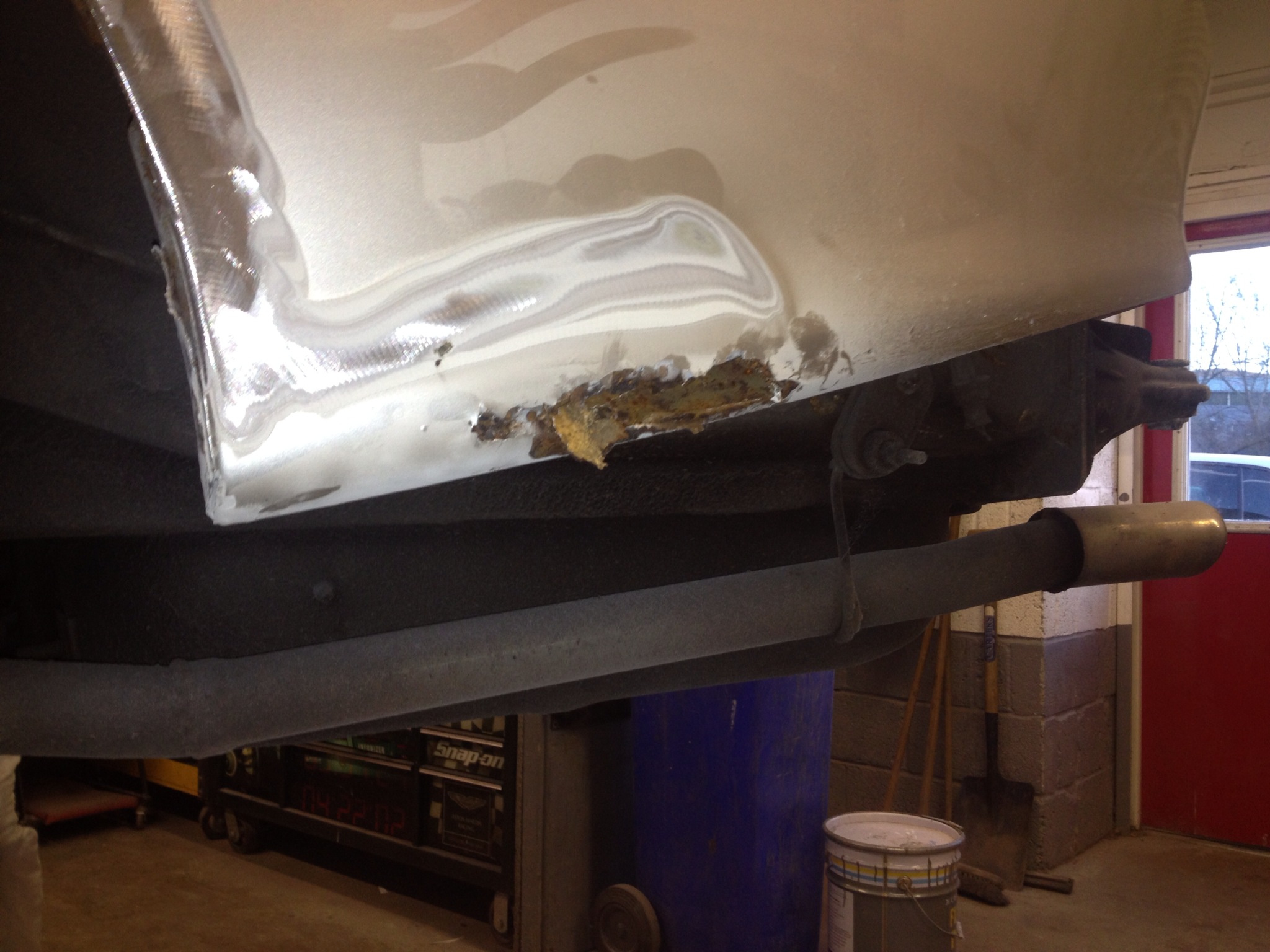

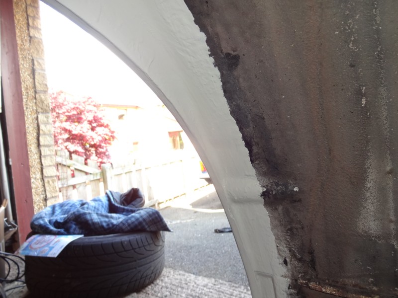

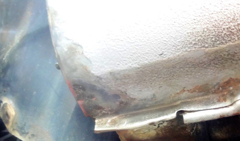

The on to the rear arch.

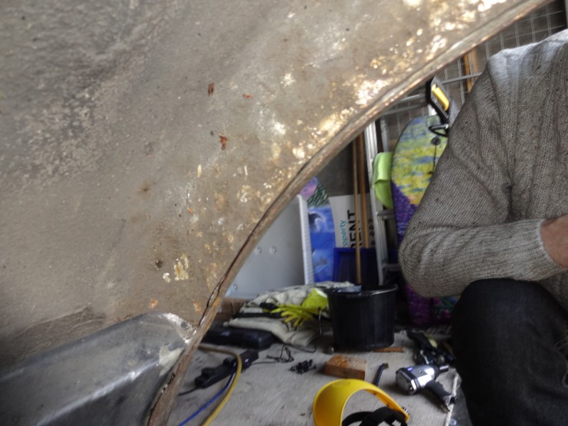

After a lot of wire brushing.

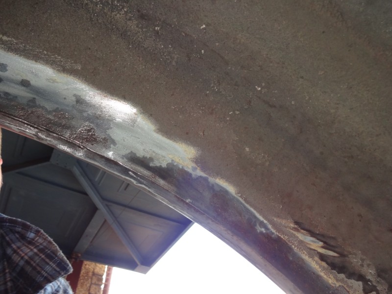

Next a couple of hours of rust eater, multiple applications and agitation.
And then the epoxy paint again.

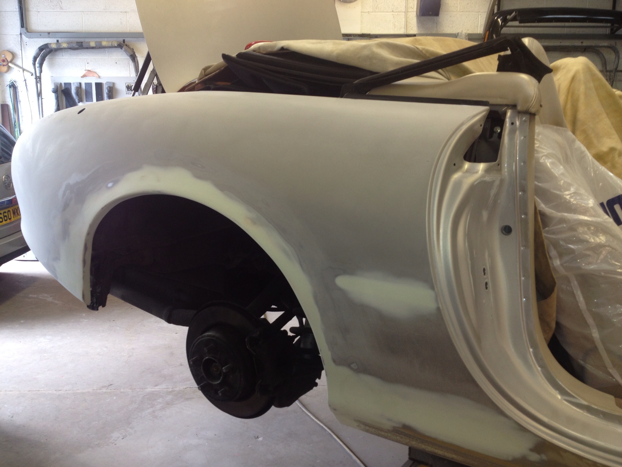

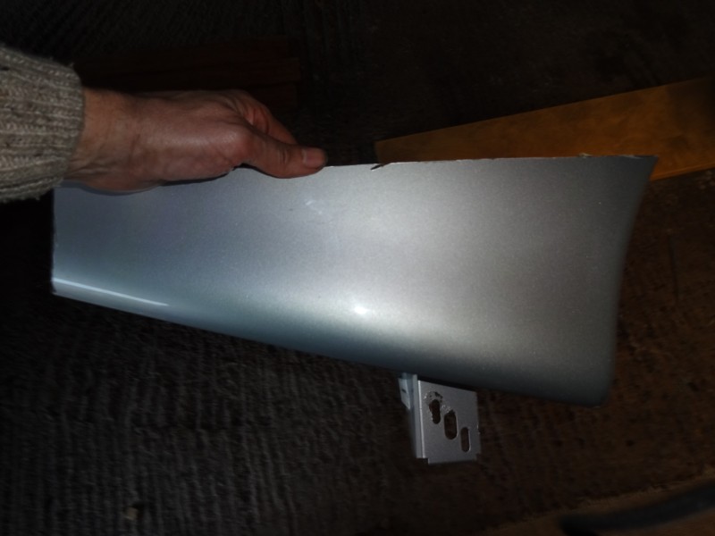

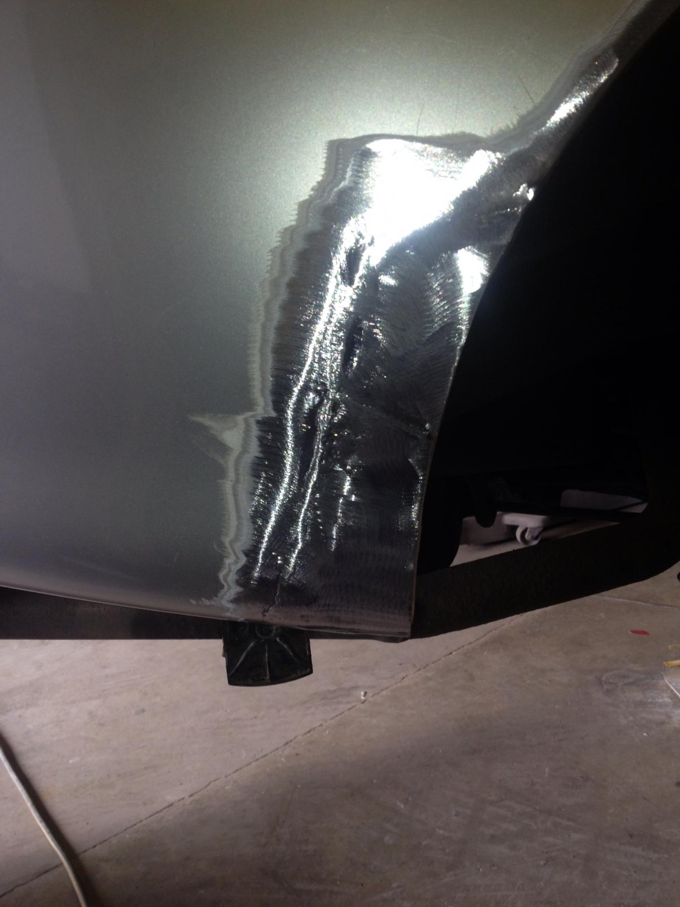

I'm going to wait for a donor wing section and weld it in before I block, colour coat and clear.
Right that is one side done, on to the other side.

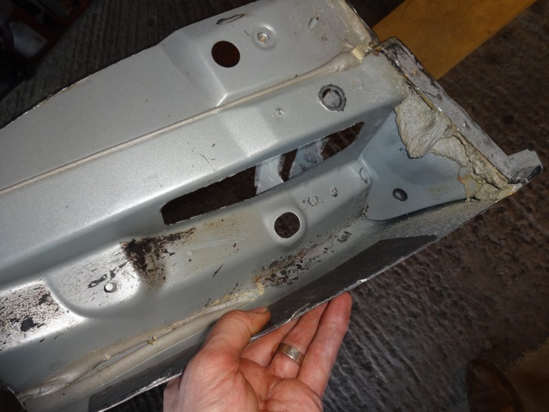

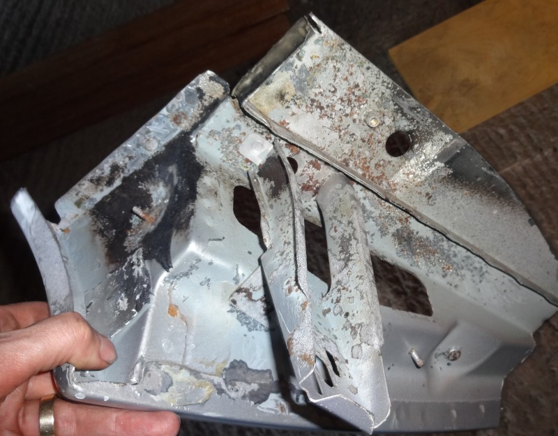

This is my donor for the other side.

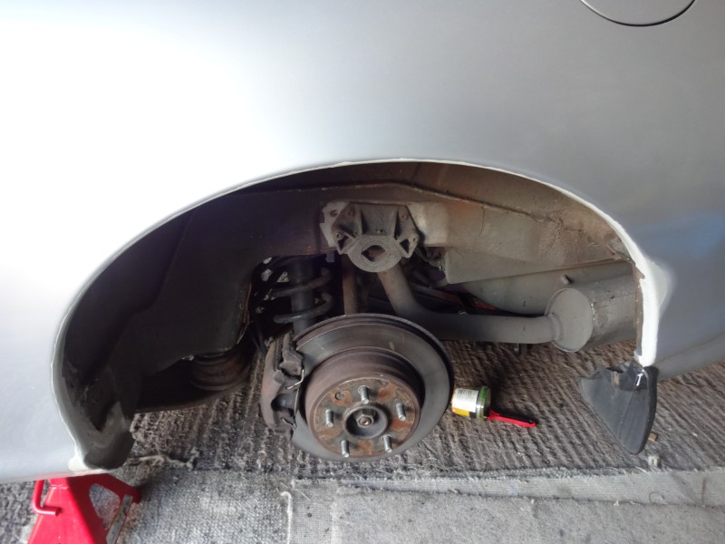

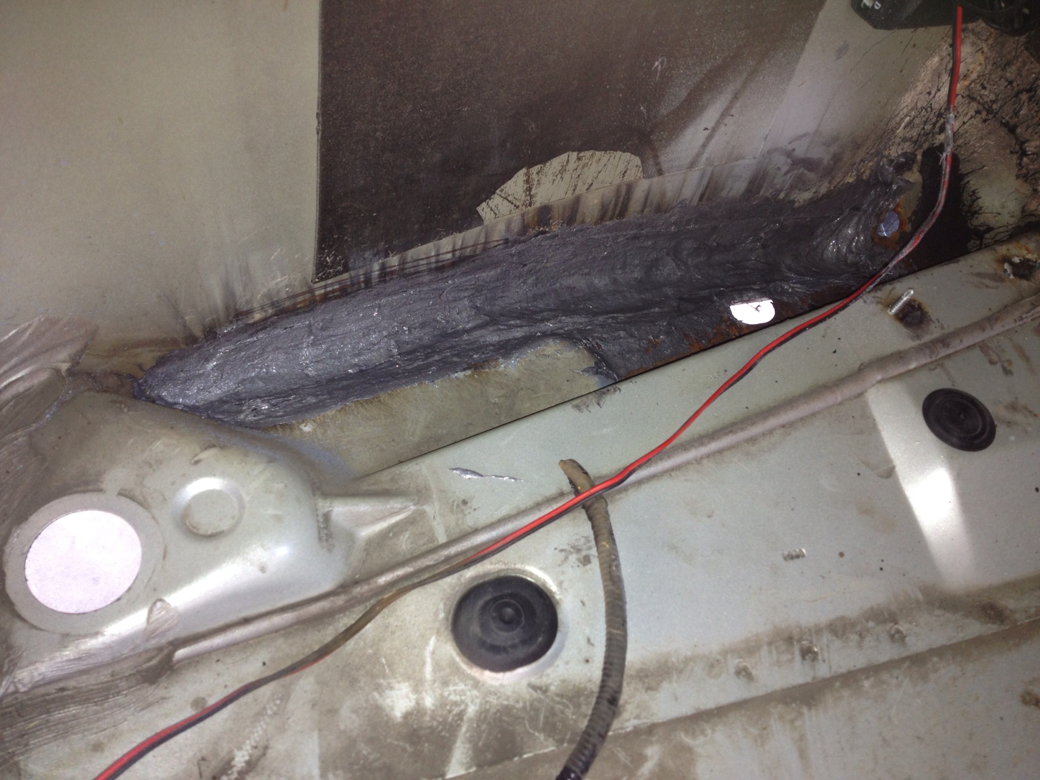

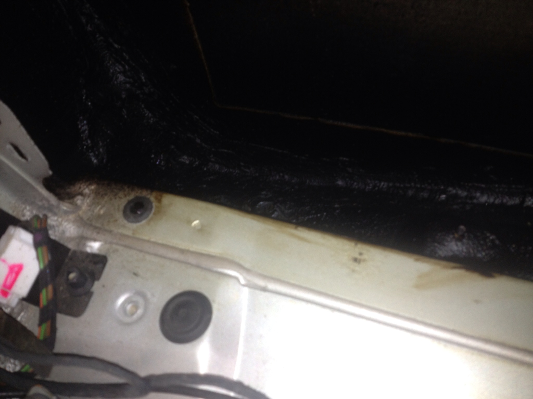

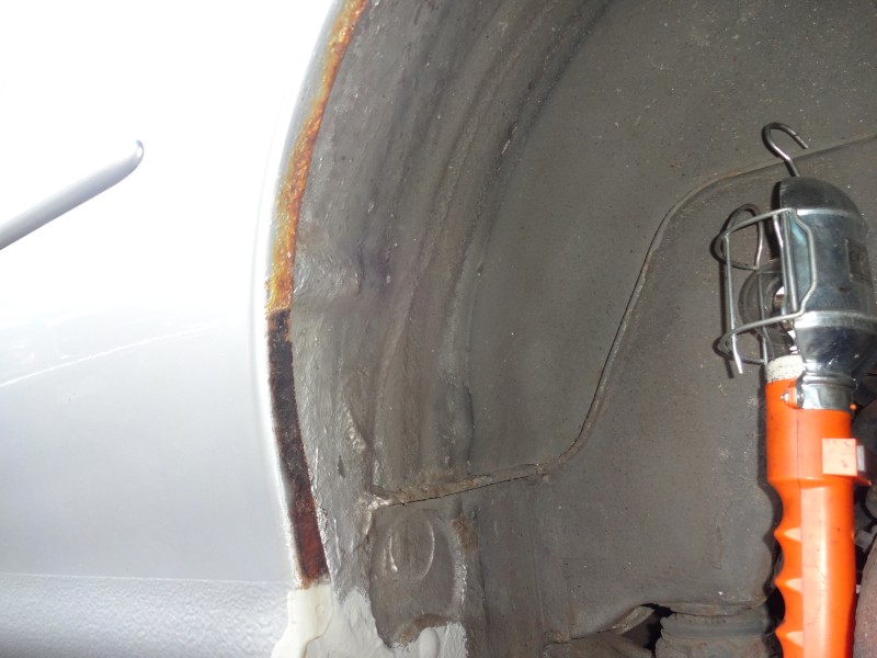

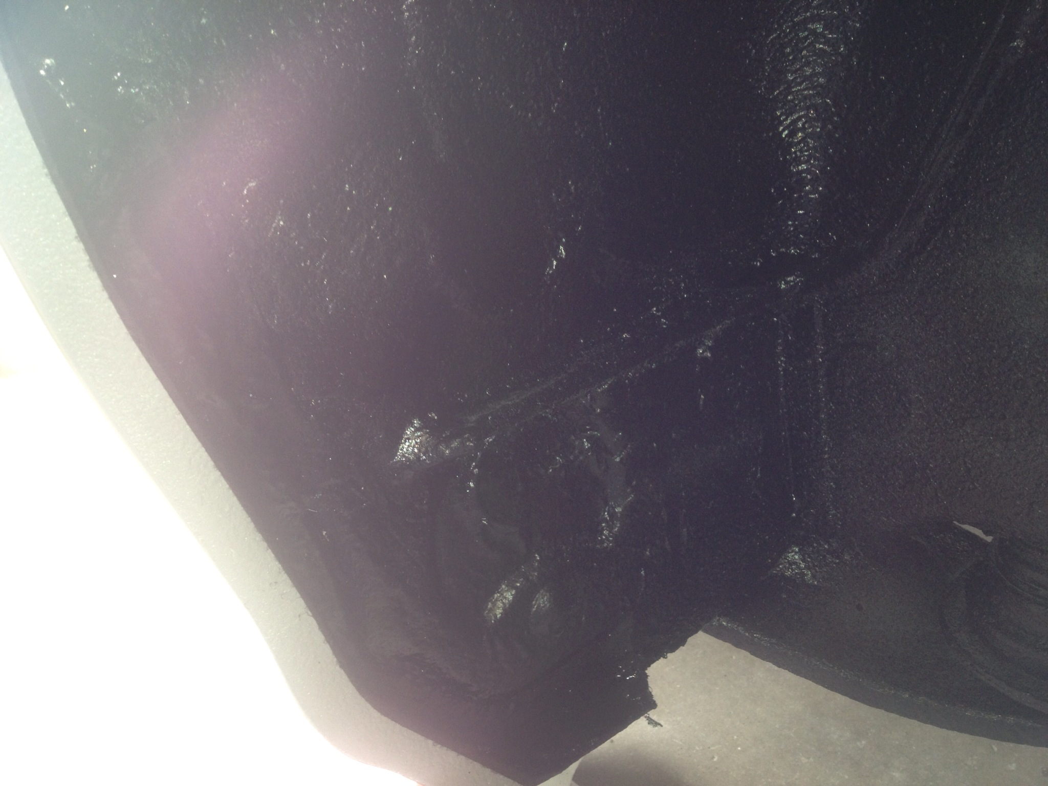

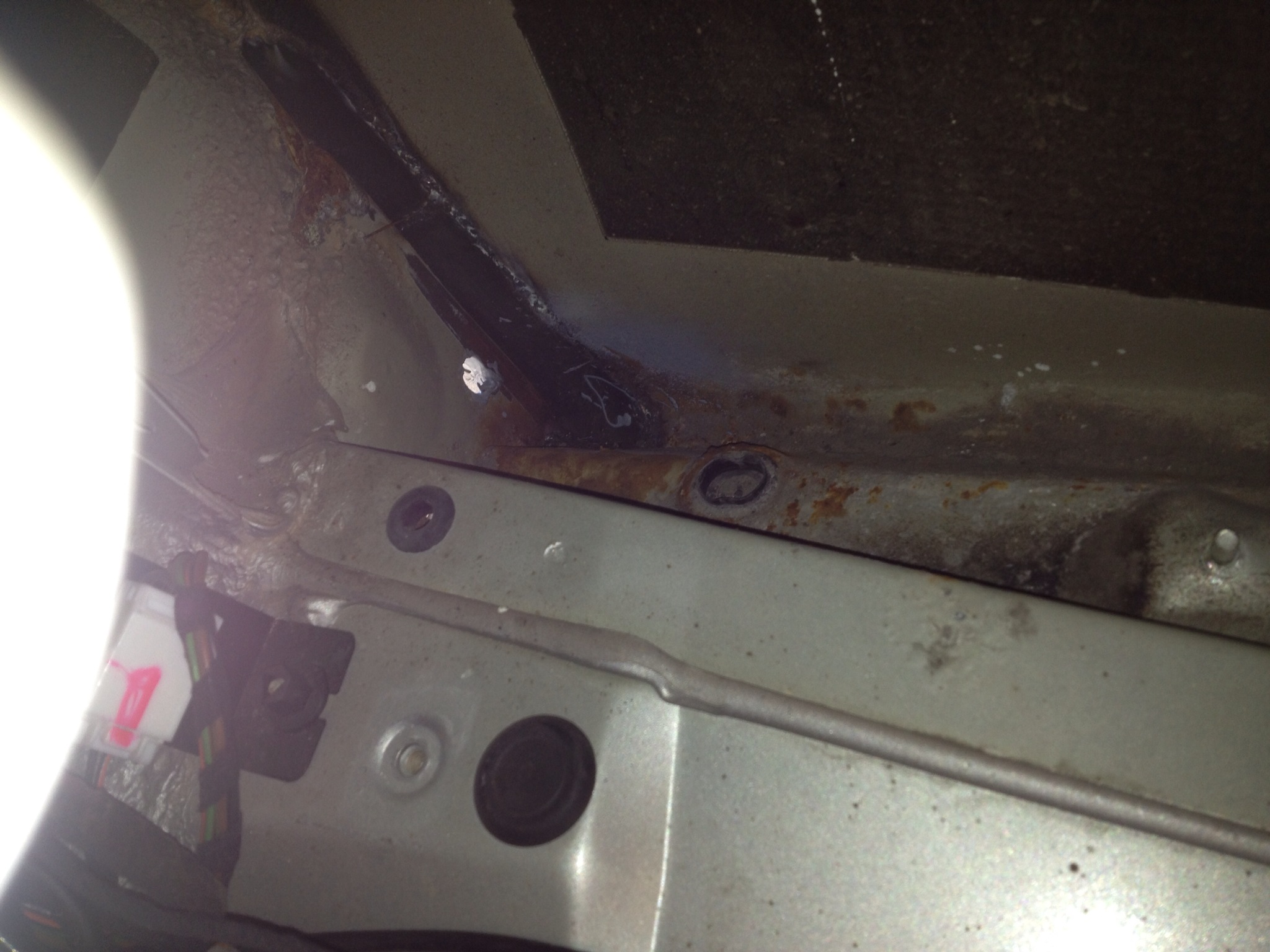

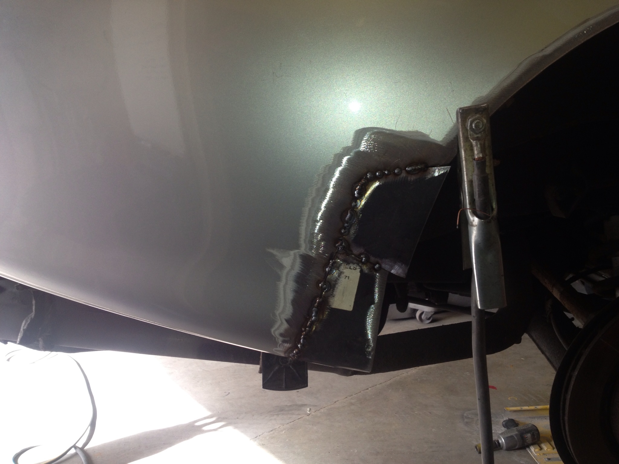

I had a simular problem last year. I dropped it off for 3 weeks ad saw it 6 weeks later (At the pre-agreed price dispite the extra work needed) Rear arches needed replacing (Ford Transit are the right curvature and depth).
Boot rotted out at bottom of saddlebags and the slide/ guides that retain the front of the rear bumber had rotted away. Everything was repaired and waxoil coated.
For extra protection a mixture of fibreglass and metal filler was used to fill the boot sable bags and to put a fillet on the arch returns, to stop them rotting from the inside.
