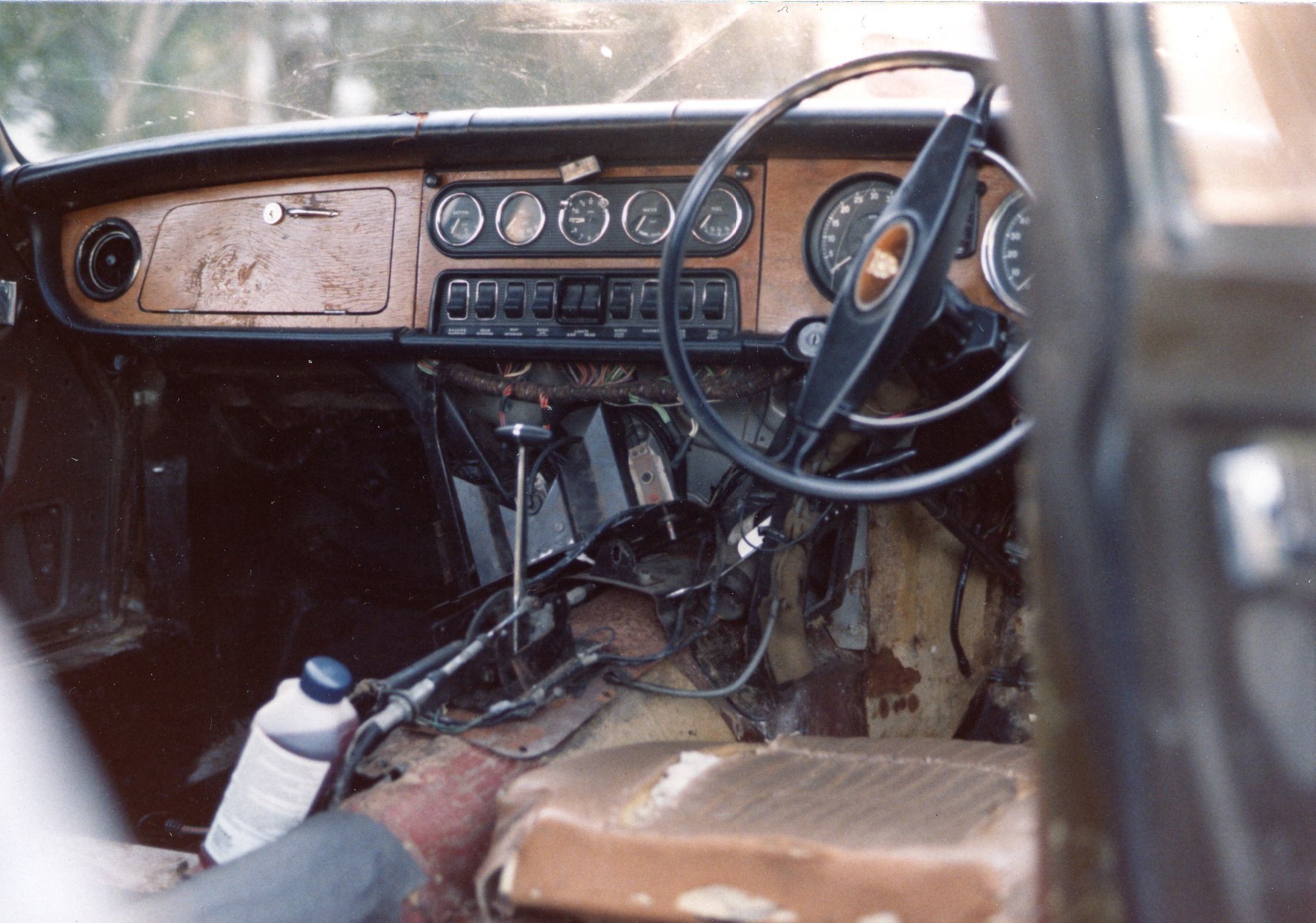

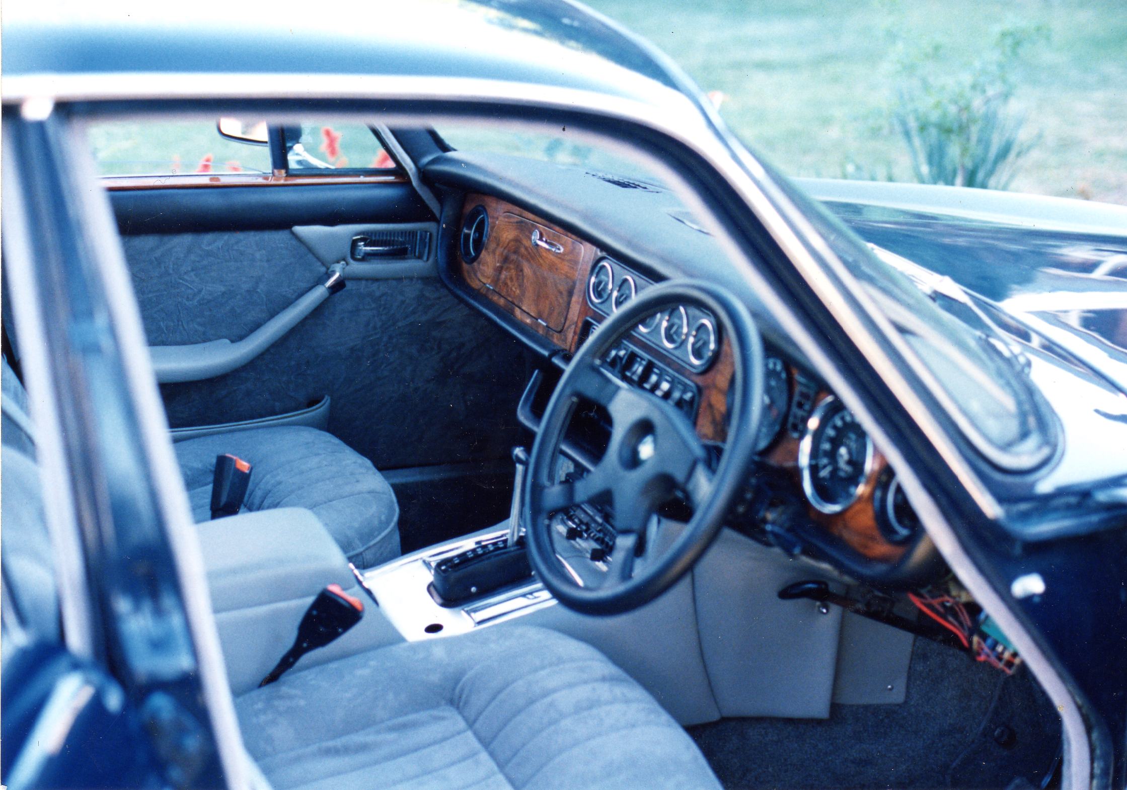

In Australian trim the 5.3L made 285hp and 310ft/lb of torque in the late 1980's compared to a C4 Vette that made 230hp 330ft/lb in 1989. The V12 is just not as tunable as a Chev engine, and costs more due to limited supply and there being 12 of everything. It's a BIG engine as heavy as a BBC.
I'm the owner of an 89 V12 and I have no issue with Chev swaps into Jags. Been there done that 30 years ago with a S1 XJ6 and a 350SBC.
