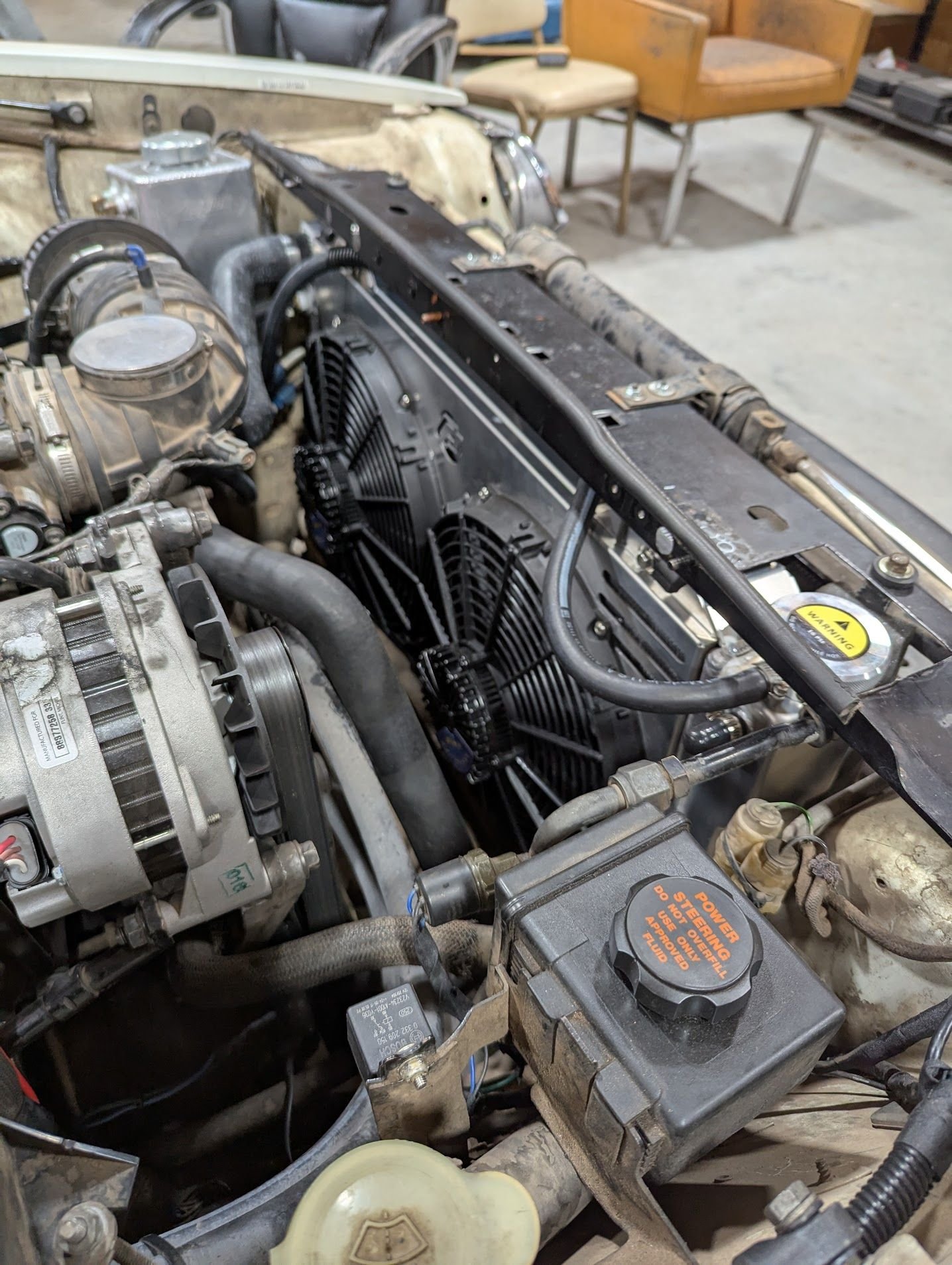

I've found that about 40mph there is enough airflow to not need a fan fwiw, the temps start coming down to highway-norm and the fans drop out. That's with the stock condenser and a stacked plate style radiator and oil cooler under it covering part of the radiator.
And PWM fans are the bees knees, they can aim for a target temp and avoid both the cycling up and down of temps and the sudden hit on the electrical system from high speed fans engaging.
Even among v8's the LT1 has odd cooling behavior but between the decent aluminum radiator and good fans and shroud the improvement was impressive vs a large copper/brass unit and a pair of strong single speed fans.
184f @70mph, 193-197 in town with the AC on and you never hear the fans, at 90f ambient. It cooled well enough before but the rad had been leaking, again, for ages so figured I'd experiment a bit.
I would imagine the v12 is more difficult to cool but this setup seems to have plenty of capacity. I'm eager for a 105 degree day to see how it acts.

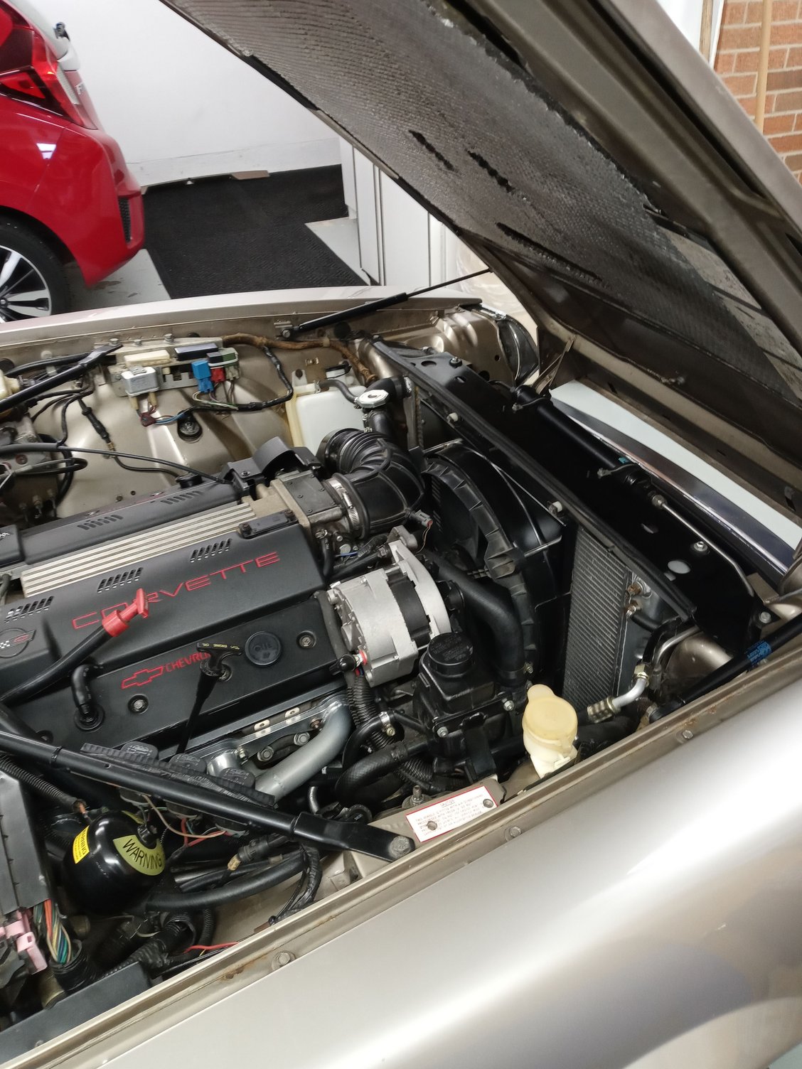

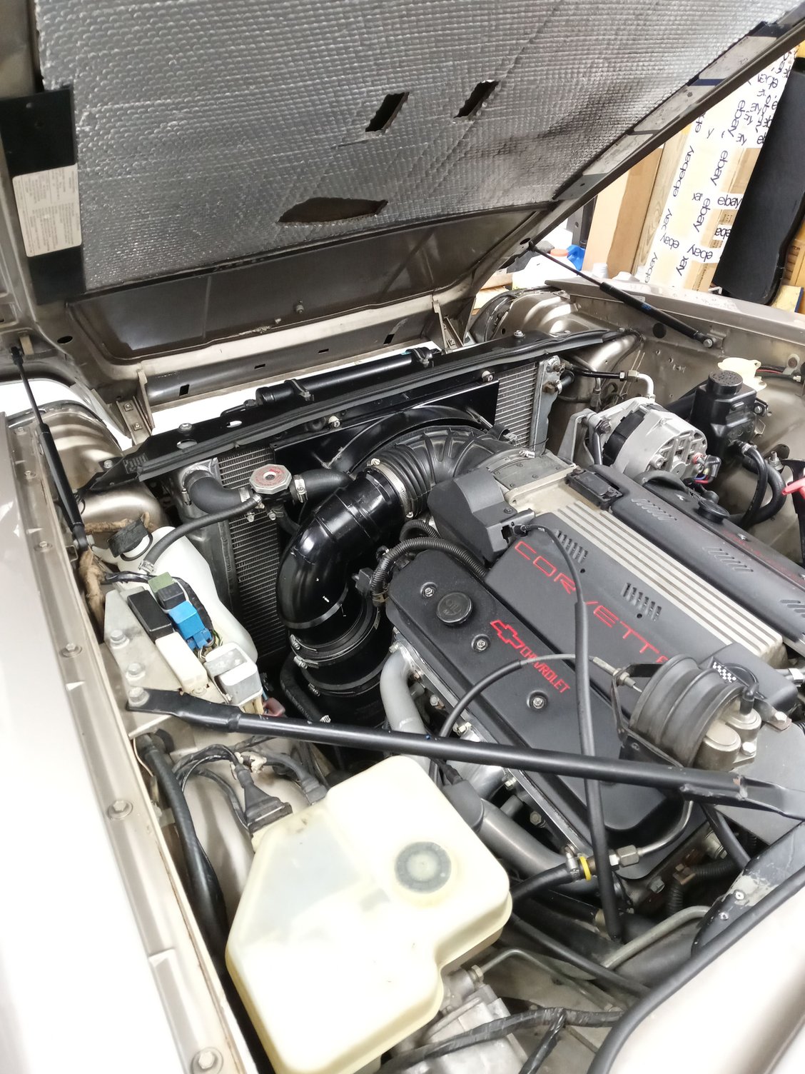

I bought this '89 as a roller package with no v12 engine in 12/2000. In 4/2001 I was driving it and this month it's been on the road for 24 years. Still runs and drives perfect. I used a Griffin universal race aluminum radiator. It fit the stock Jag location like a glove and was rated to 600 hp. It keeps the lt1 at 180 degrees on the hottest days. I'd say it would work on any engine you had. I even used the stock Jag shroud with a single 16" fan from late 80's Camaro. I do remember a little hesitation at the price of $350 20+ years ago.

That is excellent, how many miles on it? I rolled over 250K on the car and about that on the motor on a trip to the east coast last Christmas since ours got eight'd about 15 years ago at 100K.

Thanks, it had 59k miles when I got it and 122k miles as of today. You got a lot of seat time on yours.
Looks spotless, there's a reason I don't show mine off lol. I just the other week finally replaced the stock hood pad that's been dropping
oily goo and dust on everything for the last fifteen years. Very function over form this ole thing of mine at this point. She sure does function though.
Iron head LT1 from an impala, tuff as nails and does not make enough power to hurt anything I did the LS coil conversion four or five years
ago and that was about the only trouble the engine ever gave. Put a valve body in the trans couple years back, it was rebuilt when the engine
went in. Been a good setup. The rest of the car keeps me entertained with things going weird from time to time.
I don't drive near as much as I used to, worked from home for years now but have put a lot on this one for sure. Easy to rack up miles
in the midwest where things are long and straight, good place to be in an XJS most times.
