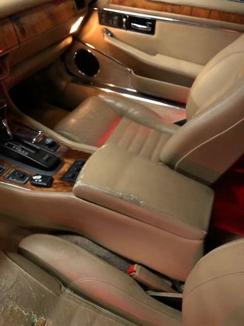

Here are some interior shots:
I contacted Paul's Jaguar this morning and ordered his covers since ehe has the actual supply of Connely (sp) leather on hand. I'm also shipping him the center console to be recovered as well. All said and done it should take three weeks to get everything to my doorstep then I'll start a new thread of the process of replacement.
Thanks everyone for the recommendations on vendors, "Jeremy" and Paul's was extremely helpful.

I was watching some you tube videos on seat restoration, using those Furniture Clinic type products. These are where you sand down the top finish, use a paste to fill in cracks smooth and recolor and finish the top coat. For a small repair I think they could be useful. The end results look great but I just don't think that the repair could hold up to daily use.
Your driver seat looks like it's in much better shape than mine. The leather is as hard as beef jerky and large chunks have cracked off the seating surface. I tried treating the seats with a conditioner, but it wasn't effective in softening the leather. I'll just live with my seats for now, my car needs other things first, but I'll be following this thread. Good luck.

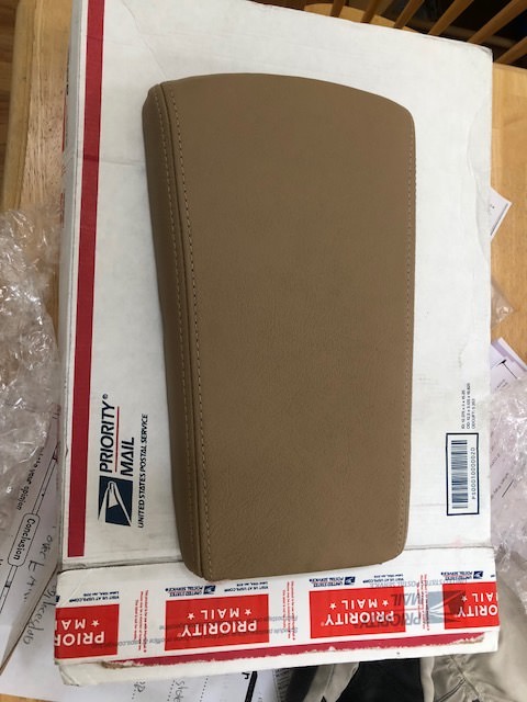

OK, some progress. The console cover is back from Paul's in Florida, they did a magnificent job.
The covers for the front seats have also arrived from Pauls in full Connely leather which I believe is an improvement over my original seats which appear to have fake leather bolsters.

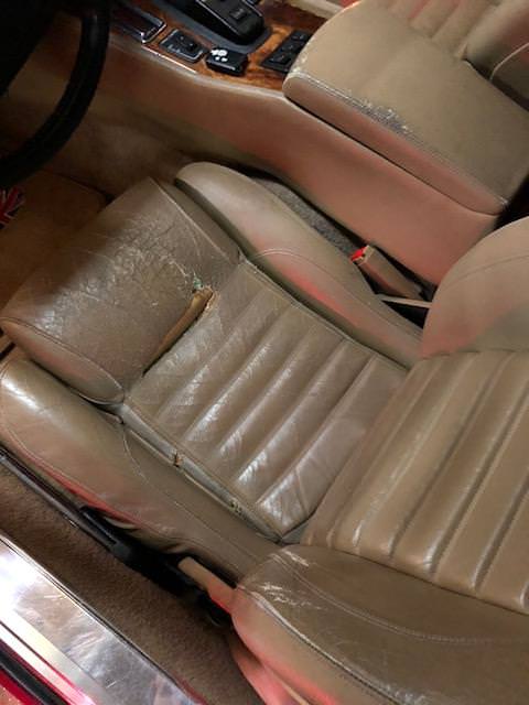

I have the seats out this afternoon and packed in the back of my Rover to drop at the trimmers tomorrow. After taking a look at them I think they need enough foam work that the trimmer at $500 to install is money well spent. (I also found $3.00 in change so that's going to help costs.)

How much did the armrest cost to have redone?
Old Mar 25, 2018 | 07:55 PM
Time-Pilot's Avatar
Joined: Oct 2013
Posts: 274
Likes: 88
From: Denver
It was $134. I’m not sure though if the price was was packaged with the front covers.

Just a "pro tip" when you drop your seats off to have them worked on, or are working on them yourself line up the seat tracks with the bolt holes in the tracks so the shop can remove the tracks. This would have saved me a trip back home to plug the seats back in to align them.
