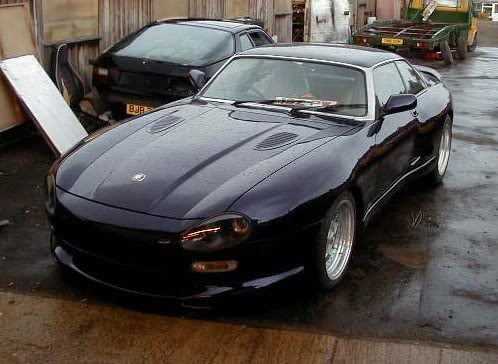

That reminds me of how my XJS use to look..... I love purple
That had a supercharged V8 in it for a while
