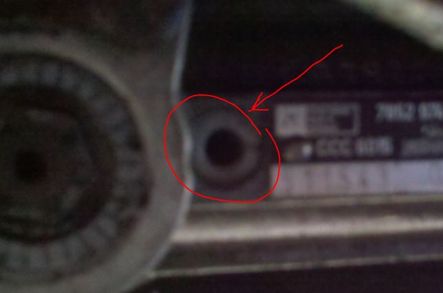

Well, just got the 1988 XJ-S and joined the forum and I am already stumped. I am hoping someone has the answer to this question. Seems the "leak" in the power steering is not from a hose after all, it is from the drain plug in the steering rack - it seems to have gone missing. I have not been able to find the specs for this plug anywhere. As far as I can tell it is 5/16" but it is not a Thread I can identify. I tried NC and NF and neither seem to be right. So, anyone out there know what the specification for this plug is? A part number perhaps?

There is no drain plug. Maybe a photograph?

Well, it may not be a "drain" plug but fluid is certainly "draining" out of that hole. I was able to take a picture of it, sorry about the bad focus. Interestingly enough, the illustration, on page 275, in my Haynes manual (manual 478) clearly shows the plug but does NOT identify it.
That hole, I am pretty sure, is the access hole that allows a rack-centring probe to be inserted, the probe will go into a hole in the rack itself. The rack hole hole is found by moving the rack back and forth until the probe (being lightly pushed inwards) clicks into it, thereby locking the rack. This is to ensure the rack is centred before setting up the toe each side.
If I am right, and it looks just like the access hole on my rack, the hole is normally covered by a rubber bung to keep grot out. If fluid is leaking from it, it means the internal rack seals are shot and a recon rack is needed.
Greg
Greg
That kinda makes sense. Not really what I wanted to find out though...

Well, having gotten back to the car I was able to spend more time checking it out and found that fluid is actually pouring out the passenger (right-hand) end of the rack. So it is now time to track down the best deal on a reman'ed rack. Oh well, such is life.....:-(

I got the remain'ed rack and got it installed. Now I just have to go back and tighten the fittings since one still leaks (grrrrrr). The remand rack came with a "set screw" like plug in that hole I was asking about originally. The plug is 10 mm and a course metric thread (don't recall the actual thread count.) Dropped it off at a local alignment shop to get the toe-in set. Car drives wonderfully, except for that pesky new leak.
