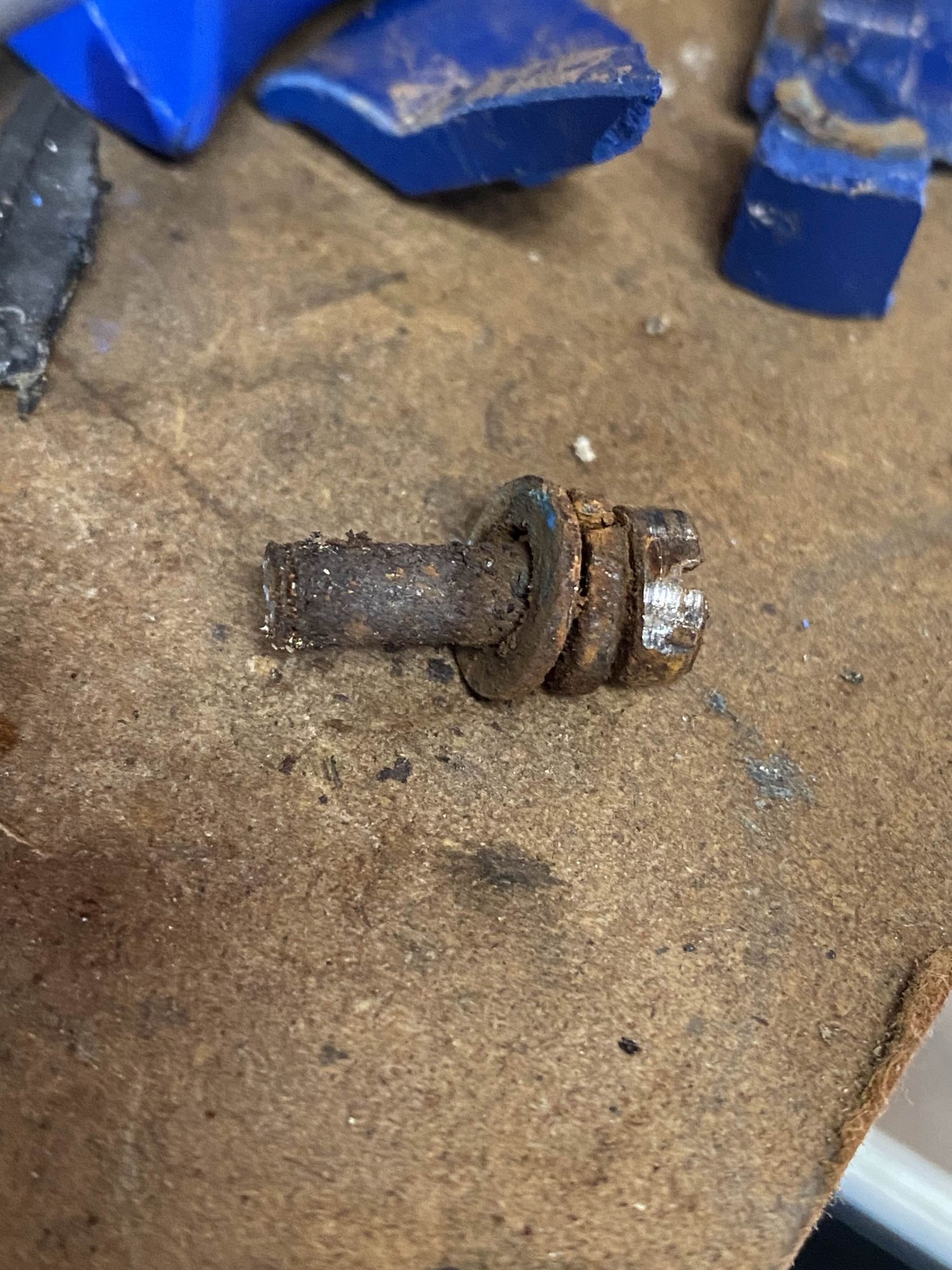

I decided to dive into my ignition system refurb, and the first thing on the list was to replace my vacuum advance, which hasn't worked for pretty much the past 6 years or so.
However, when trying to remove the distributor cap, which should be the easy part, none of them will budge at all. They've been soaking in penetrating fluid for a week or so.
On one of the screws, it simply broke off the top part of the head where your flathead screwdriver would sit, and didn't budge whatsoever. On the second, I tried using a microtorch to heat the bottom part of the screw as best I could, but didn't get anywhere with that either. Also ended up breaking the tips off of 2 or 3 screwdrivers.
On the third one, I tried the microtorch again, combined with a nice metal-body screwdriver with a wrench attached to get some leverage to turn the screw with more force. However, it simply... twisted off about ~20% of the distributor cap, along with an ~0.75" section of the aluminum distributor body beneath it... And the screw still didn't budge.
I clamped the broken piece of the distributor in my vise, heated it with a torch, and had a pair of vise grips locked onto the screw, and tried turning it... And got nothing other than the screw snapping flush with the piece of the distributor body.
At this point I'm out of ideas other than remove the fuel rail and throttle capstan to get more room, break off the rest of the distributor cap to get better access, try getting at them with vise grips, and then drilling and re-tapping the holes when/if that fails.
Any other suggestions at this point? I have never encountered such small screws being this seized before.

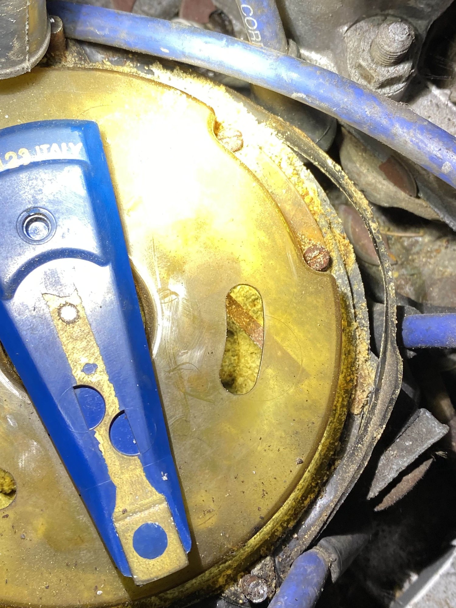

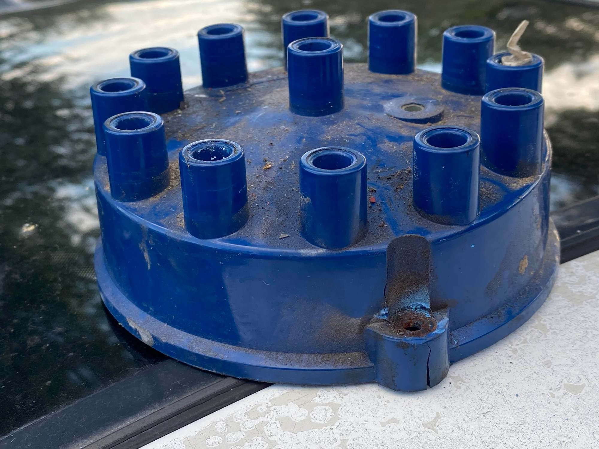

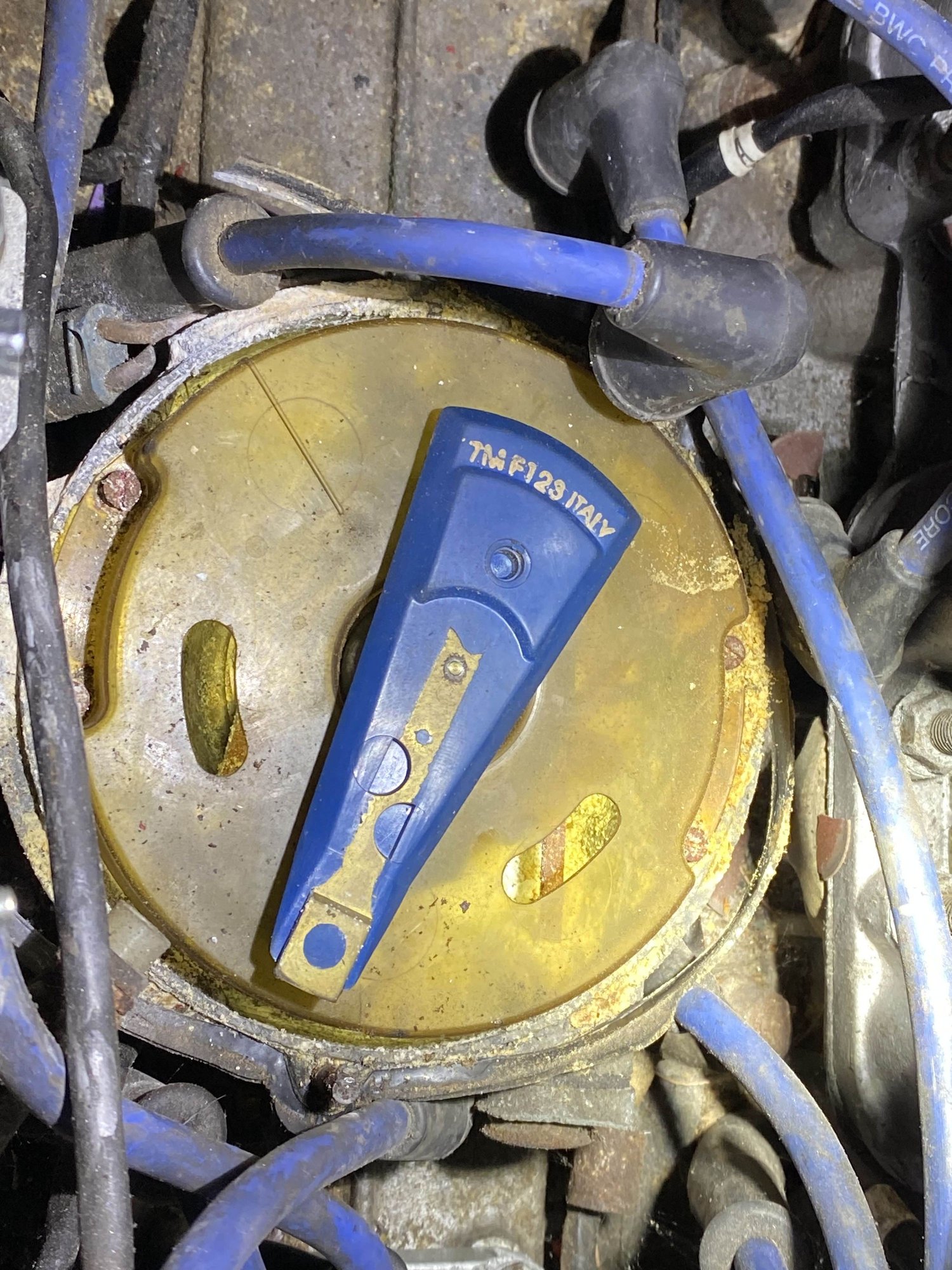

Dremeling off the screw heads finally allowed me to remove the cap. Although the pictures don't show it, I was able to remove the flash shield (via breaking the heads off of the screws that hold it) and rotor and get access to the screws that hold the distributor in (thanks for the PDFs Grant)
As expected, the distributor has corrosion welded itself to the block, so whatever refurb it gets will have to be in situ. Couldn't get it to budge upwards even with my small ~1-1.5ft pry bar. Also tried rotating it to try and free it up, and no dice, whatever timing it's at is what it's going to be at. Mechanical advance seized as expected.
The corrosion inside of the cap was much worse than expected... As you can see in the pics below, it looks like someone has had the cap off before (probably 30+ years ago), and then severely overtorqued the cap when reinstalling it. Judging by the cracks and how full of dirt they were, it certainly wasn't any time recent. I'm assuming being open to the air made the corrosion much worse than it should've been. Weirdly the contacts inside of the cap and on the rotor were in pretty good shape.

Was there a gasket present? I wonder if left out, would the screws bottom out in the threads, also let moisture in?
I see something that looks like a gasket, mine is a 1/16” thick rubber one.
Old Aug 4, 2025 | 06:07 AM
BuckleSpring's Avatar
Joined: Aug 2018
Posts: 198
Likes: 80
From: West Virginia
Yes, that's what's left of the original gasket.
I can see daylight through some of the cracks in the cap from whoever installed it before. Amazed it's ran as good as it has for the past 7 years

I already got it off w/ a dremel, didn't take as long as I expected.
Going to either try to heat and unscrew the last ~0.5" since i have access now, or maybe weld a nut to them.
The hard part now is going to be getting the mechanical advance freed up... And get the inductor wheel off.... And get the vacuum advance off.
