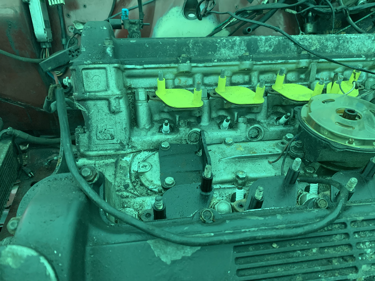

Yes I can access them. As stated earlier in the thread, I cannot remove the distributor even with a pry bar against the valley plate. It has corrosion welded itself to the block, hence why I'm trying to do all of this with the distributor in place.

Right about now I'd be pulling that valley plate - I think you are just stacking up issues persisting with trying to do things in situ

Any idea how hard it is to remove the valley plate? I've never really seen anyone on here talk about it. At a quick cursory glance, it looks like the 2 bolts nearest the distributor on A bank can't really be accessed with the upper distributor body in place

Don't recall them being that hard but you may struggle with all the other crud in the area - the biggest pain was the PZ4 (or PZ5 I can't remember) on the ends had to use an impact on those. I'm looking for a picture from the rear - sure I took one but it isn't leaping out at me.

While I have the AC Compressor out anyway, it seems like the best time to try. The entire valley is soaked in diesel/atf and has been for the past week so it shouldn't be too difficult. I'll have a go at it tomorrow or Thursday.

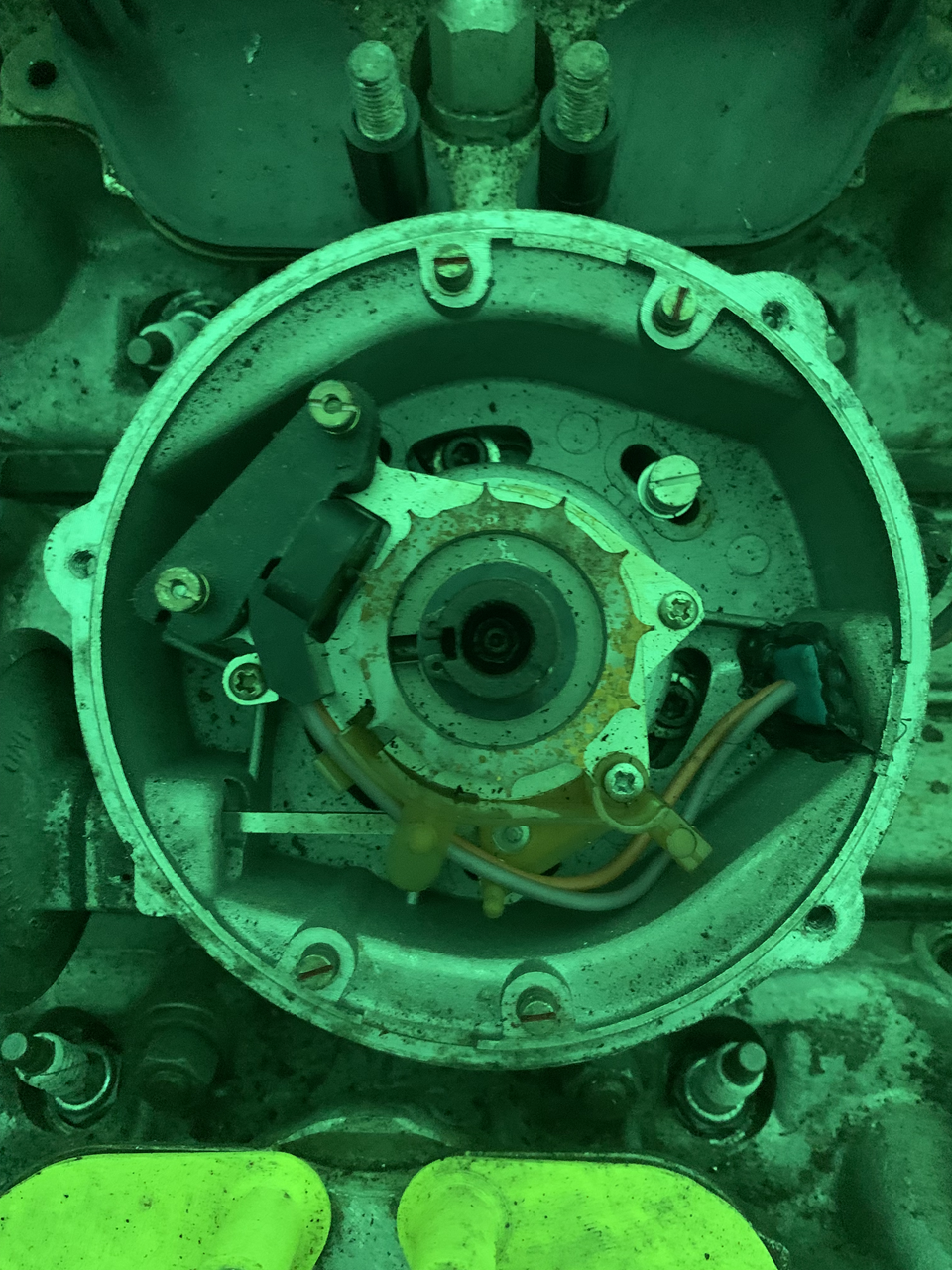

I just went out to have another look, and my mech advance has entirely freed up at this point. Travels nicely, doesn't get caught, springs back as it should... All that's left to do is the vac advance, if I could see how it was mounted to the plate, and if it's possible to remove it without removing the star wheel... I'd be done with this entire debacle.

See if this offers any clues - it is held on a peg - I do have a distributor on the shelf so could get more pics ... the vac advance actually pulls on the 'orangy' plastic and moves the plate, thus adjusting the poit where the reluctor wheel triggers.
I think the plastic just lifts off there's no clip on the vac advance I don't think - I could figure out for sure but won't be for 24 hrs ... kinda late here (UK)

I see what you're saying. On mine the orange-ish plastic piece is separate and just guides the cable for the pickup. Looks like the advance on mine is mounted to a peg on the metal plate under the plastic piece (and star wheel). I gave it a bit of a wiggle and it didn't pop off, so I'm just curious if there's a spring clip or something on the underside, don't want to break it.

Interesting thread, so it's just on a peg on the advance plate and needs to be wiggled off, easy enough. My roll pin is (mostly) out, I'd say like 85% of it is sticking out of the bottom, broken 3 punches to get to this point, just hoping I can get some small pliers on the underside and wiggle the rest out.

Yes, I removed the plastic wire guide for the pickup to get better access, and even with both hands on it, I can't get it to rotate on the shaft. Tried a couple of small flathead screwdrivers opposite each other under the wheel as well and it didn't come off before I decided to stop before I broke it.
I already got the vac advance rod off of the advance plate, so it's simply a matter of driving out the pin the rest of the way and installing the new one.
