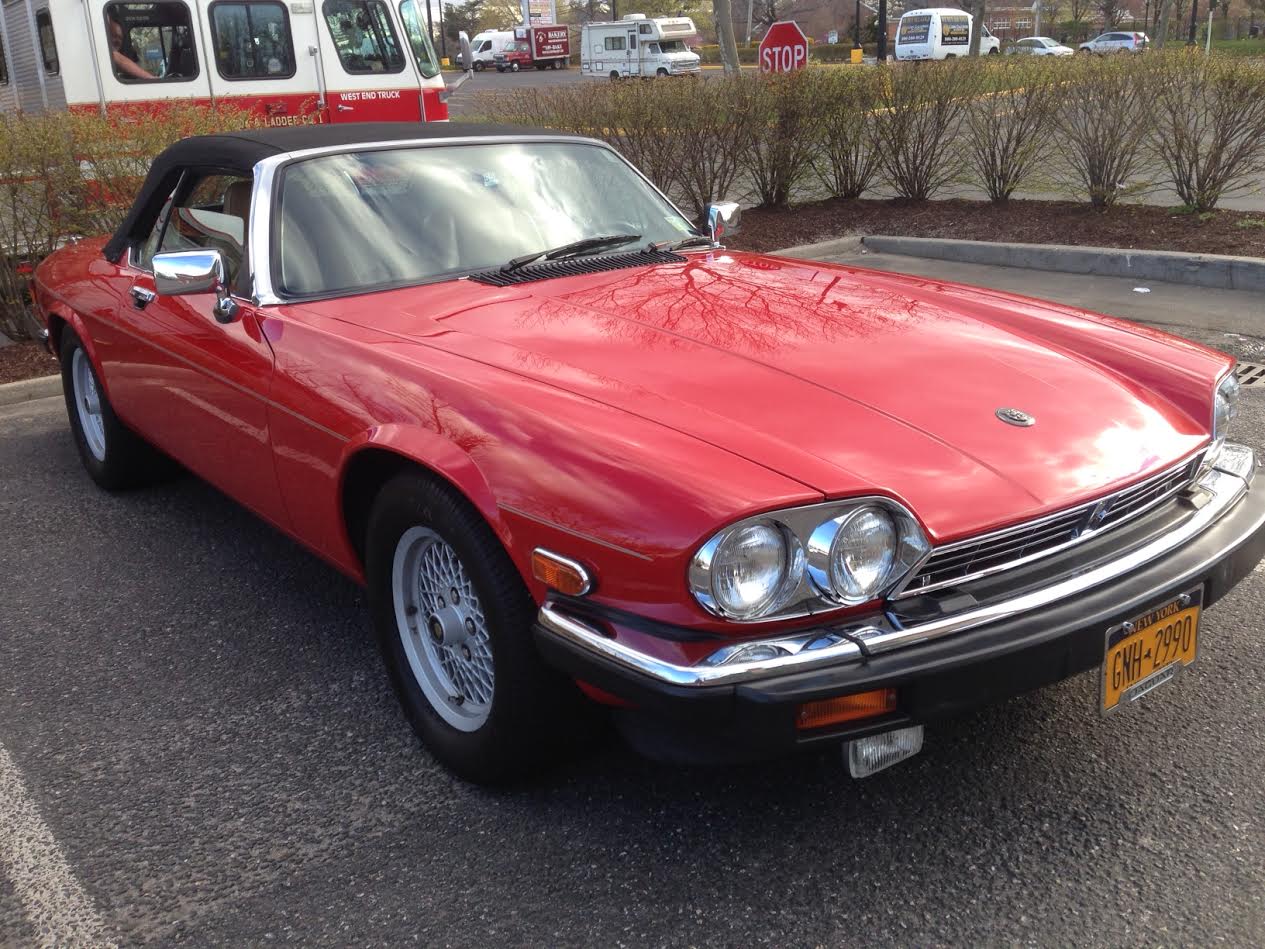

1989 Jaguar XJS V12, with Lucas. Have been doing research on manual conversion. Know The Driven Man has a kit. Know some others use a Toyota Supra Transmission. Looking advice on best route to go. What are some of the snags, and try and get a best estimate on total cost. My car only has 40k miles so still a lot of life left. A summer weekend driver.

I think you will do the car justice with the gearbox swap, Sorry can not help you with the ones advertised, but here in Aus we can source the conversion from Dellows in Sydney. I have spoken to them and they recommend a T5 from one of the ford 6 cylinder turbo's the spline length is perfect and the shifter comes in the correct place, also its ratios are a little higher which work better with our low ratio diff. You can pickup a complete peddle box of Ebay at a good price, that's where I found mine.
