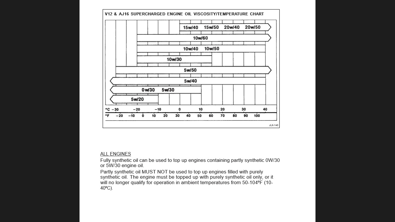

This may be the chart 86jag was speaking of.
Attached Thumbnails Oil Pressure Using Lower Viscosity Oil (XJS V12)-viscosity.jpg
Hi Bill
That was very useful, so Thank You for putting that up.
