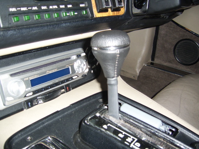

Mmmmm, sounds like an XJ40 style, just like mine is NOW, WAS the traditional "T" style which I hated, and YES, it should just screw off in a counter clockwise direction, unless some deviate JB welded it in place???.

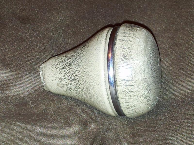

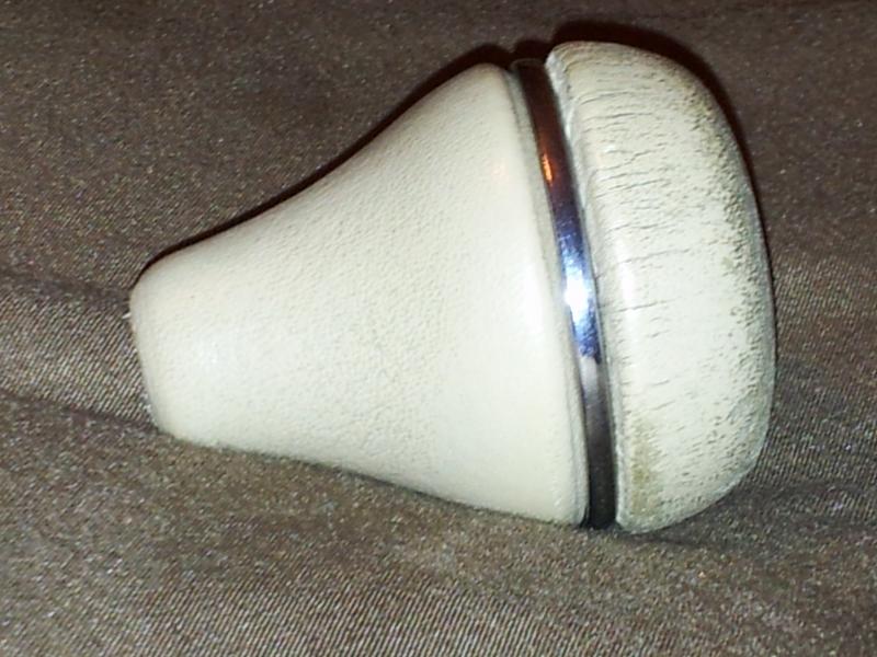

OK, got the knob off, it rotated counterclockwise after a little coaxing. Gave it a good going over with a leather cleaner/conditioner, and it looks 100% better. The top is still worn, but at least everything is clean again. May still get a wood replacement, some of them are quite sharp looking and I've told my wife they make a great Father's Day gift... %^)
Attached Thumbnails Shift Knob Removal-xjsknobsideclean.jpg   Shift Knob Removal-xjsknobsidedirty.jpg

I had a spare gearlever bit, some car, S2 XJ6 I think, and not liking the "T" thingy in the XJ-S at all, and having a spare XJ40 gear knob in the box of "stuff", I set about attaching said knob (round threaded hole) to a chrome spindly lever. which is "unround".
I sat in the car with the gear knob in hand, and held it at about the hieght I reckon it should be, and marked the point on the installed lever. Then transposed that to the spare lever, and cut the top bit off.
Much J Daniels later, a bolt that actually threaded INTO the knob was located, and the bolt was welded to the cut lever. That made a mess of the chrome, damn, so I slid some black "heatshrink" over the lot, and shrunk it with the heat gun, fitted it to the car, spun the knob on, sat back and drank some more, coz that one actually WORKED. That was 10 yeras ago I think.
