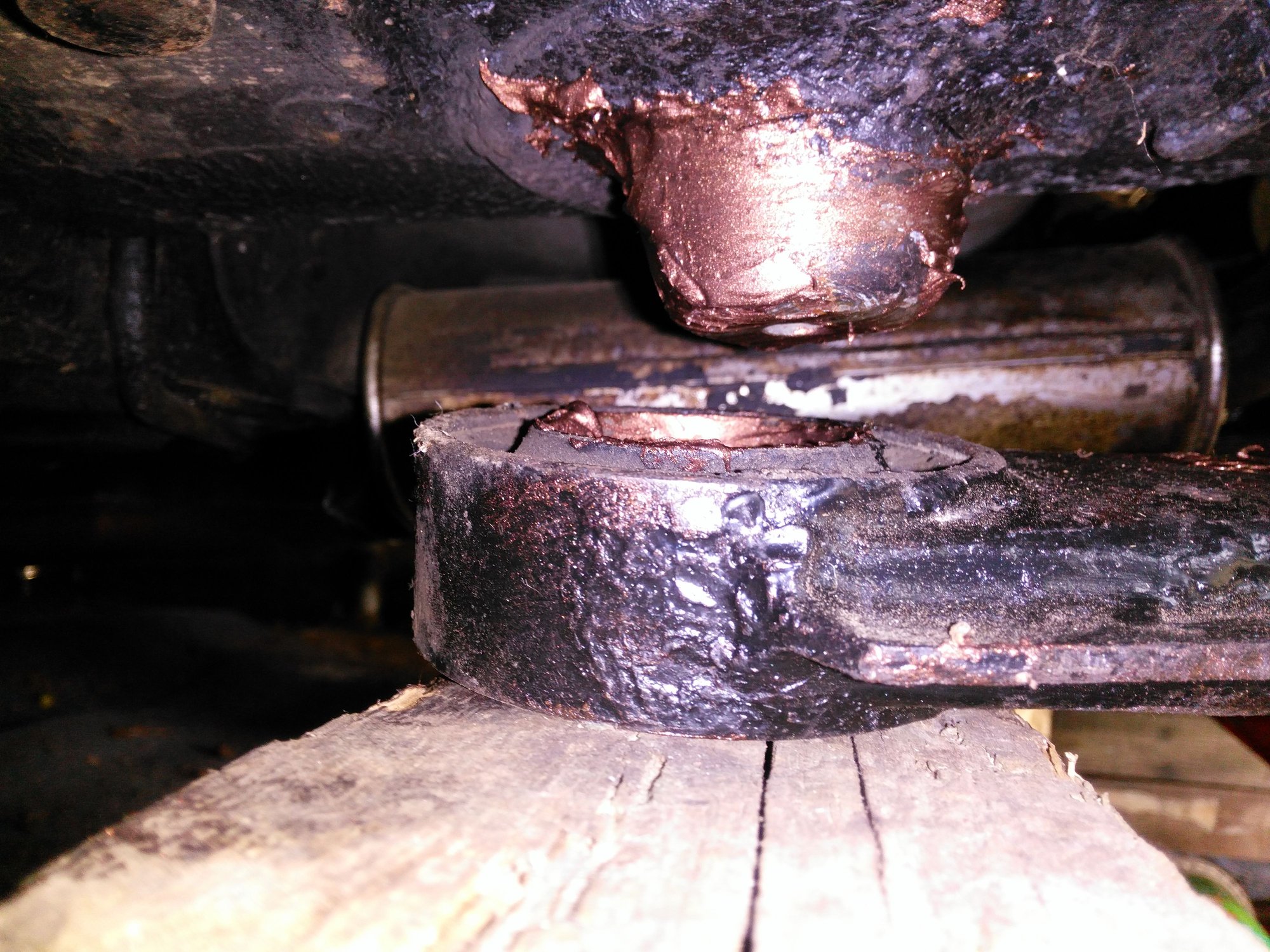

With the Finishing Post in sight things seemed to be going a bit too well for my liking as with everything done and dusted except for connecting the Speedo, it was time to clear all of the Spanners and other stuff out of the way and then lower her down to connect the Big Bush of the Trailing Arms to their Spigots and then put the Wheels on
At which point I've run into the only major problem that I've had so far, so need help from you more experienced guys who have been there and done it
The problem being the Big Bushes of the Trailing Arms are too far Forward to go onto their Spigots, where at this stage of the game I don't want to break anything and I have also lubed them with a Ton of Copper Grease
So any ideas as to what I should do?

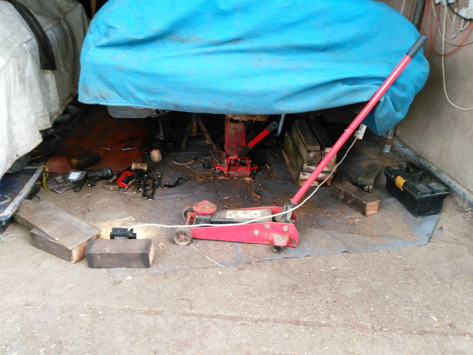

First Job clear all the Spanners and other stuff out of the way

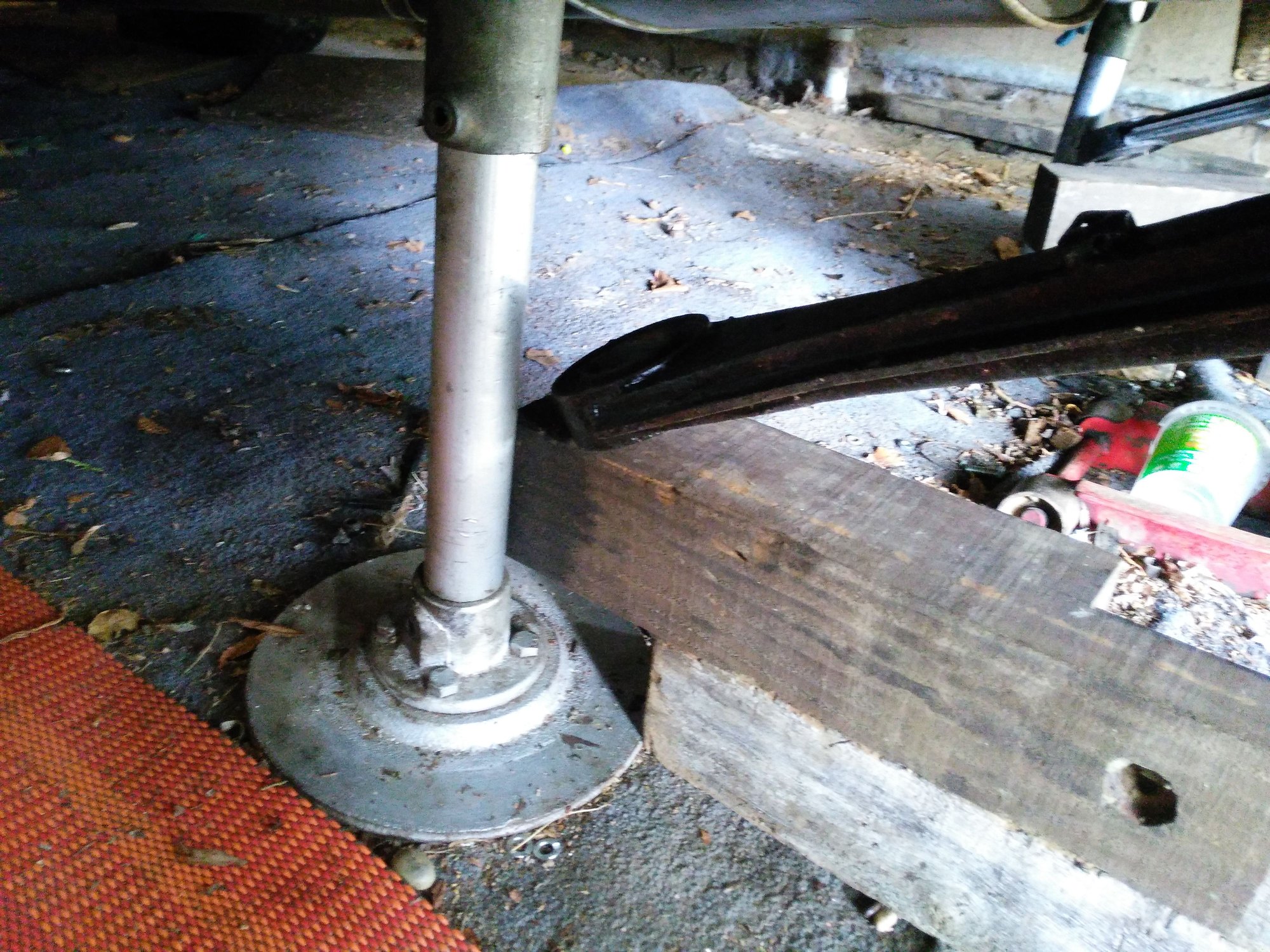

Supporting the Trailing Arm on a Block so it doesn't dig into the ground when I let the Car down
Problem! Big Bush of the Trailing Arm won't go back on the Spigot

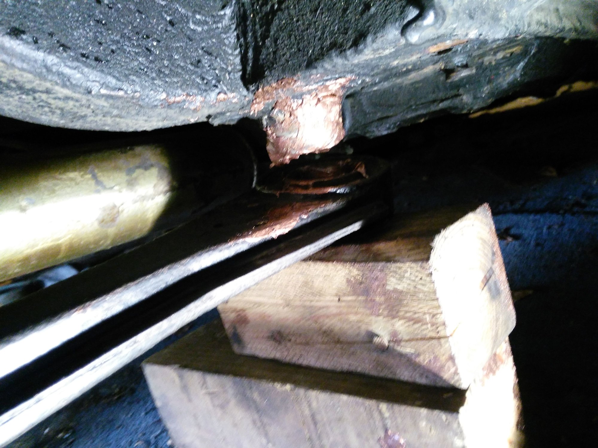

This ones even more out of line than the First one! (Help Needed Please)

OB
try this:
Set the car on its wheels, this should locate the cage better and it should rock backwards. Then even if the cups are a tiny bit unaligned, just jack under the arm bush and it will clonk on; then remove the jack and put in the bolt.
