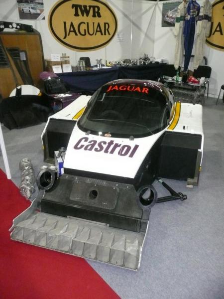

You wanted to see what a decent exhaust looked like
Attached Thumbnails so has anyone actually made 500bhp from a v12 pre.he-1-xjr5006-137318-albums-garage-xjr12-290-7334-picture-you-wanted-see-what-decent-exhaust-set-up-.jpg

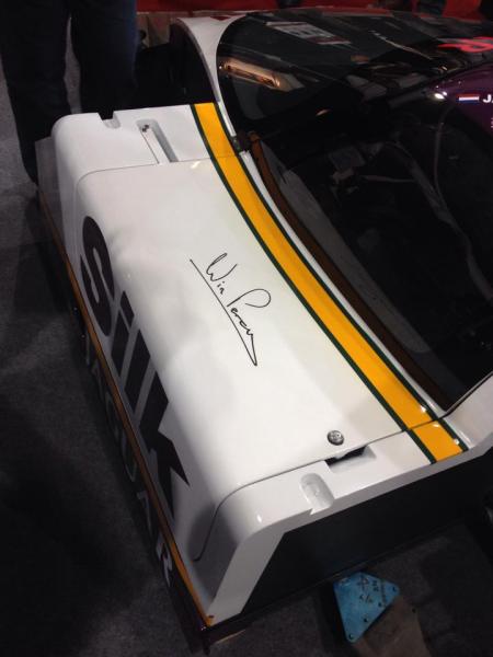

My new project, just 3 weeks out of the mold
Attached Thumbnails so has anyone actually made 500bhp from a v12 pre.he-xjr5006-137318-albums-garage-xjr12-290-7334-picture-my-new-project-just-3-weeks-out-mold-25634.jpg
