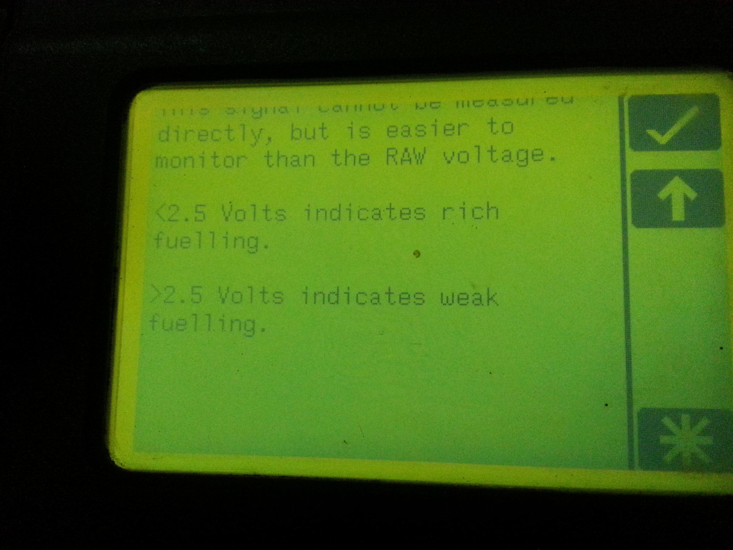

Default Play with engine coolant sensor
ECT is not very sensetive.
first picks is normal mode. 90' (194F) air 57' (134F)
second is manualy droped to 77' (177F), No effect on the lambda.
if I fall below 77' , check engine is coming.
Attached Thumbnails so has anyone actually made 500bhp from a v12 pre.he-2014-06-12-15.47.07.jpg   so has anyone actually made 500bhp from a v12 pre.he-2014-06-12-16.38.10.jpg
