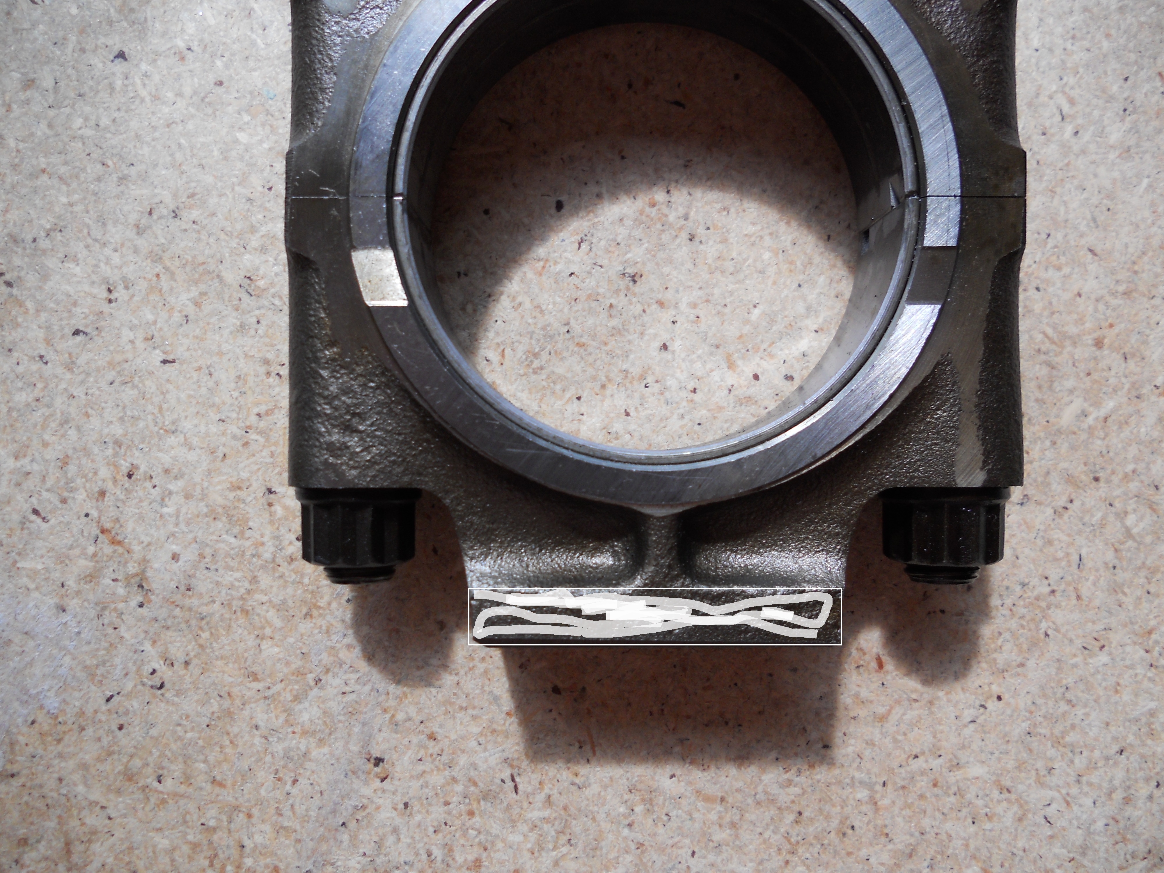

I was advised by a very experienced engine builder not to completely remove the pad on the bottom of the rod.
Just remove the bottom bit of the pad see pic
