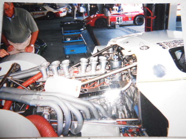

coup[e pix of Bob Tullius car,XJR5 slider inlets, and his XJS 1977, won many races in TRans-Am. WOW 8000 revs in 1977! helps to hang around the Daytona track .
you will have to rotate specs pic, things have sure changed ,but shows 44 was on the right path, but politics get into the way of progress!
Attached Thumbnails so has anyone actually made 500bhp from a v12 pre.he-002.jpg

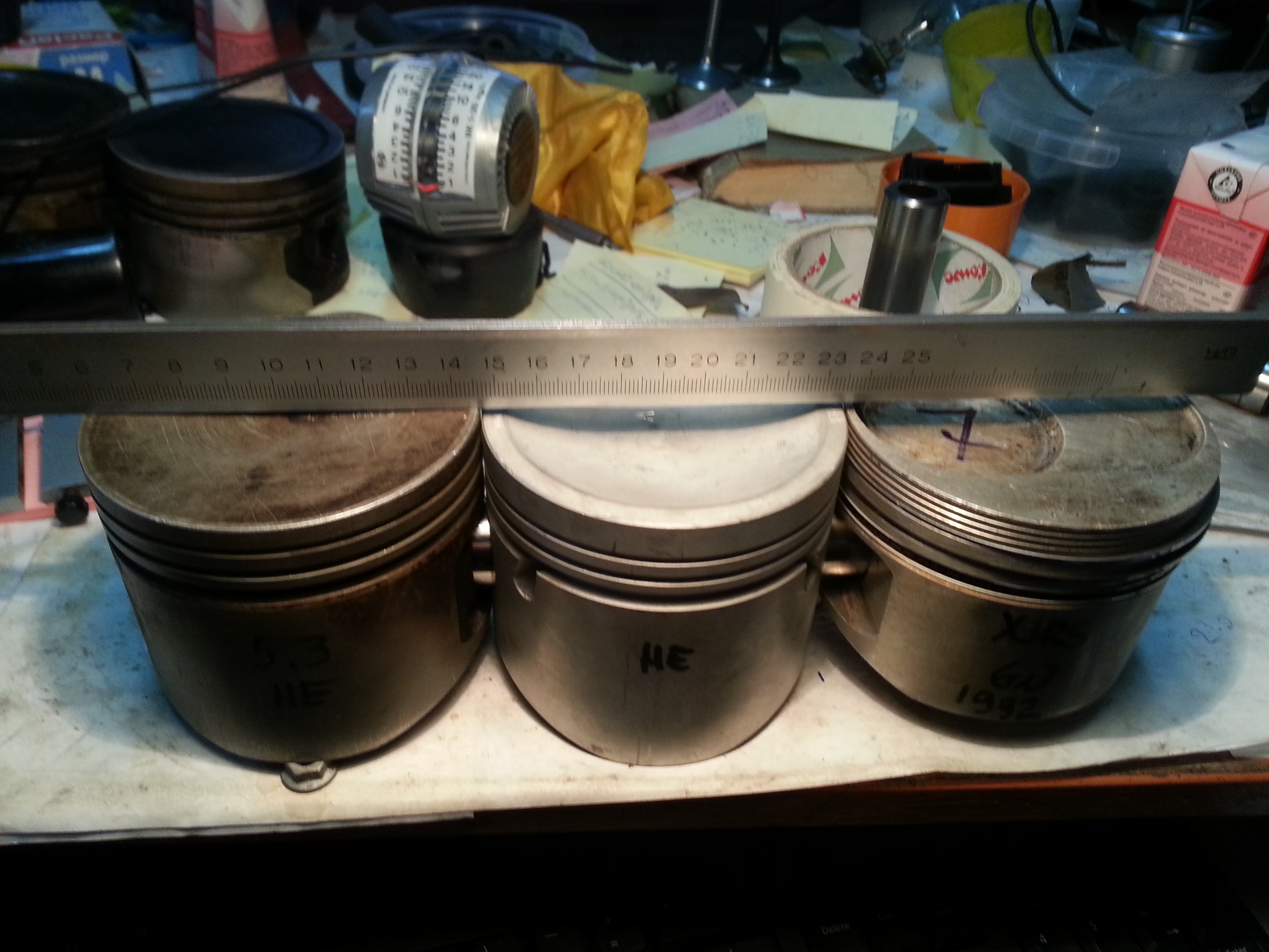

I was wrong with the dimensions of the pistons
Originally Posted by xjr5006
I dont know if the XJR6 pistons will work,
Attached Thumbnails so has anyone actually made 500bhp from a v12 pre.he-20151113_155213.jpg

That's an interesting photo. It appears that the XJRS piston is actually shorter (from the wrist pin up to the piston top) than the 5.3, indicating a possible lower compression ration in the XJRS.
Can you post a photo of just the 5.3 and the XJRS pistons connected with a wrist pin, and your scale laying across the top?
Yes of course, tomorrow. And add pre HE

You need to remember that the XJR-s piston is for a 78 crank so would be 4mm shorter in height
Old Nov 19, 2015 | 05:28 PM
  #517
JagZilla's Avatar
Posts: 835
Likes: 298
From: Mississippi
You're so right. I had forgotten about the increased stroke of the XJRS. I wonder what the CR would be if you put those in a 5.3...thinking along the lines of the recent post regarding using pre-H.E. pistons in an H.E. for purposes of forced induction.

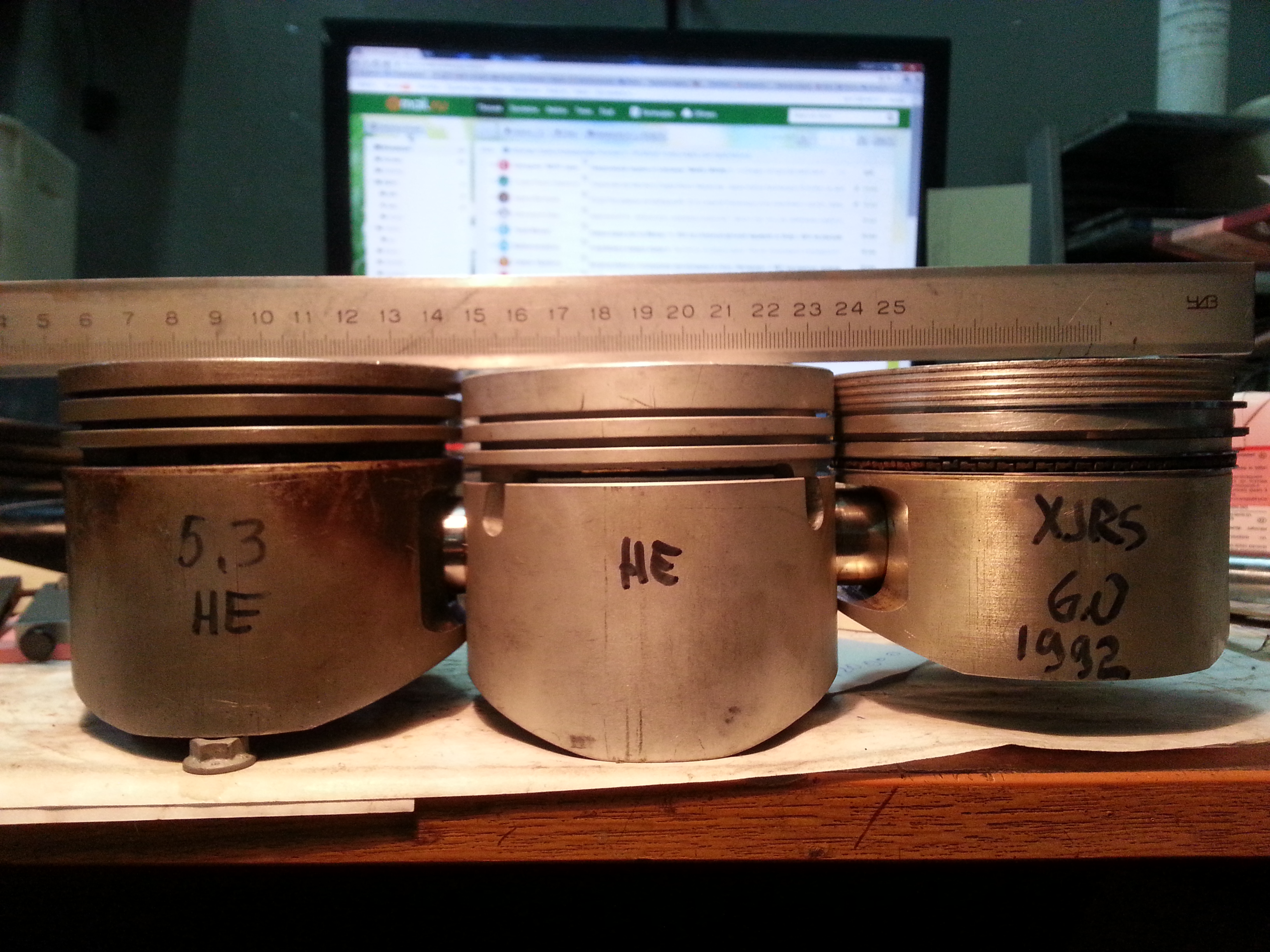

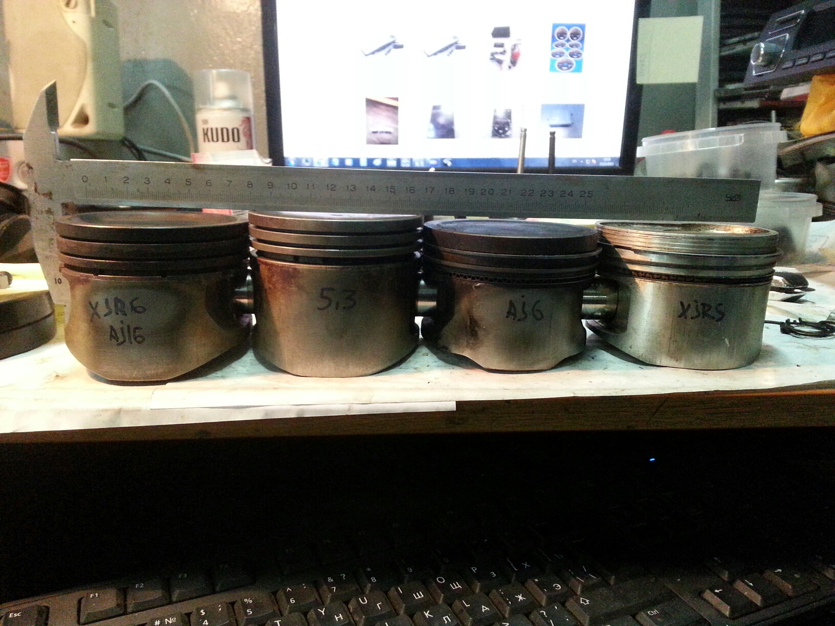

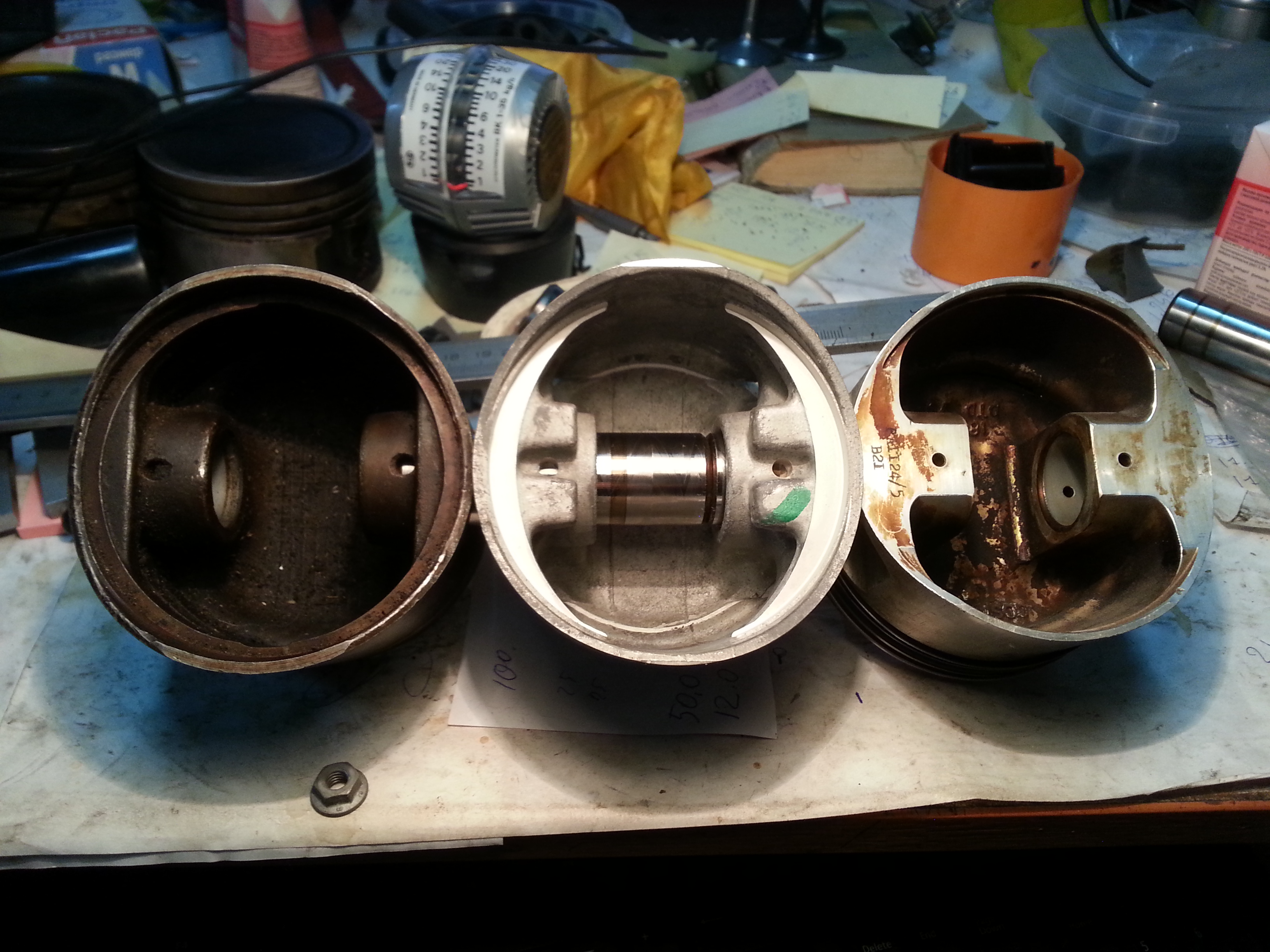

XJRS's piston looks like forget
Attached Thumbnails so has anyone actually made 500bhp from a v12 pre.he-20151120_100851.jpg   so has anyone actually made 500bhp from a v12 pre.he-20151120_100910.jpg   so has anyone actually made 500bhp from a v12 pre.he-20151120_100946.jpg
Thanks Nikolay,
Those are VERY informative photos.
Yes, the XJRS piston does look to be forged.
If it actually IS forged, and if it can get the compression ratio of a stock H.E. motor down to around 7, or 7.5, it would seem to be a perfect choice for large amounts of forced induction on a 5.3. Although I'm not sure how difficult it may be to find a set.
