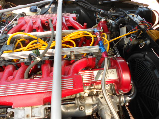

so has anyone actually made 500bhp from a v12 pre.he
I am a restoring a Jag XJ12 Series One. Probably a bad idea but I have always liked the car and I have restored a few cars so I have some idea of what I am getting into. My unrestored car on 4 carbs is probably making about 200hp so I too would like to get towards the magic number. A solid 400hp would do me fine. However, after having read this thread I did the basic math for the Jag V12 Brake Specific Fuel Consumption - the number that is possible based on the energy in the fuel not the way the engine is put together and it comes in at around 380hp. Are people running larger injectors? If so what size? I would like to know what is mathematically possible before I start shovelling money in. I am going down the throttle body Motec route with the engine build.
Not a bad idea. These cars are wonderful especially the V12.
TWR managed 330hp from a road going 5.3HE with only exhaust and intake mods, they bolted the GRPA exhaust manifolds and downpipes and CAI from OTR and K&N air filter.
The 5.3L needs to rev to make power (or turbo), if you can stretch to stroking the V12 with the same mods 380-400hp is doable in HE. But with a big increase in power across the entire RPM band.
I was just re-reading Allan Scotts book, as I am in the process of building my spare engine to 6.7L. Anyway one thing I noted he wrote was the 5.3L needed smaller intake runners for the street, but the 6.0L worked really well with the stock intake.
Cheap V12 engines come up from time to time and buying a fuel injected one will give you all the FI bits to ditch the carbys.
Those carby manifolds were woeful. You could cut the carby mount off and braze a 100x100 aluminium box section to make a plenum and use Commodore TB's on the front. You could use Commodore injectors and 2 DFI units to run dissyless. Just thinking outside the square.

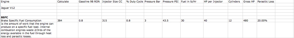

Standard HE injectors are 18.25lb 192cc,
Commodore Supercharged injectors are 370cc these will work.
Ron's right TWR only just got to 500hp from the race car before the end of its life. If you want to make power from the V12 I would suggest buying Allan Scott's book there is a lot of technical information in there about the R&D on the race car (and the TWR road XJS) that can be used to build an engine.

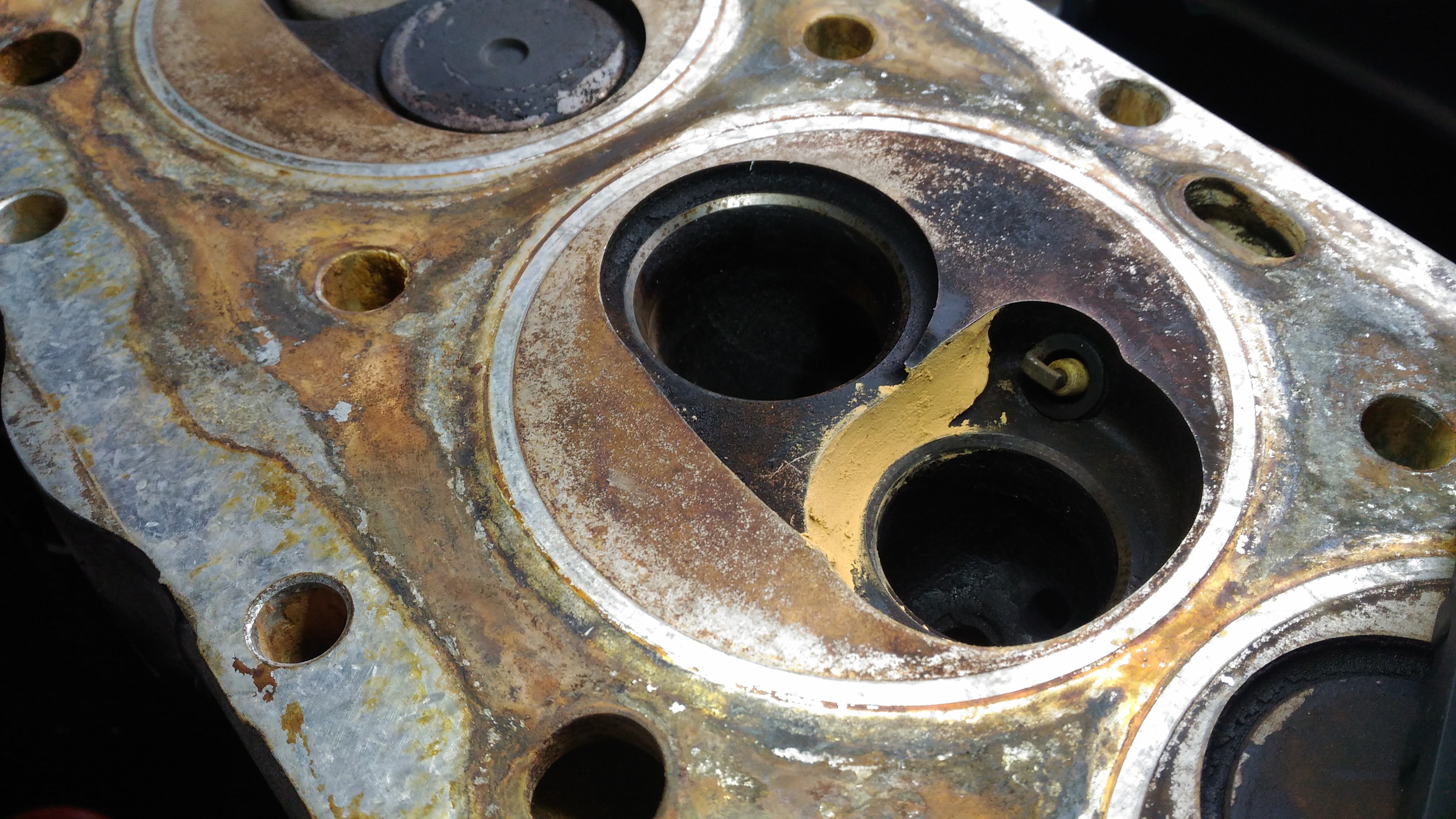

Had some down time today. So I thought I would get my 6.0L heads and look at the flow through the exhaust valve/port. I was not interested in CFM all I was looking at was turbulence and how it could be reduced. A reduction in turbulence will naturally increase flow anyway.
I lifted the valve to 9.5mm, 0.375".
The first 2 pics show the thread vibrating considerably. In the next pic I smoothed the flow into the seat with some water based wood filler. You can see the difference in the 3rd pic where the thread is rock still, indicating no turbulence. The last pic there is still some turbulence but its much less than pic 2. I think if the lip circled in red was profiled then the turbulence would be further reduced.
Warrjon, interesting work!
by looking at that chamber shape, what if it were possible to shave the head around .100 thousandths,(around 2.5MM) would it not put the inlet valve deeper into the bore, and reduce a lot of that shrouding metal around the exhaust valve?
altho it may bring up cylinder head thickness, also chain tension, and how thick is the deck surface?
but along with your chamber mods, just may get that hi turbulence thing to work!
you say someone is rebuilding your engine , just may hold off on piston selection until you are sure,of compression numbers and piston to valve clearences!
i chopped .050 thou. off my heads pre-HE, with no ill effects just to get the valves deeper into the bore!
also that turbulence is there to control detonation along with full use of the burning fuel! you may not worry about MPG, but NOT be nice to have detonation while just driving at light cruise!
just some thoughts on the subject!
WOW this is the worst thing I have seen since I polished my first valve....
I did it all wrong...
so much design has to go into tumble and swirl and when you start messing with things like this even though a smooth flow is great for moving air over external surfaces you are now in a confined resonate chamber...
now I know there are design short comings limiting the V.E. of our HE heads ... but Smoothing out the FLOW right there might counter intuitively reduce drivability and greatly increase the fuel demand.... might as well go to pre HE HEADS....
My engine builder is Norman Lutz who has a world of V12 experience and has built an 800hp NA V12. He is using Chevy 305 KB pistons with very thick crowns the ability to machine some off the top to adjust clearance to 1.3mm. This will also reduce the crevice volume to advantage.
Laying the chamber walls back to open the path for exhaust. Funny you mention planing the head to the intake valve I was originally against this but might just re-consider it.
I have not seen inside a pre-HE exhaust port but the HE has a very sharp short side turn, seats on both intake and exhaust are better than most stock SBC I have seen.
I have a lot of experience in Flow measurement having worked in a Military Calibration laboratory, lets hope I can put some of this knowledge into improving the HE head somewhat.
I have some clear acrylic which I plan to make a transparent cylinder so I can see if there is any port induced swirl. I will be concentrating on low to mid flow on my homemade flowbench.
I think the biggest challenge in starting with a stock head is keeping CR up unless the capacity is increased. When you look at the HE heads, it seems Jaguar just took the flat head and machined a pocket. This has sharpened the short side radius on the exhaust. I am not sure if this is where the power is lost as my understanding most of the power comes from the Inlet port. If the exhaust port is restricted it will provide pumping losses and cost torque.
