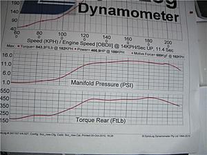

[SOLD - JAGUAR 1977 XJS V12 TWIN TURBO Race car - CAMS LOG BOOK - JAGworks
Hi Warren if I’m reading this right the stock 5.3 lasted a day on the race track and was replaced with a AUD35,000 dollar 5.3 which made 550lbs per the advert and 543Lbs and 467hp at the rear wheels per the dyno chart. The 6.7 was making 610hp before it spun a bearing.
Turbos are certainly interesting and legal in oz on a 5.3 but I’m not sure they offer the best bang for $ and wouldn’t cause hear issues.
QUOTE=warrjon;1798193]When Bruce's 6.7L twin turbo race car spun a bearing he ripped it out and installed an old stock 5.3L he had lying around running 15psi around 600HP and it lived a few race meetings before being pulled and rebuilt.
The turbos fit easily where the air cleaners are, and you can run stick manifolds upside down[/QUOTE]

The engine was still running after the weekend the think rings seized, as the engine had been sat for a long time. I think if he'd pulled the engine and replaced the rings it would have lasted longer. I meant to say a few races not meetings. Have you seen Bruce drive, he is pretty hard on the car, he broke a Jerico dog box with the 6.7L, actually blew a hole in the side of the case.
I was going buy his long stoke crank but the engine was a rope seal and mine is a 1 piece lip seal.
467 rwhp is about 560 at the flywheel, Norm has got 610hp from a 6.0L NA, although I do know that the torque the turbo engine made was phenomenal. I saw him come out of pit lane at Eastern Creek and light up a set of warm 300mm slicks like a V8 Supercar.
