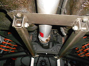

Originally Posted by warrjon
The engine was still running after the weekend the think rings seized, as the engine had been sat for a long time. I think if he'd pulled the engine and replaced the rings it would have lasted longer. I meant to say a few races not meetings. Have you seen Bruce drive, he is pretty hard on the car, he broke a Jerico dog box with the 6.7L, actually blew a hole in the side of the case.
I was going buy his long stoke crank but the engine was a rope seal and mine is a 1 piece lip seal.
467 rwhp is about 560 at the flywheel, Norm has got 610hp from a 6.0L NA, although I do know that the torque the turbo engine made was phenomenal. I saw him come out of pit lane at Eastern Creek and light up a set of warm 300mm slicks like a V8 Supercar.
If you do this type of HP/Tq and traction you will need to strengthen the rear end. The TT XJS race car had the rear cage braced to the boot floor and the boot floor was warped from the twisting of the rear end. You would need to brace forward to the chassis rails.
right on warrjon , hi torque can actually start to tear the car body/suspension apart, bending and twisting many things, i try to use tires that break loose with less traction , my XJS has 295-35-18 on the rears, and just stepping on the gas at 10mph they go up in smoke!! but is saves the drive line components, and i have spent some time on it ,using my own ideas.
pic notice the drive shaft offset into the rear Dana 44 diff, not good for smooth hard power applications, thats Jag factory engineering, but British were never into hard torque acceleration.
It is done like for a reason, if 2 uni joints are lined up there is a chance they can lock if the total inclined angle exceeds X° specified by the U-joint manufacturer. When I did my 4L60e swap I found that the transmission and diff yoke were lined up on the vertical plane (up and down) so the pinion angle is left to right.
This also offsets the pinion so the axles are equal length providing equal torque to each wheel.
thats what i thought for past 50yrs, but recent testing from some of the racing communities says the best way is from engine crankshaft to the pinion should be exactly lined up both pinion offset side to side and pinion angle,up and down.
they found when driveshafts get broken its from torque being applied at an angle, and shafts twist and break!
for us old fashioned guys it makes some sense both ways,, but have no fear i aint changing things at this time, i'm not after every last detail of some theory.

info in LSX magazine, pinion offset by Chassis Engineering.com

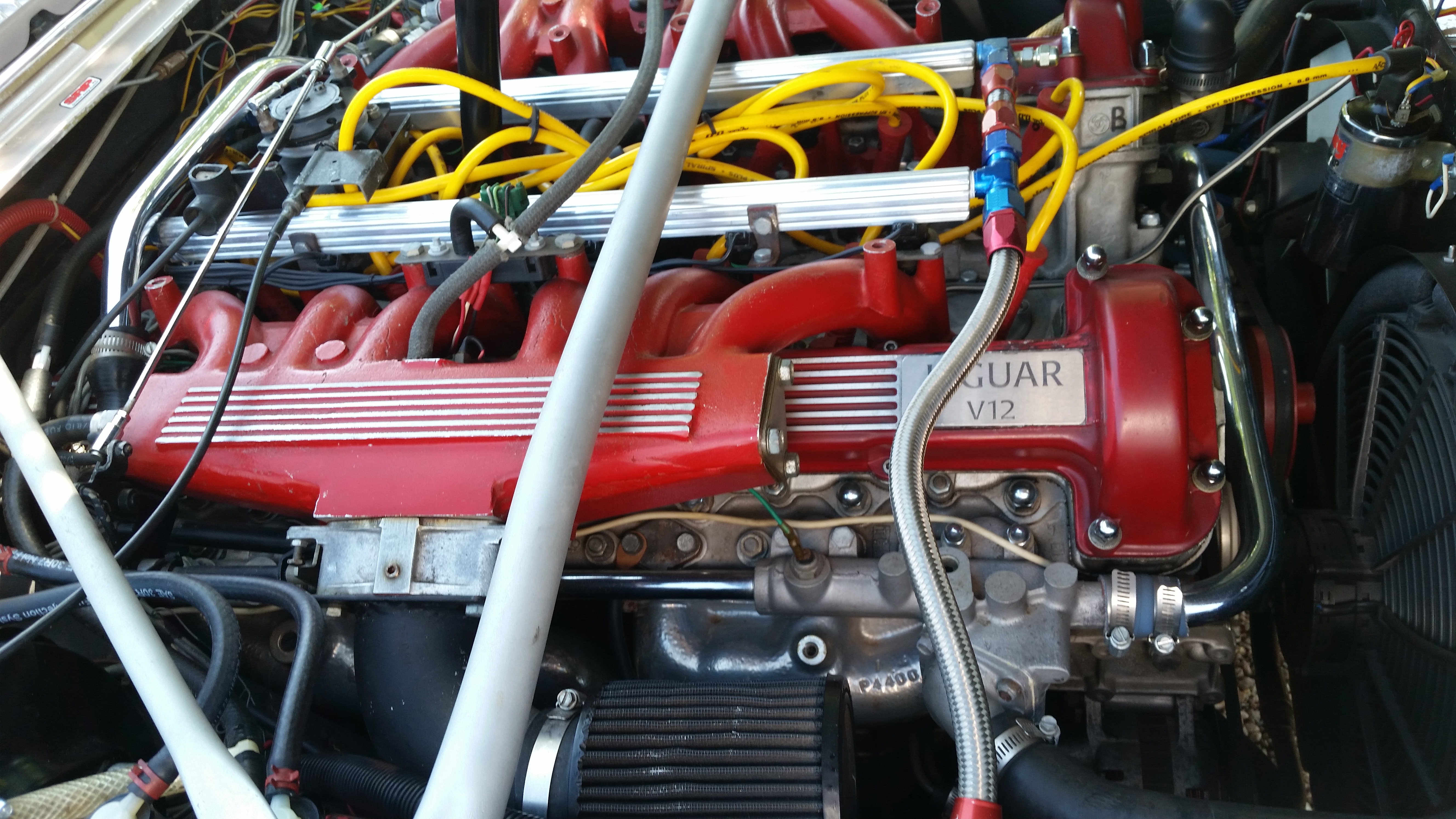

course time will tell.
are you sure they are 9-1 pistons, they maybe 7.8 ratio? or did you install the 9-1 pistons?
factory testing show around a 10/12 hp difference (7.8 lower). i bought from WELSH JAG, a set of 9-1 pistons. i tried for some 10-1s but unobtainium ,actual test showed 20hp over 7.8s.
who reground your cams?
i have race cams ground by Crane (Daytona FLA.), close to what you have 5.3 pre-HE.
282 duration, .410 lift(i slightly modded lash its around .400 now ,low end was rough idle, and i did pickup more bottom end torque and smoother drivaibiity.
dyno has torque peak around 4500 rpm, will run out to 6500/6700 rpm , will go 7000, but aint pullin just revin!
some thoughts on all runner lenths equal say has a sharp torque peak, unequal says lentgh strechs it out further,altho slightly lower peak! DAMIFINO.
i deffinatly agree with a custom aftermarket ECU for complete MAP adjustability.
i use SDSEFI for mine, love it, and could not go without it!
about the aluminum welding, some say that Jag at that time ,was using recycled trash aluminum, heavens knows what maybe in it?
there was a big fiasco with HD(Harley D), on there aluminum heads back a few yrs.
who knows the truth , i got the story from guy who worked in HD foundries, lotta hush hush over it!
ron

question; do you think it'll make 500HP ???
ron
