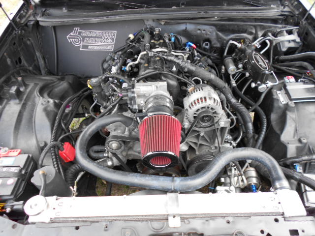

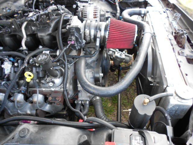

quick pix of my Buick GN converted to an LS 6.0L, iron block , aluminum heads #317. drive by wire TB.
and 4L80E trans. nice setup , Gn's light weight, and perfect 3.42 LSD.
would be great with turbo system, those LS engines are MAGIC with forced induction!
Attached Thumbnails so has anyone actually made 500bhp from a v12 pre.he-buick-cute-dogs-015.jpg   so has anyone actually made 500bhp from a v12 pre.he-buick-cute-dogs-010.jpg   so has anyone actually made 500bhp from a v12 pre.he-buick-cute-dogs-013.jpg   so has anyone actually made 500bhp from a v12 pre.he-buick-cute-dogs-012.jpg
