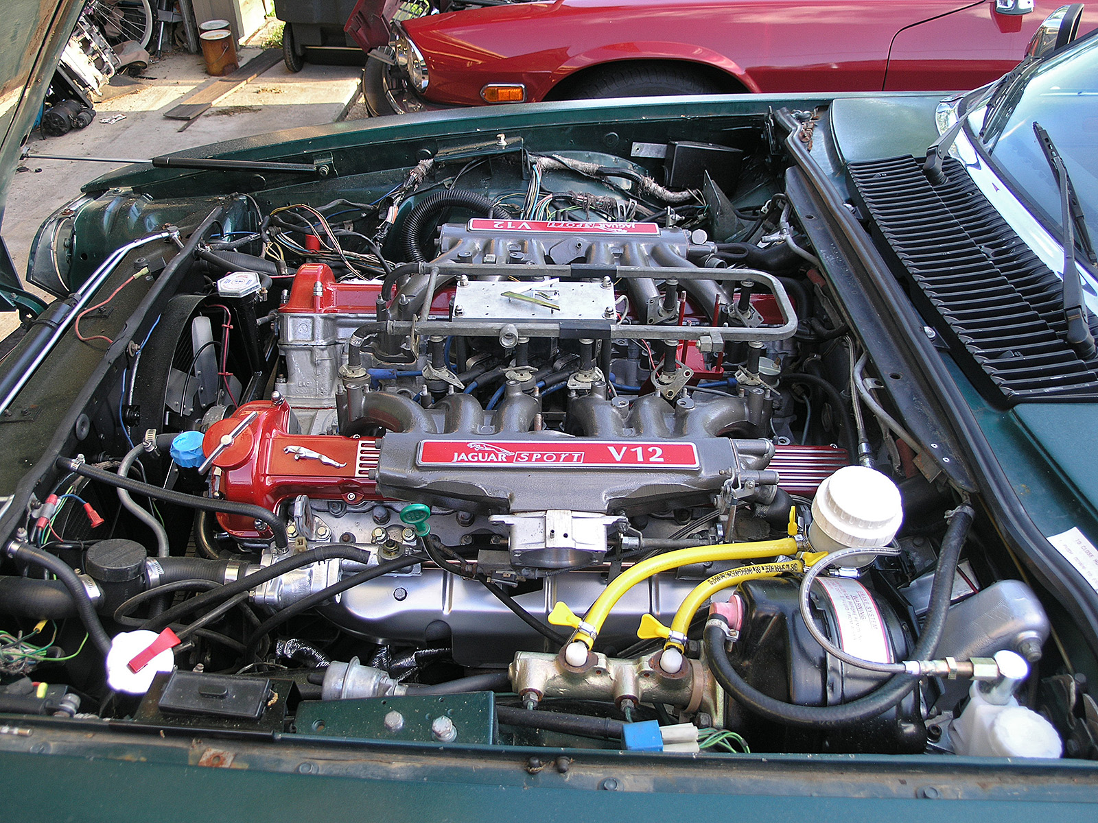

what is the mitsubishi resivoir look like and what year or model?
Old Nov 23, 2013 | 07:55 PM
JagZilla's Avatar
Posts: 835
Likes: 298
From: Mississippi
Ron,
Here is a shot of my engine bay. You can see the Mitsubishi brake reservoir in the lower right foreground of the photo. Seems that mine was off a mid 90s Eclipse.
This was just a photo I had on my laptop. If you wish, I can get a more specific shot of it tomorrow.

I want to see this Mitsubishi reservoir, too! Are there provisions for the low brake light switch?

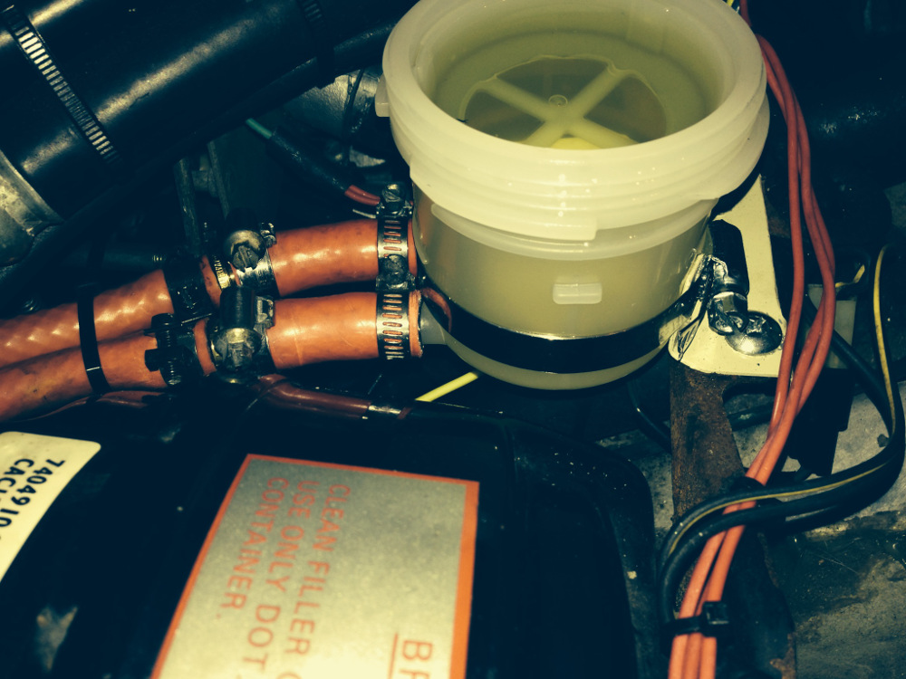

Find below a photo of my installation. I pretty much just followed what Palm said, at it was pretty easy.
I used a Dremel tool to cut out the bracket then bent it in the appropriate places and painted it.
I found two brass reducers the drop the hose size from the 10mm of the Mitsubishi reservoir to whatever size (can't remember at the moment) the hoses are on the car. I used air hose line.
I cut the wiring and spade terminals out of the top of the OEM part and just plugged them into the wiring on the new reservoir.
Oh, I took the photo with the cap off because the cap is so blinding white that it screws up the photo. I'll probably paint the cap as it looks funky being the only snow white thing in the engine compartment.
Cheers,
John
1987 XJS-V12
63,000 miles
