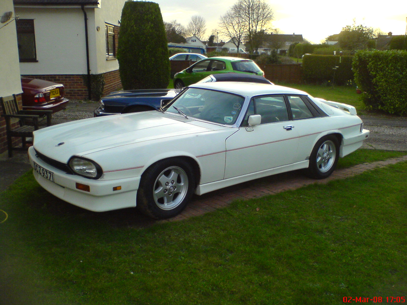

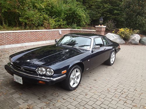

Pre-face lift XJS' with 5 spoke wheels are rare, yet you find a large number of them with very modern looking wheels.
I saw two pre-face lift cars with 5-spokes wheels, of which one has the TWR kit on it. Funny that there seem to be more pre-face lift estates with 5-spoke wheels rather than cars. For you to compare, I'm attaching pics of two cars and two Estates with these wheels. I absolutely respect your opinion and I only want to mention that I do find that these pictures do not show any bad mixture of Ancient and Modern that I can see, but more pictures help by giving you more info regarding your kitty's potential future looks.
And, just for your reference, I'm also attaching a beautiful dark blue pre-face lift coupe with the XK8 17" Revolvers and this one, too, looks really nice with no conflict of old and new, really, and not really different from what my own '94 chromed ones look.
Cheers,
Attached Thumbnails Speedo Reading with 16 inch Wheels-1989-xjs-5spoke-wheels.jpg   Speedo Reading with 16 inch Wheels-69-v12-twrkit.jpg   Speedo Reading with 16 inch Wheels-prefacelift-xjs-estate-5-spokes.jpg   Speedo Reading with 16 inch Wheels-1982-estate-5-spokes.jpg   Speedo Reading with 16 inch Wheels-dark-blue-coupe.jpg

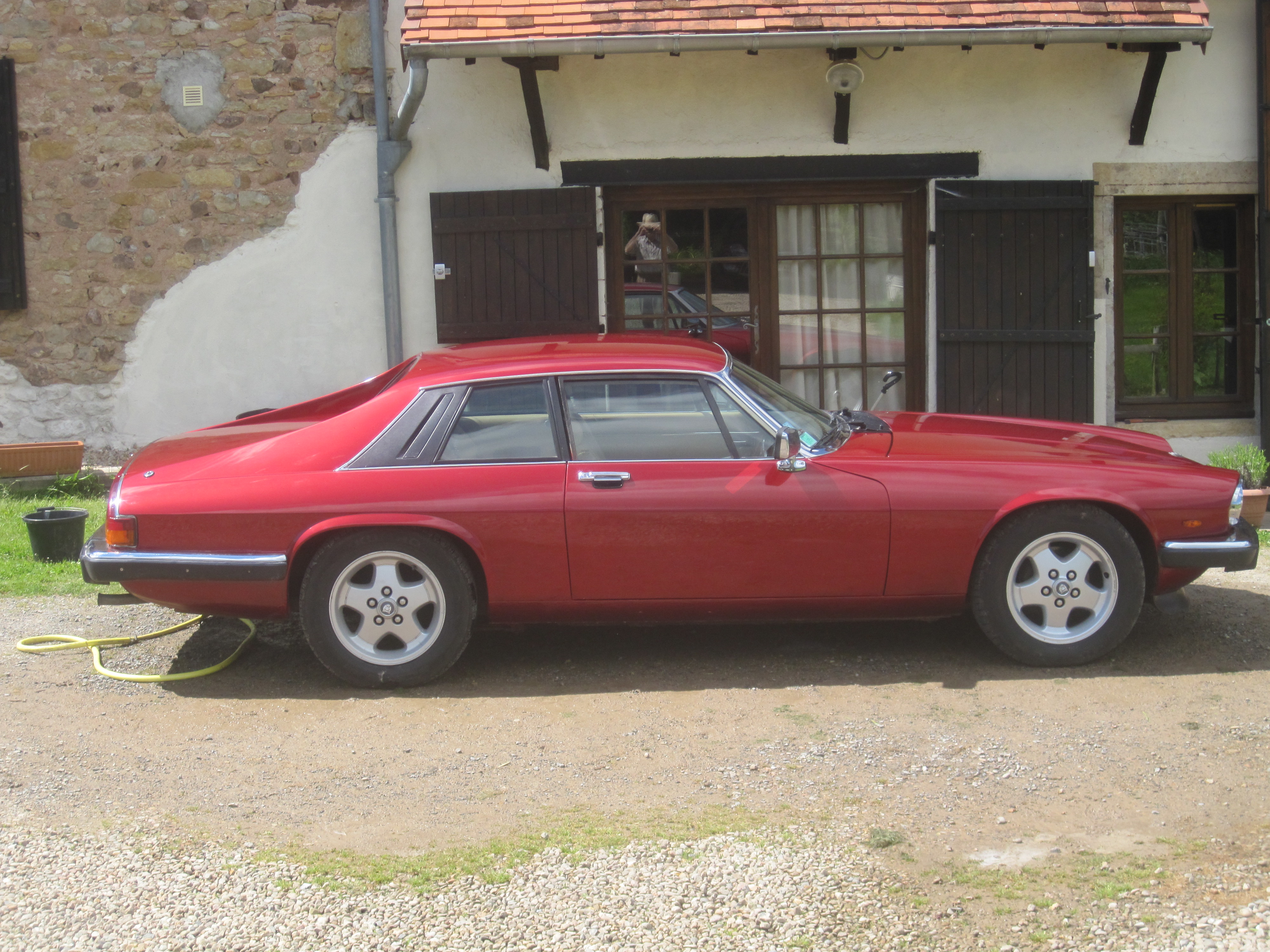

Originally Posted by Forcedair1
I actually don't remember ever seen a pre-face lift XJS with the Five Spoke wheels on it, even when I've seen all kinds of wheels on pictures of pre-face lift cars. I have even seen several pre-face lift cars with the Revolver wheels, yet not seen one with the 5-Spoke ones. Hmm, now I'm curious
They look fantastic on a pre-facelift, depending upon the colour. Mind you, I am biased...
Greg
Attached Thumbnails Speedo Reading with 16 inch Wheels-2013-painted-last.jpg
