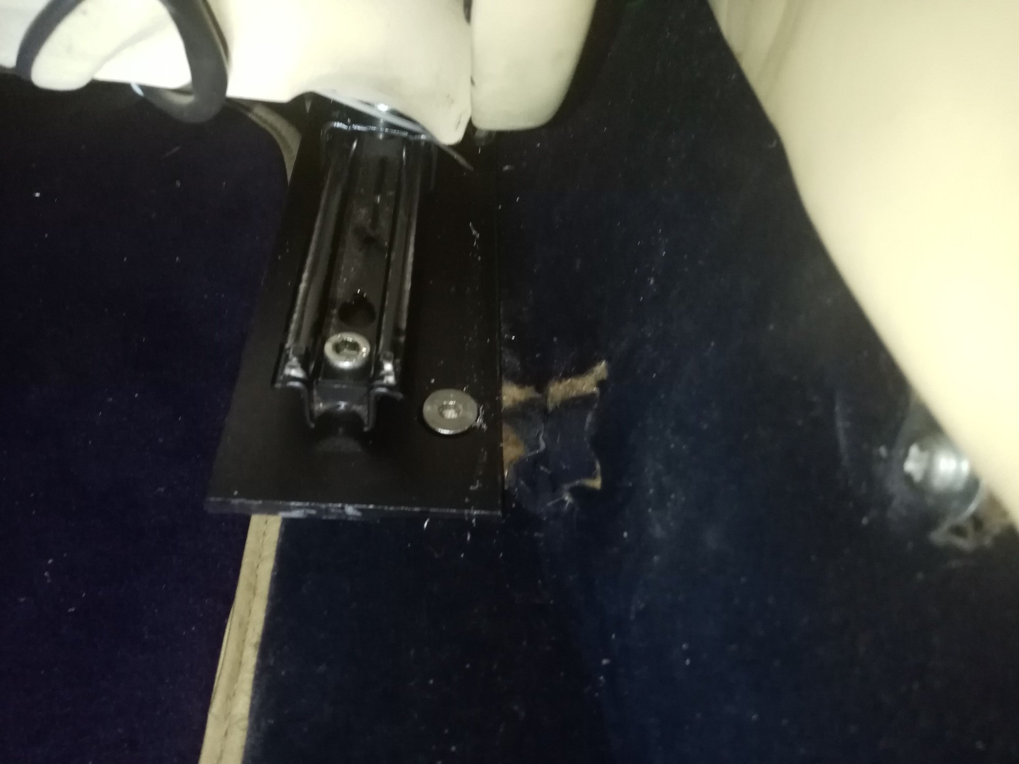

Sportspack seat mounting points don't line up on older cars so plates (2) need the be made up to adjust the position of the factory mounts
I had to change the seat belt stalk on the passengers seat
But there was absolutely no way to do this without removing the seat as the stalk actually squeezed up on the centre console. So I changed the conversion plate from one on each side to just one on the center seat mounts. Plenty of room now. But maybe too tight on the handbrake to do the drivers side.
Now I know it works I will get a narrower contoured one made up
