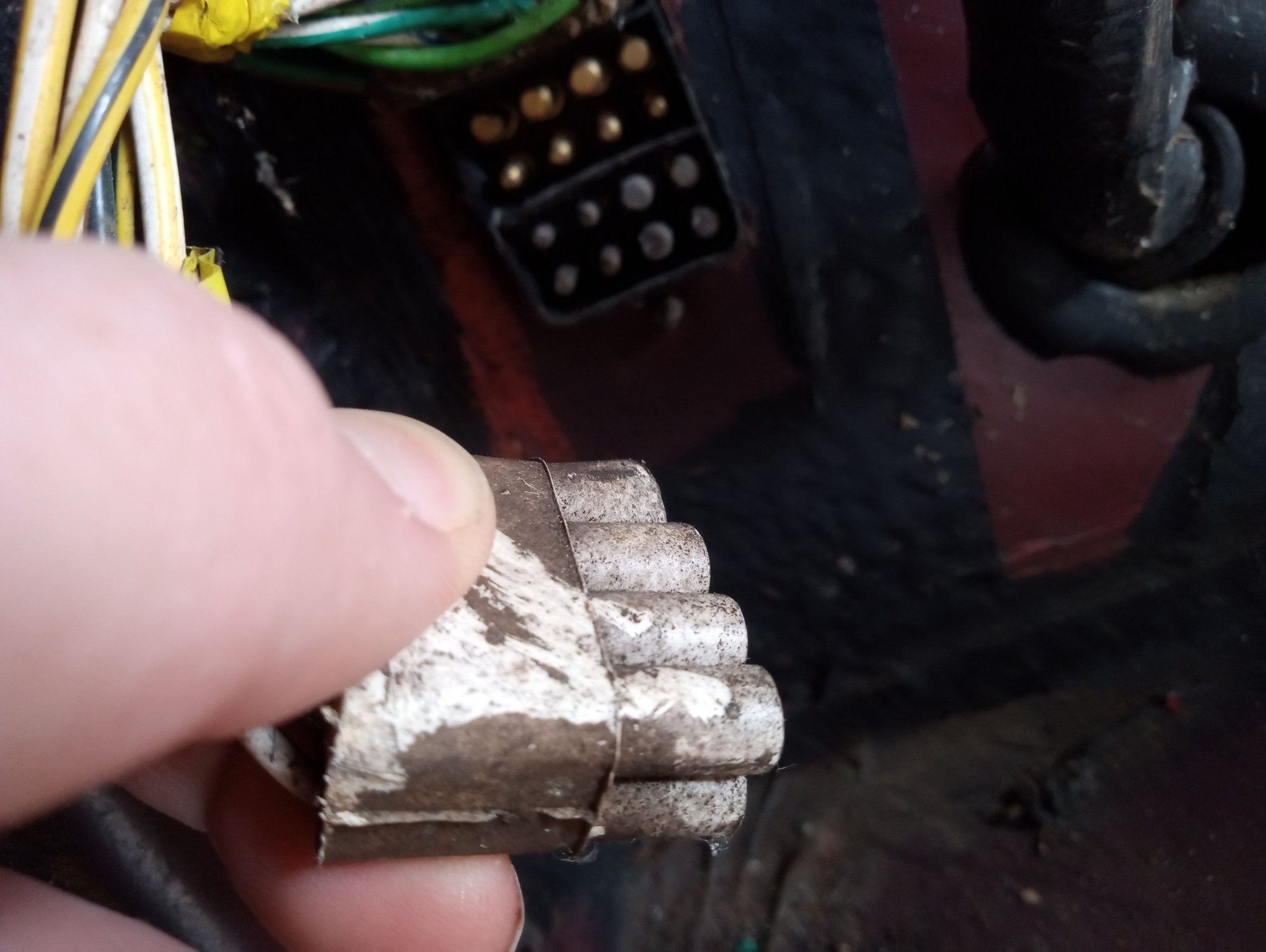

This may have something to do it my starting issues. Can't tell in this photo but it's a mangled plug on the passenger side under the front fender. There are three slots, the top one is fine, the second one is this one, and there's a third one that's unused it looks.
