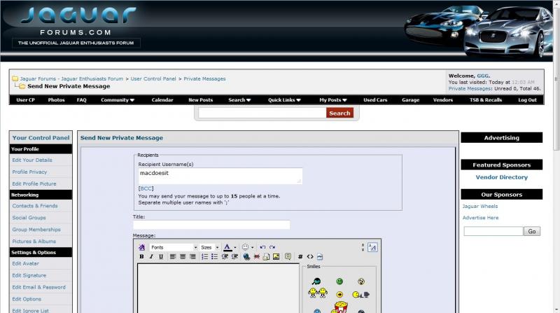

1. you can't delete your own thread but any of the Mod team can delete it for you
2. to send a Private Message, click on the member's name in any of their posts. A dialogue box opens:
3. select "send private message to...." (arrowed in red) and the following opens:
Note the recipient's name is already there. Enter the message text and press Submit message button at the bottom.
