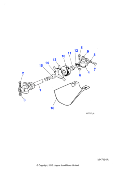

Looking at the drawing in my XJS parts catalog I am not sure where the steering wheel slippage can happen.
It must be 20 years ago that I last stripped a column.
Anybody had this problem before ?
It would be handy to know before I pull the steering wheel and dive in.

My first thought is steering rack bushings falling apart. Common failure.
After that is the lower column with that oddball knuckle joint/u-joint. There is some history of this joint failing.
CAC27653 - Jaguar Steering column
I can't imagine what could wrong inside the column.
Maybe the steering wheel just came loose? Not likely, but.....
