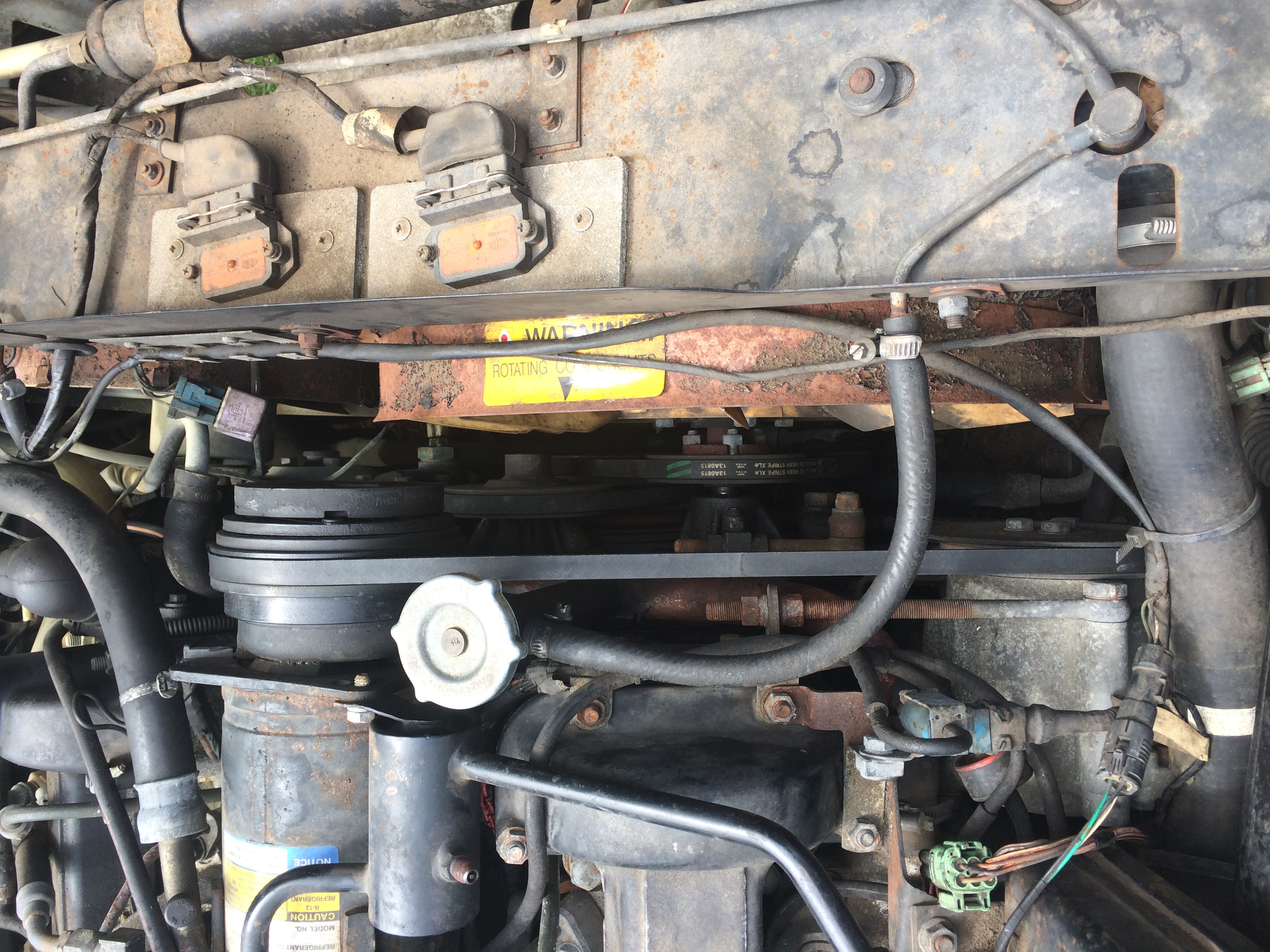

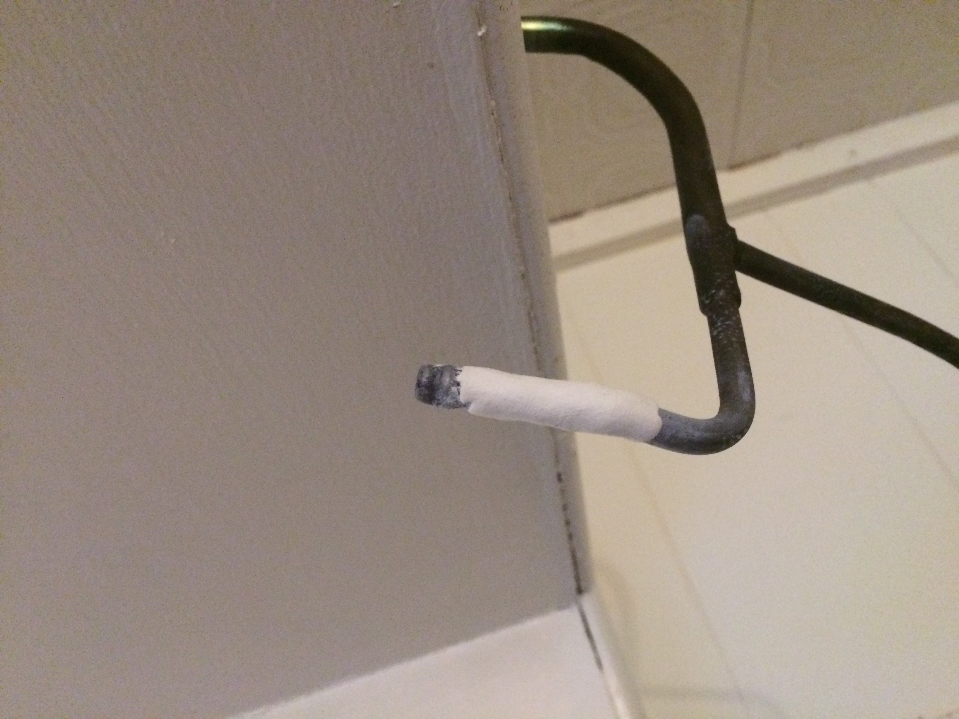

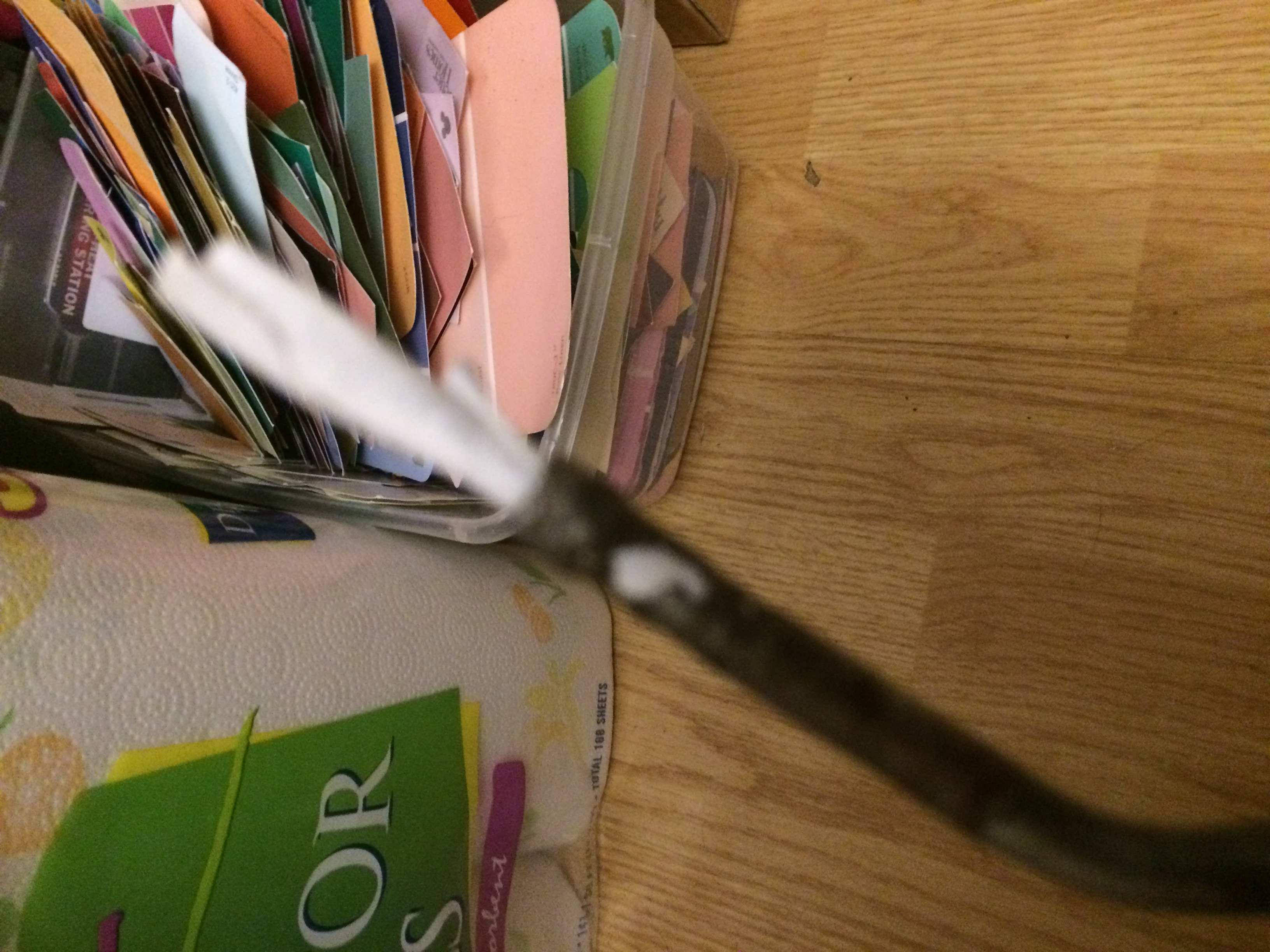

in the first picture you will notice a lot of rust... ? and the pipe going to the banjo bolt a little discolored at the rubber hose joint...
upon removing all that to scrape and paint I found that the ends of the piping for the top of the radiator were Swiss cheesed with holes just under the rubber on the free side of the hose clamp letting coolant steam and air go either way... steam out, air in... all three ends of the pipe were damaged in this manner... along with 3 pin holes in the top radiator tube... ( only found with judicious filling of the radiator and driving it to temp...) said problems have been resolved... but I found the pin holes in the radiator, not the holes in the pipe until I took everything apart... High temp water proof epoxy paste to repair pipes... so far so good... that epoxy is good for all sorts of high pressure High temp applications...

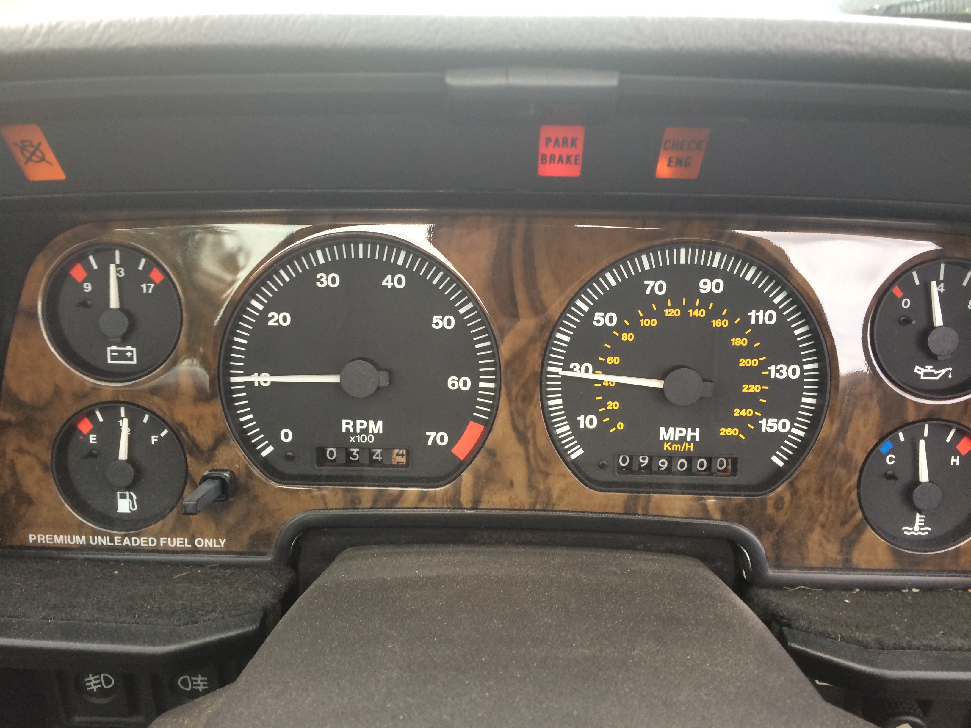

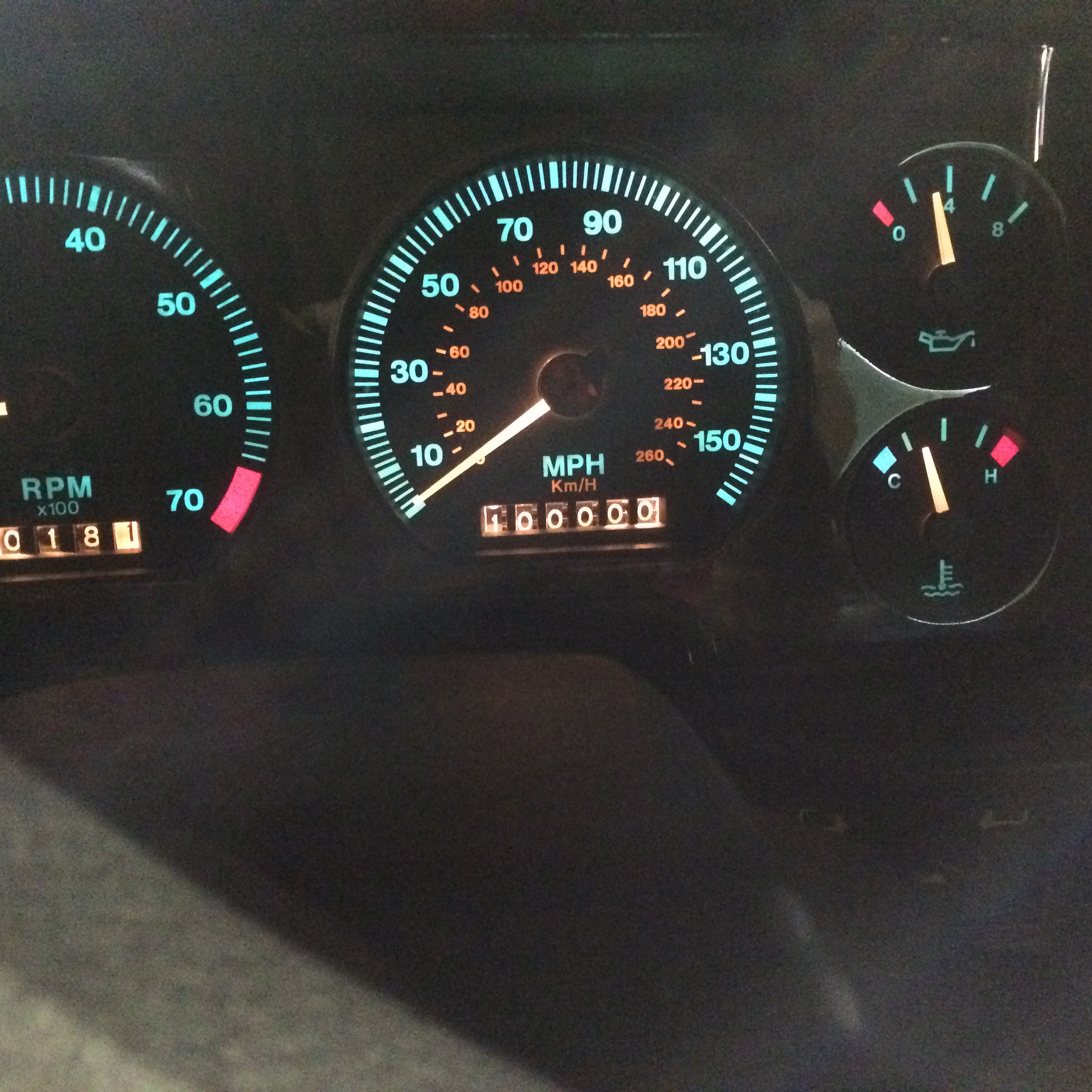

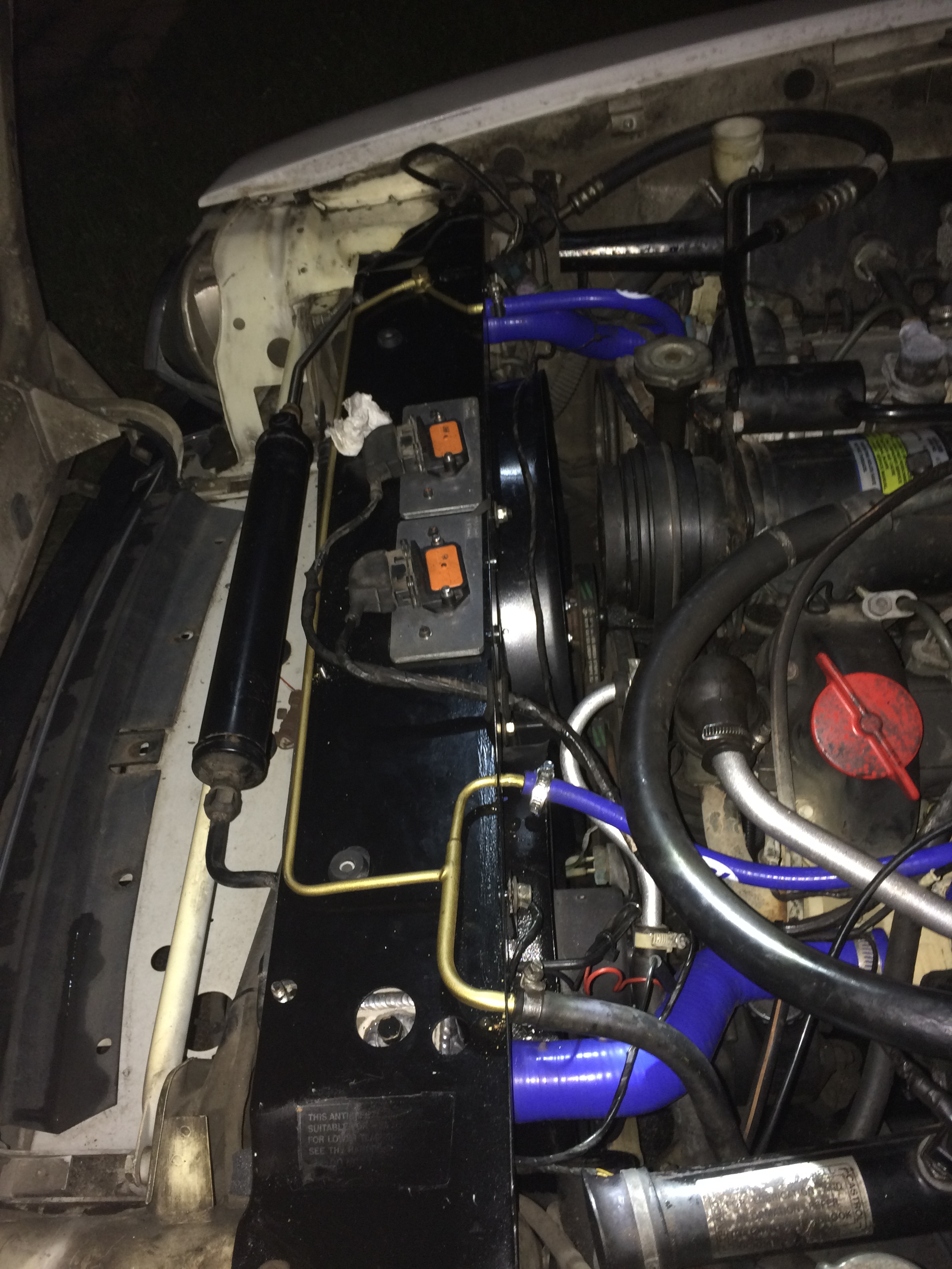

How she ran before... (filled her before every trip) (about 1.5 gallons /8 miles trip) and
the repairs new radiator fixed pipes...
How she ran after filled once burped and here we are...
