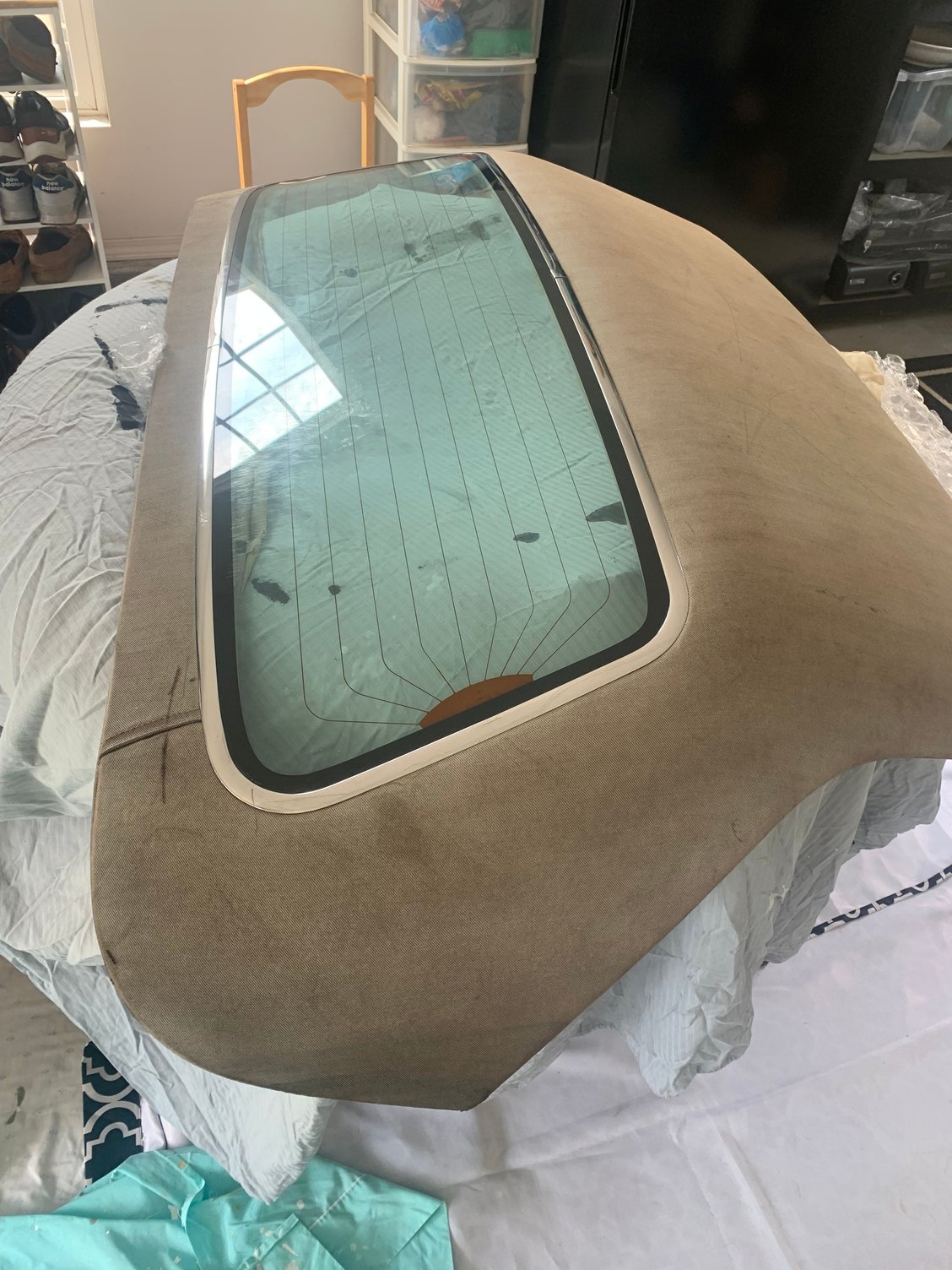

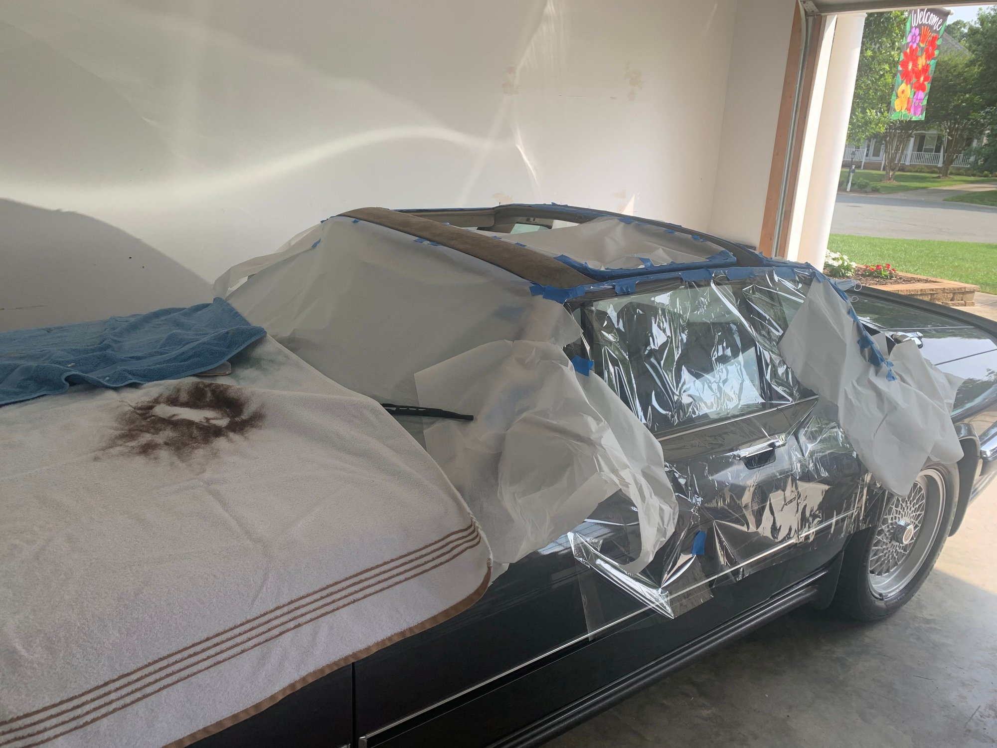

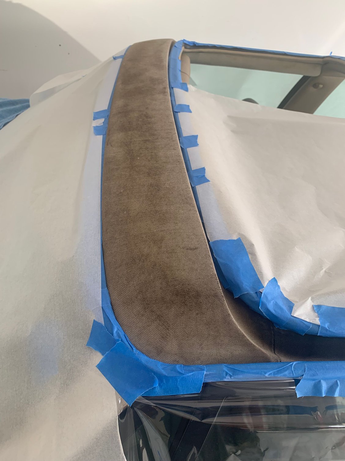

I used Leatherique and was really impressed.
