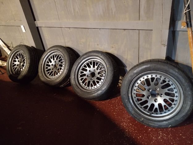

CCW Twisted Classic in Gunmetal Gloss finish. 17x8.
They have custom offsets (fronts are 20mm, rears are 28mm) in accordance with the build done here: Rim and Tire upgrade Decision
I basically stole and copied his setup for rims and tires. Hoping everything else clears well once we get everything put back together. As everyone knows, these cars are such individual machines that it wouldn't surprise me to have to fiddle a bit with things, especially rear ride height.

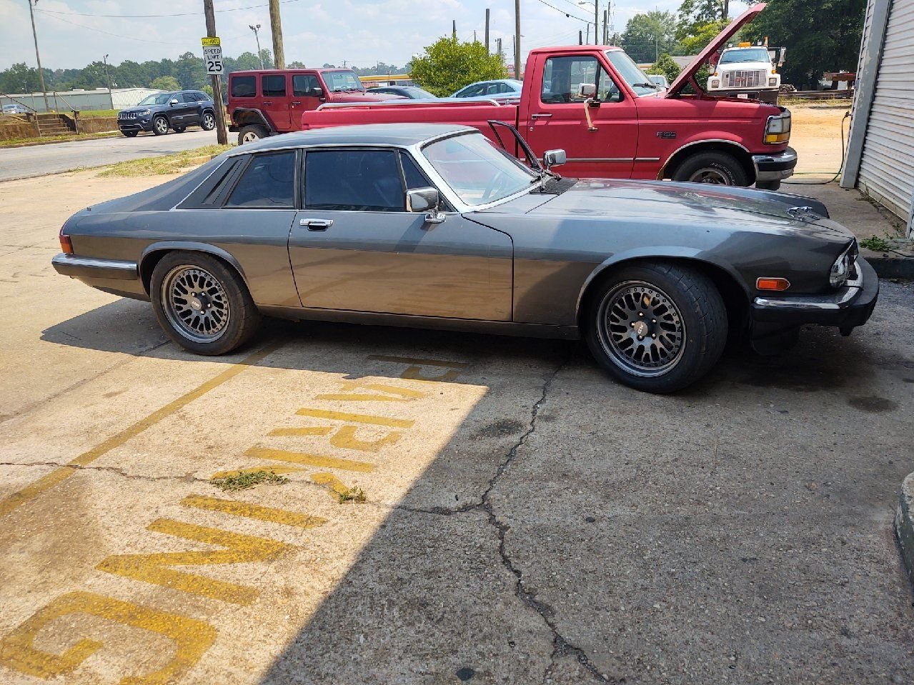

Here's me picking it up today. I wanted a shot of the car with the new rims. Trying to decide whether the wrap the car in 3M Black Rose, or keep it this color.

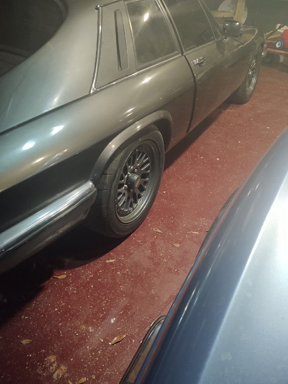

Another wheel shot. That's my '87 XJ6 (wrapped in 3M Ice Blue) that I'm leaning on to shoot this. The two cats seemed to enjoy having each other for company for the first time in over a year.
Last shot of the wheels. I'm very happy with the stance this car has now. Those wheels really did the lines of the car justice.

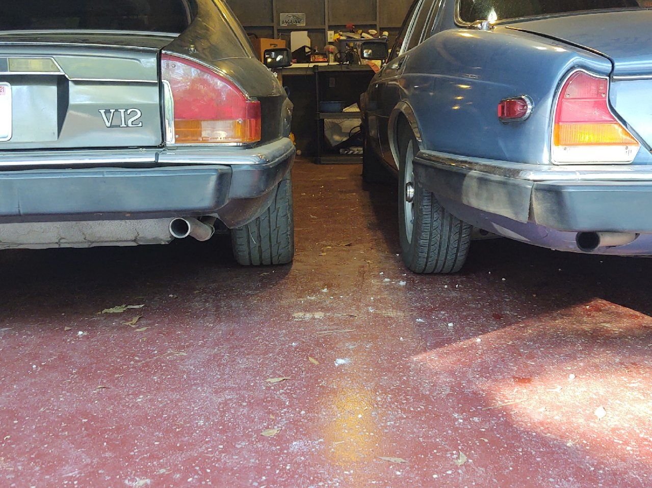

If you want to see factory Jag wheel width (XJ6, on the right) compared with what an eight-inch wheel looks like (XJS, on the left), here you go. Much more aggressive.
I tend not to think about the XJS as having such a sports "stance" until I see it next to one of the sedans, and especially with those wider wheels.
