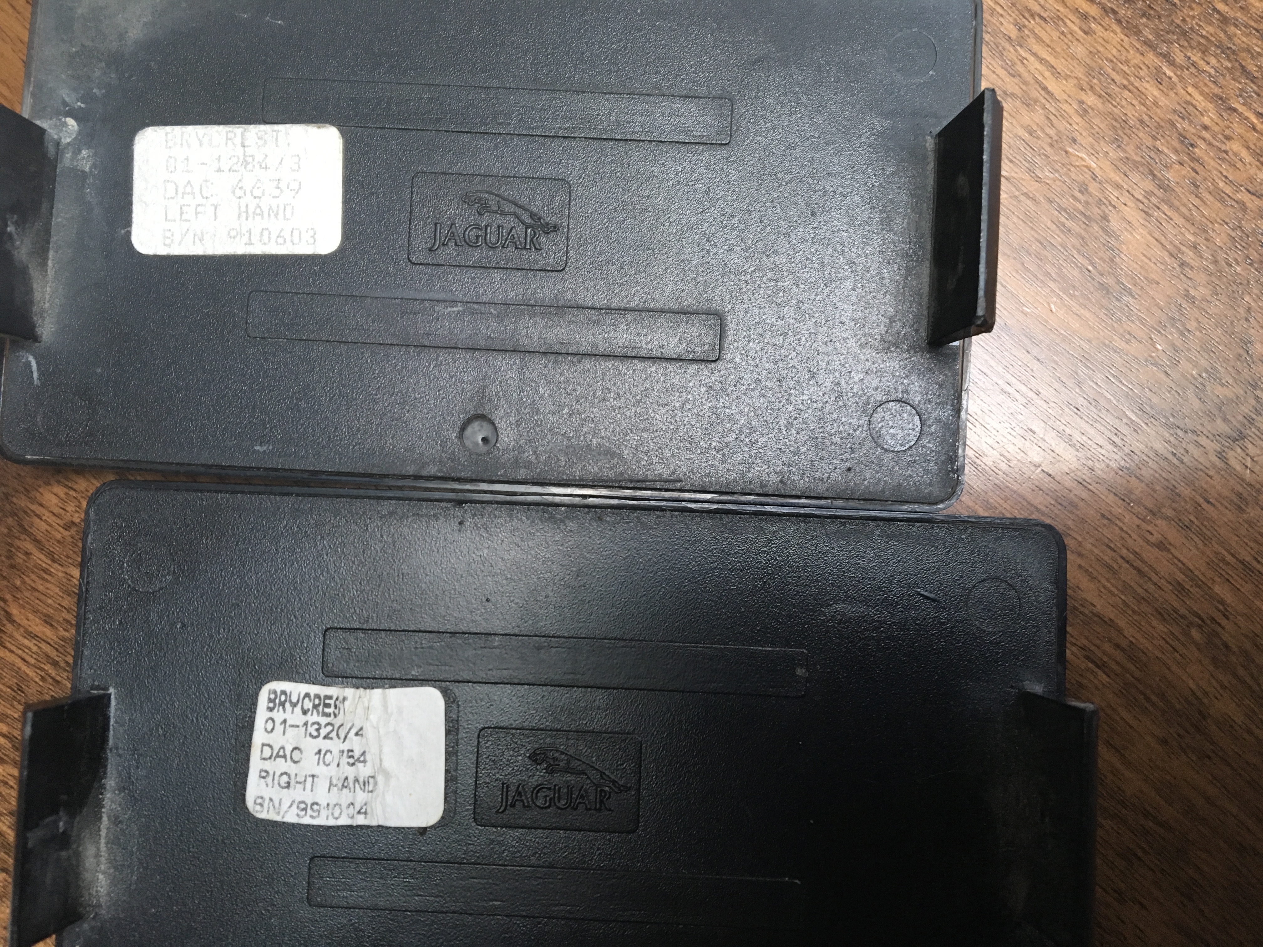

And replying to my own post, and can advise that mine is not a faded red one on the left side ! I pulled them both off very easily, and although they both have the same numbers visible, when viewed on the car, on the inside/backside they each have unique DAC numbers on the Brycrest labels:-
Right hand is DAC10754 and Left hand is DAC6639.
So, one is clear (offside) and the other is red.

Yes I did see that link (and many others) most with quite high prices for simple reflectors ! But see the attached photo of my two reflectors clearly showing left and right etc etc. !
