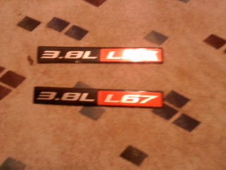

And now you need to scrape off those V12 emblems.
Or modify them like:
V12
Old Aug 26, 2012 | 09:01 PM
M90power's Avatar
Joined: Oct 2011
Posts: 1,738
Likes: 70
From: WV

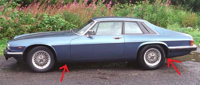

worst places for rust are the front footwells underneath the car, and the rear panel where the fender directly behind the rear wheel.
