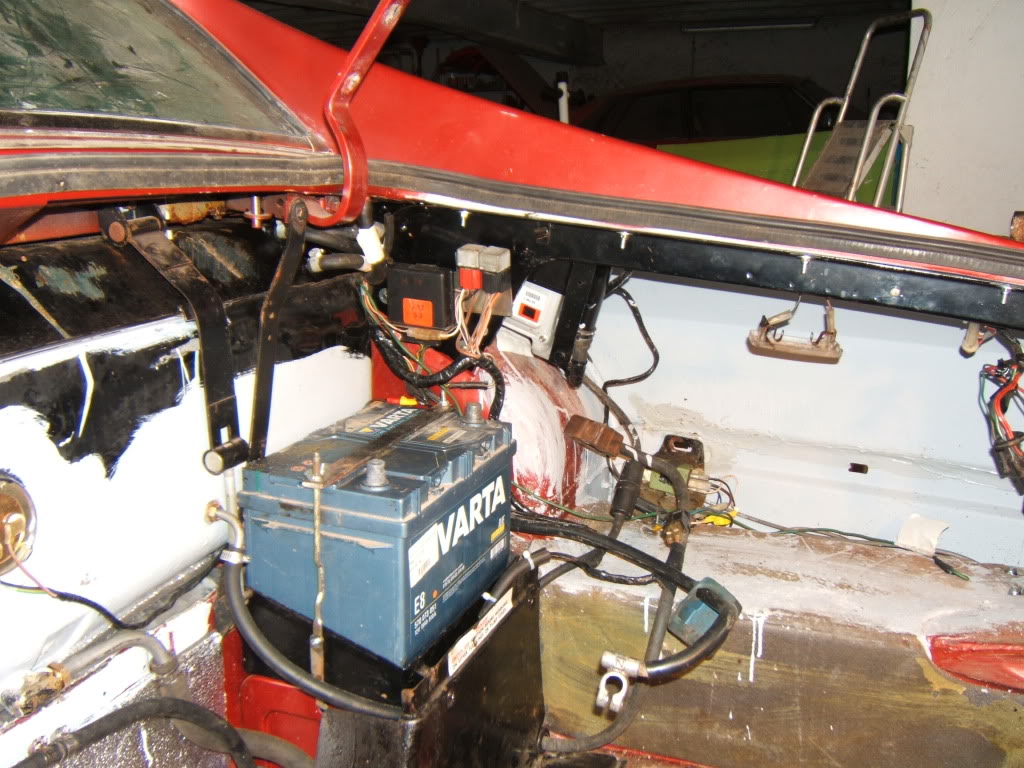

Thanks Darel. It is on the RHS of the boot, behind the plastic cover attached to the carpet that is just below and to the right of the RHS hinge.
pic here
I had always thought it was something to do with the injection system! Just shows what you do not know. Always something to learn on these cars.
Greg
