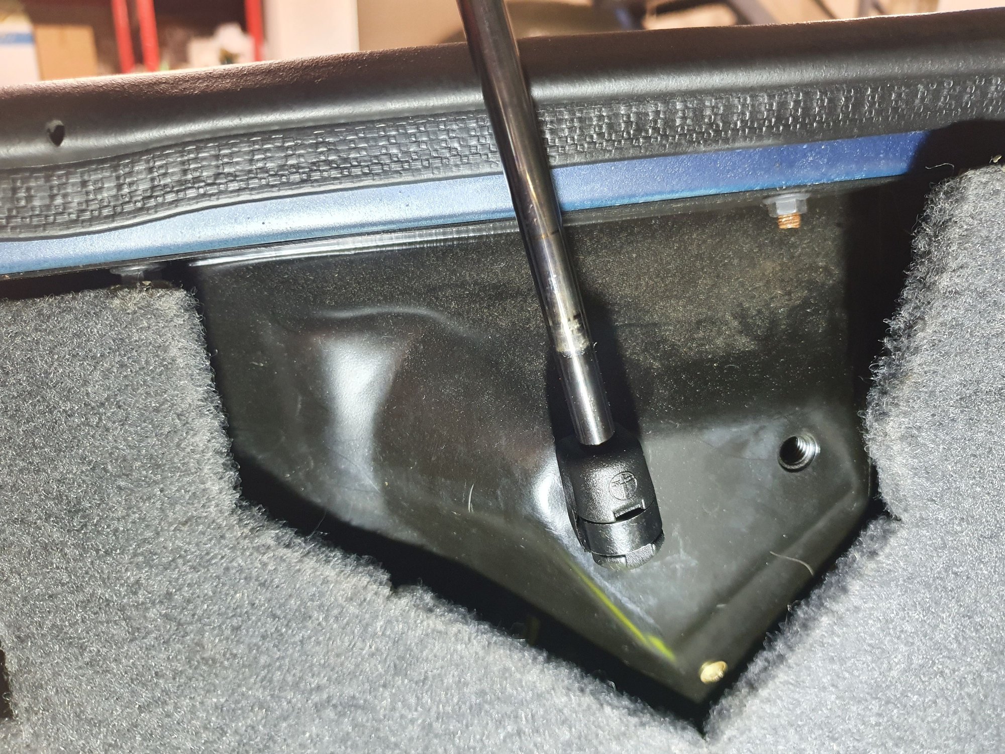

From: Kent, UK
rgp,
I don't know if the pre-facelift that you have is substantially different, but here's a pic of a facelift boot strut attachment point.
Paul

Originally Posted by ptjs1
rgp,
Paul
Thanks for that Paul
That's a bracket attached to the reinforcement pressing. Interesting.

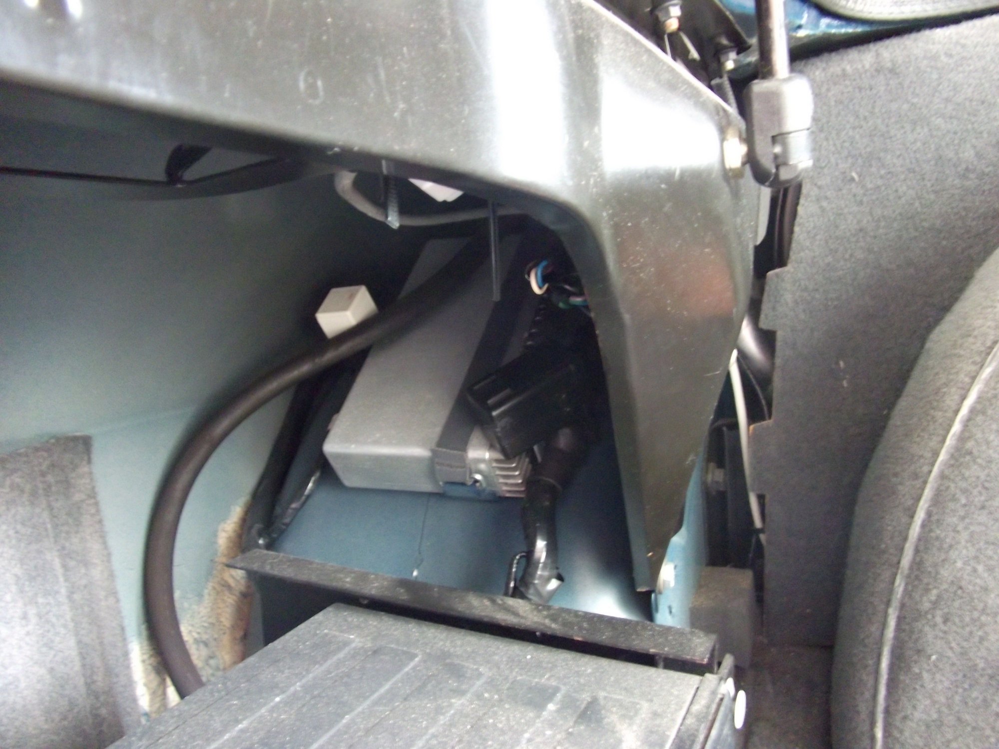

rgp,
It's an integral part of the pressing. See this pic.
Paul

Thanks Paul, most helpful.
