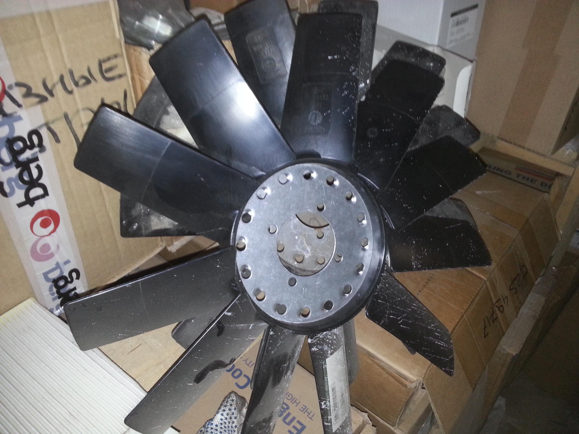

My experience with the use of twin fans.
Diffuser made ​​myself, fans of those XK8 that big. Electrical circuit and partly from XJ40 and from XK8.
And then a few problems.
During the long traffic more than one hour in hot weather fans are constantly working at high speed, then A \ C turn them on or the thermo sensor.
Charging the battery drops to 12 volts, there is almost no charge.
I now think that this is not the best solution for hot climates.
There are other ways to solve the problem of overheating.
1. Produce (need turner) reduced fan drive pulley. At one centimeter (0.4inch).
2. Put the fan, fan from older XJ40 straight-six, it is larger in size EAC9367# . Need to increase the diffuser.
3. Put electric fan from facelift XJS V12 6.0L, it is efficient. CCC5703
Attached Thumbnails twin electric fans-2014-06-09-20.52.40.jpg   twin electric fans-2014-06-09-20.53.19.jpg   twin electric fans-2014-06-09-20.54.43.jpg   twin electric fans-2014-06-09-20.53.42.jpg   twin electric fans-2014-06-09-20.54.30.jpg

increase the diffuser with larger in size fan 455mm
