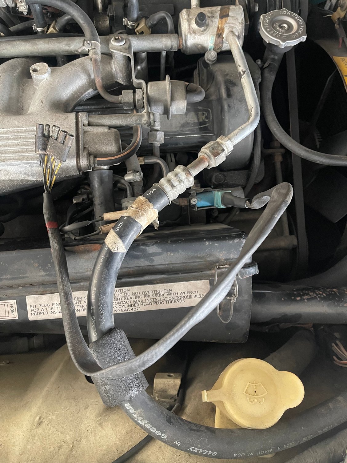

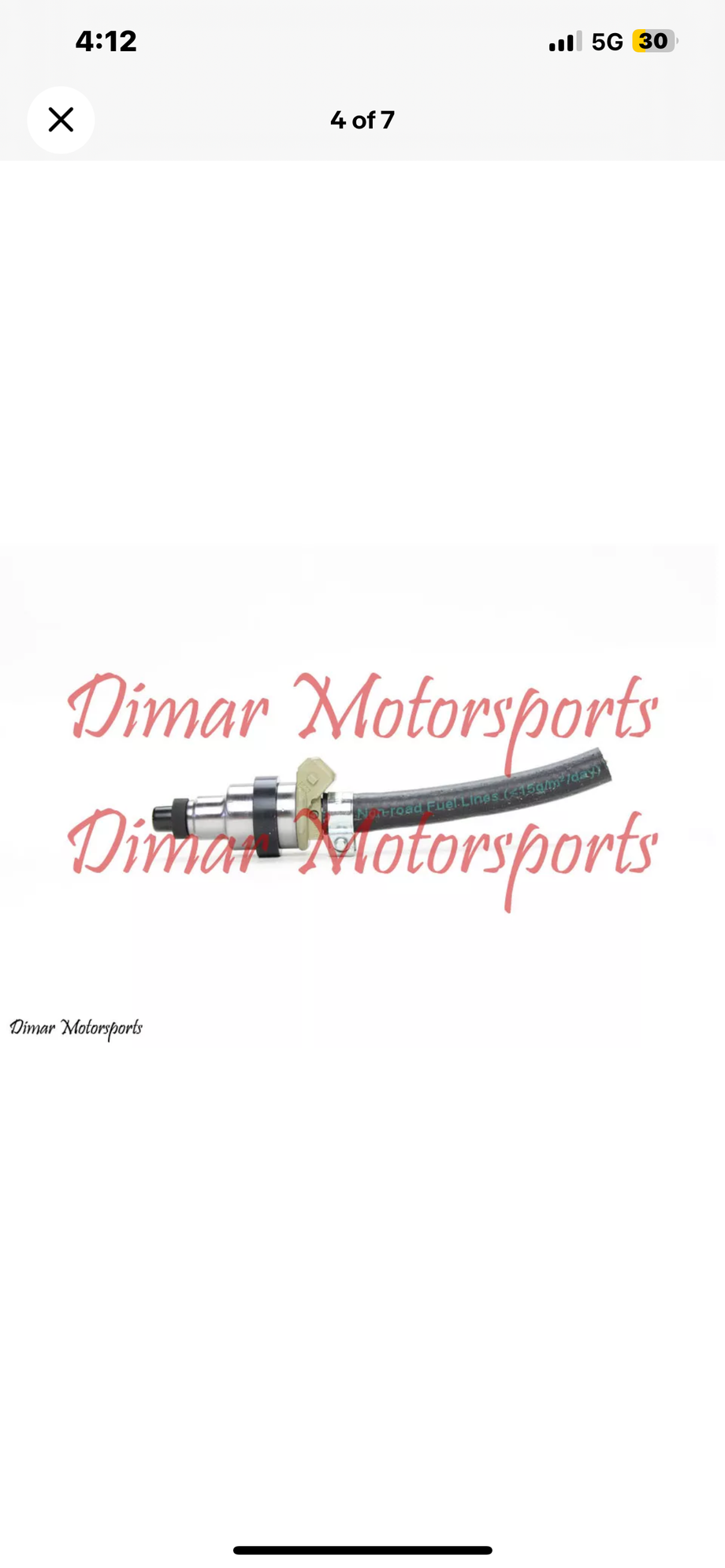

I changed the injectors and the car does not start. I found this loose cable, can you tell me where it goes? And another thing, I bought some injectors and mounted them as is, did I have to remove something?

Cruise control connections, nothing to do with fail to start.

Cruise control. I removed mine, shouldnt affect starting.

It’s the in-series fail safe for the cruise control. Blue item. No effect on starting.
