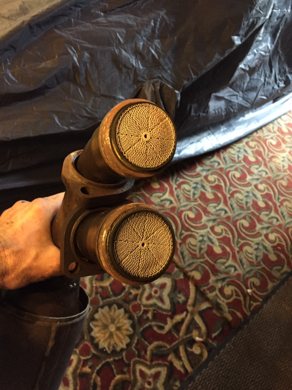

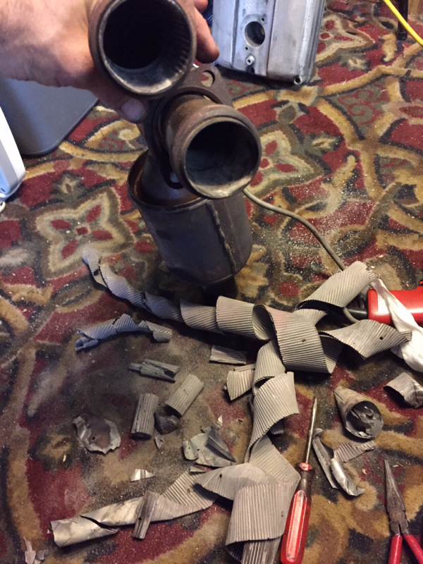

Dec 6, 2015 | 10:20 PM
My cats were already gutted a few years back. It's not tinny, it's a "pop" sporadically. The part removed is in the pix, it's above the cats at the manifold to down pipe connection.
