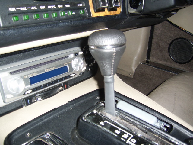

I got that sorted on mine way back in 1994.
I simply wanted to change the gearknob, so I snatched a spare "chrome bit" from a wreckers. Might have been a S2 6cyl, dunno, I basically looked at it as I usually do.
"If it quacks like a duck, and looks like a duck, its probably a duck"
I cut the top off, welded a bolt in place and then fitted that chrome bit into the XJS mechanism.
Only then did I realise the shifting from D to P was a simple one slide movement. OOPS, but I liked it, as the Doug notchy really was driving me nuts. I then went the other way from D, and that was also a single movement.
WHAT HAVE I DONE.
NO bloody idea, and all I could think of back then was that the "new" chrome had a pin missing???. and that is all I can think of. I did not (as best I remember) touch the notched plate.

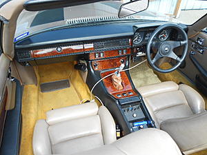

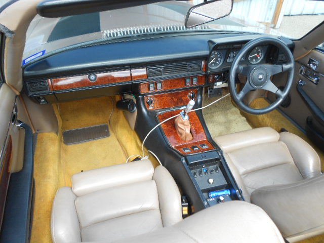

pic of my B&M shift lever with home made handle!
so far 23yrs and still works fine, (Park/Reverse lockout pull handle /neutral/ Drive 4th OD, 3rd direct, 2nd gear, 1st gear.)
700R4 with B&M shift kit, can hold it in any gear you chose!
Attached Thumbnails Un-Jaguar-like gearshift-jag-interior-001.jpg   Un-Jaguar-like gearshift-dscn8780.jpg
I see. B&M shifter disguised with a shift boot. Clever !
