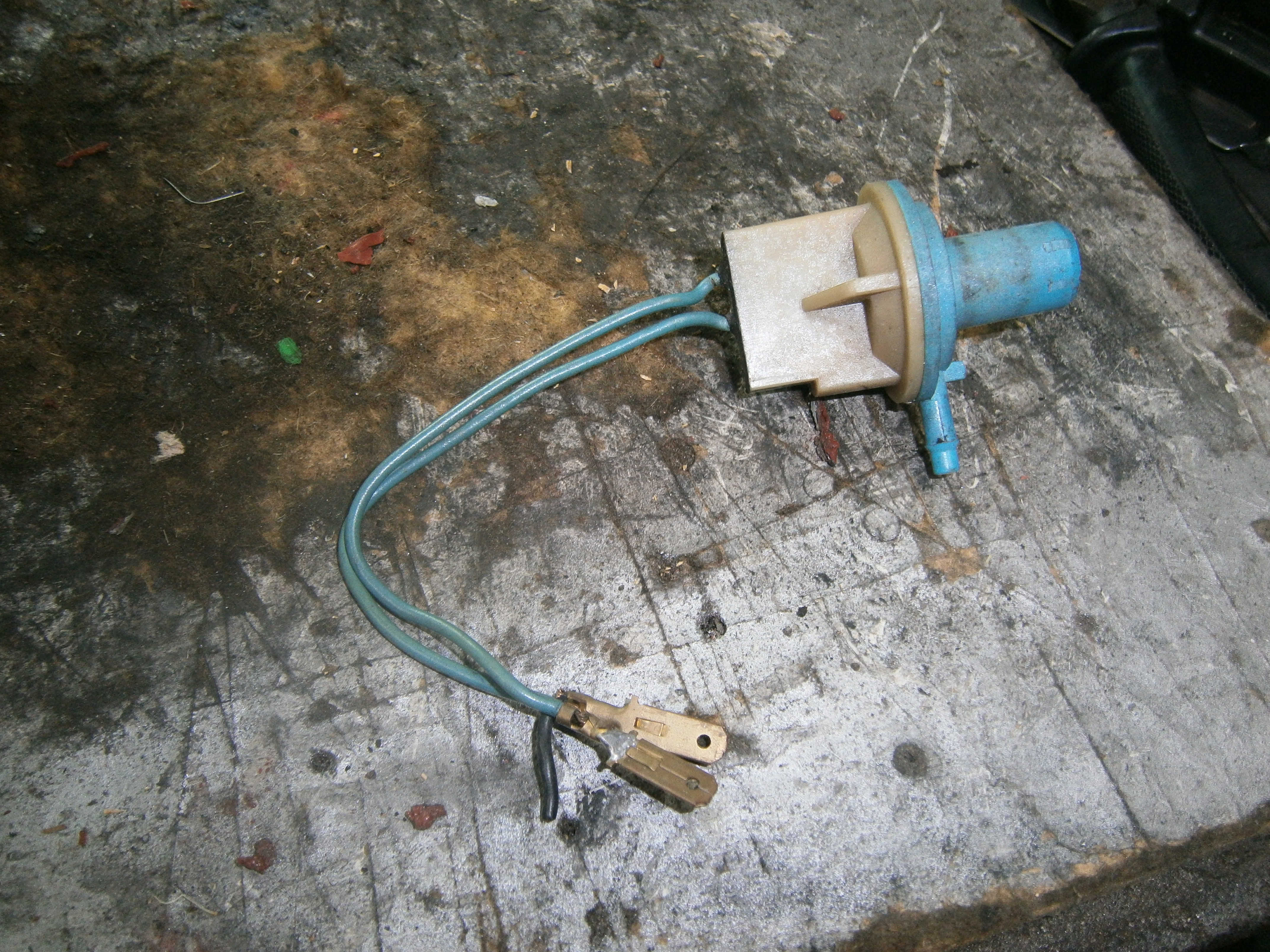

I'm sure Grant won't mind if I paraphrase what he has me on next:
He is thinking between the CTS and TPS as well as the Full Load Throttle Vaccum switch as places to look. Seeing how you said you replaced your CTS looks like the latter two might be good for you to check.
On the Full Load Throttle switch grant says:
this valve has 2 wires connected in conjunction with the micro switch on the throttle capstan, and 1 vac hose attached to the RH inlet manifold. It uses engine vaccum to HOLD the contacts OPEN, and thus allowing the ECU to drop into idle fuel map. As vac drops, as when you accelerate, the contacts close, the ECU richens the fuel by about 15%, and a smooth increase of engine speed is achieved. If that valve fails, the contacts STAY closed, the ECU cannot/will not drop into the idle mode. The engine overfuels slightly, and bogs down.
As for the TPS please find attached write up from Grant.
The Wizard never fails to deliver!
Picture of the Full Load Throttle Vaccum Switch:
