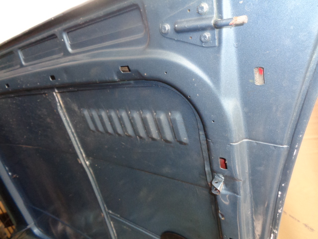

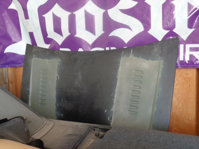

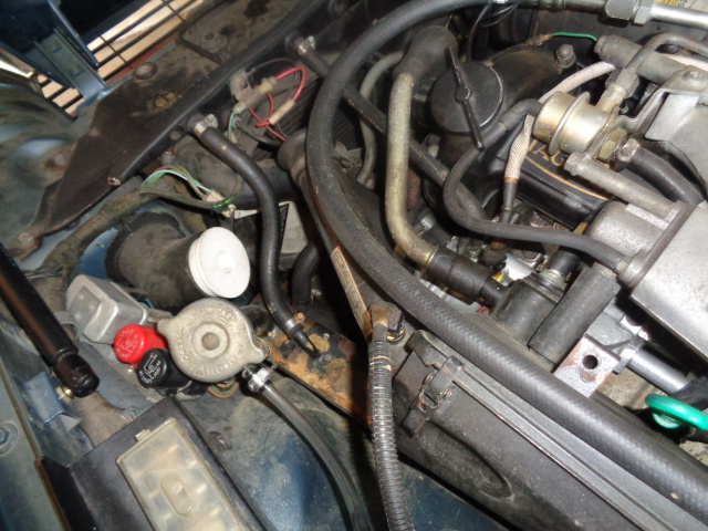

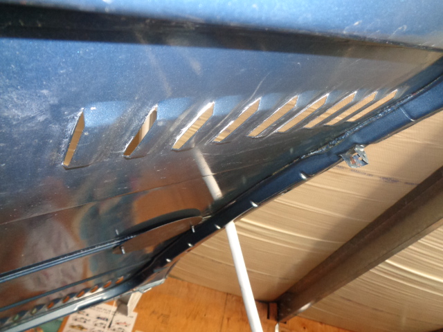

Gentlemen, I took a different approach IMHO to the under bonnet air/venting. Assumption #1..air inside engine bay is under pressure from fan and forward motion of machine with all lower valence and sealed radiator surround.
#2...cold air induction enhanced with tubes and modified intake horns "ala Bernie Emden", removal of front seal strip to bonnet and bonnet liner to encourage additional air flow into and back to the firewall.
#3 removal of hood latch ala "the Grant of Frances"..installation of gas struts Honda hatch back...1/4-3/8" longer allowing deployment of hood at arrested stance.(very dramatic when you pull in and stop at the local ????)
#4 installation of reversed/upside down vent louvres at back 1/3 of the bonnet...idea was that air pressure would be able to vent vertically as well as back and down around the Trans./ground sytem as originally designed. The AC bracket at the front was skeletonized along with the throttle pedastle.
#5 as you guys know I am a big proponent of the Lutz Cooling System Mod. Stage1 for street machines along with the t-stat seal inside the castings.
Have yet to do an in depth empirical study, but hope it is making a difference at idle (can feel heat exiting vents at still)
Will try to add photos of the venting and engine bay for your perusal, best, JW
